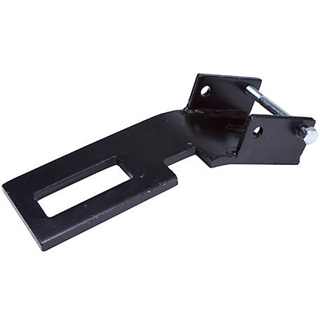

These drawbar locks are a must. I've used this type of drawbar over they years and these little clamps solve lots of unsolvable problems before they occur, especially if working in the woods. Plus, there's a little fab time in making one. There's a store-bought one out there for maybe $20 but it doesn't work correctly and doesn't last very long. Make the one in the picture.
Quality Farm Supply, Agrisupply, Tractor Supply and others have these "drawbar locks" for around $21. Maybe what sixdogs is referring to.
I've had one for 25 years. Haven't looked at the ones available today, but mine is quite sturdy. For more strength you can always use two, one for each link arm.

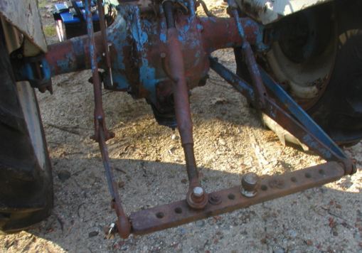

You guys are reinventing the wheel with your top link stabilizers. Adjustable bars have been available for generations to keep the drawbar from raising; I have a set out in my shed, which came with my 8N.
We had the slotted adjustable flat iron stabilizers on our early 1950's 8N. The problem was they were only good in tension. They would easily bend if someone accidentally raised the 3PH.

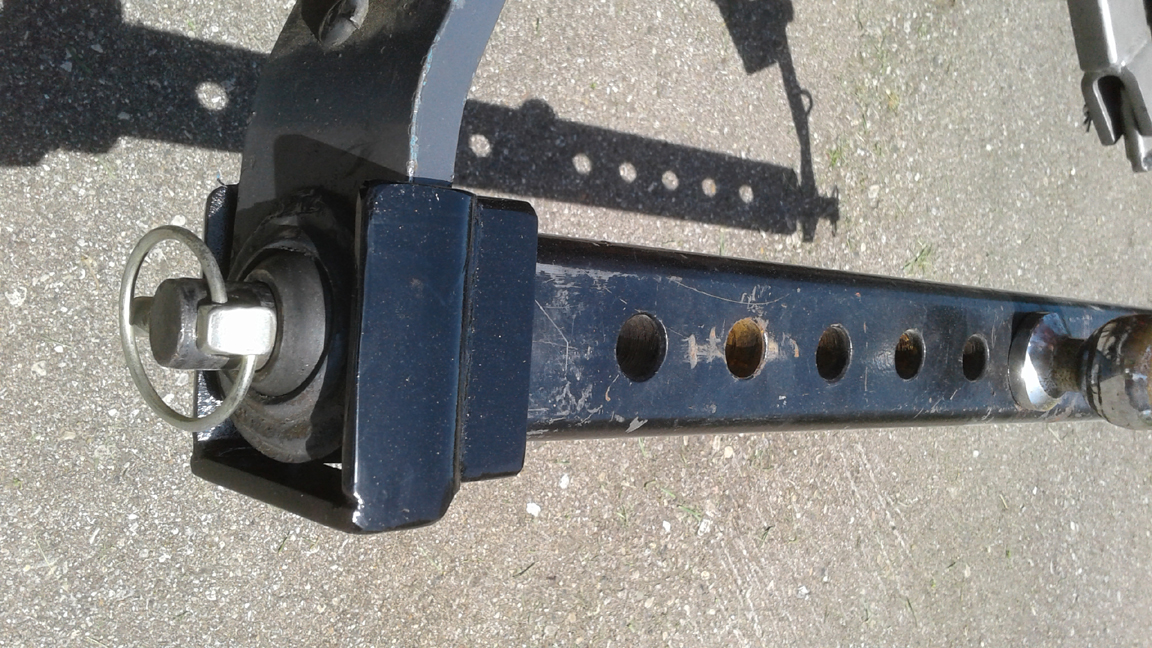

I DIY'ed this,, you could convert yours to a ball,, then the problem goes away,,
plus, at hookup, the tractor does everything, while you set in the seat,, except for flipping the lever after hookup,,,
If I am only on level ground, I never have to even get off when I move a trailer,
just go to the next spot unlatched,,,
I have a "store-bought" version of the same thing for moving trailers and such. Converting the splitter to work with a ball hitch would allow safer travel over uneven ground.

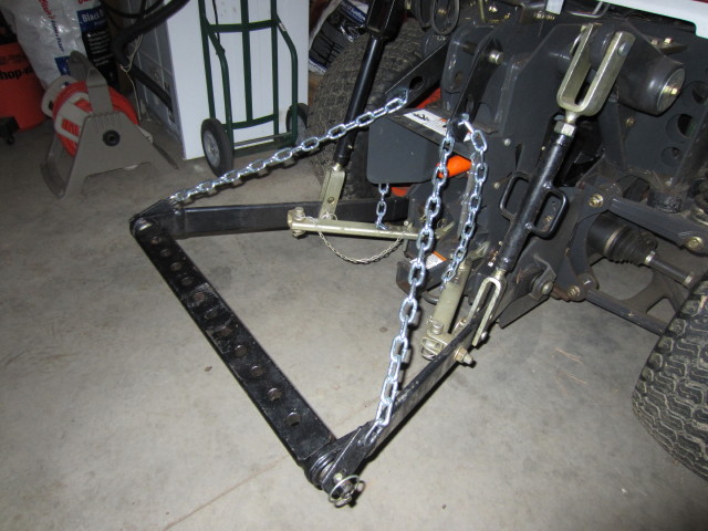

That is why many people chose to use the chain version because they won't bend if you lift the 3pt.
