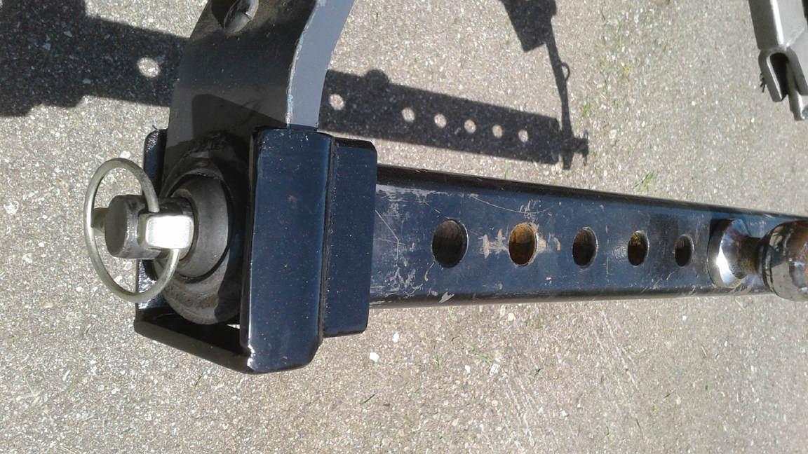

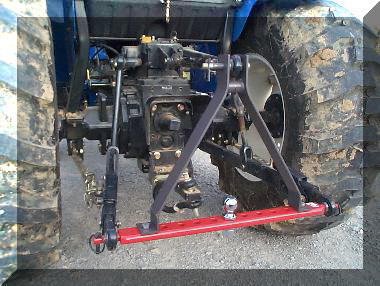

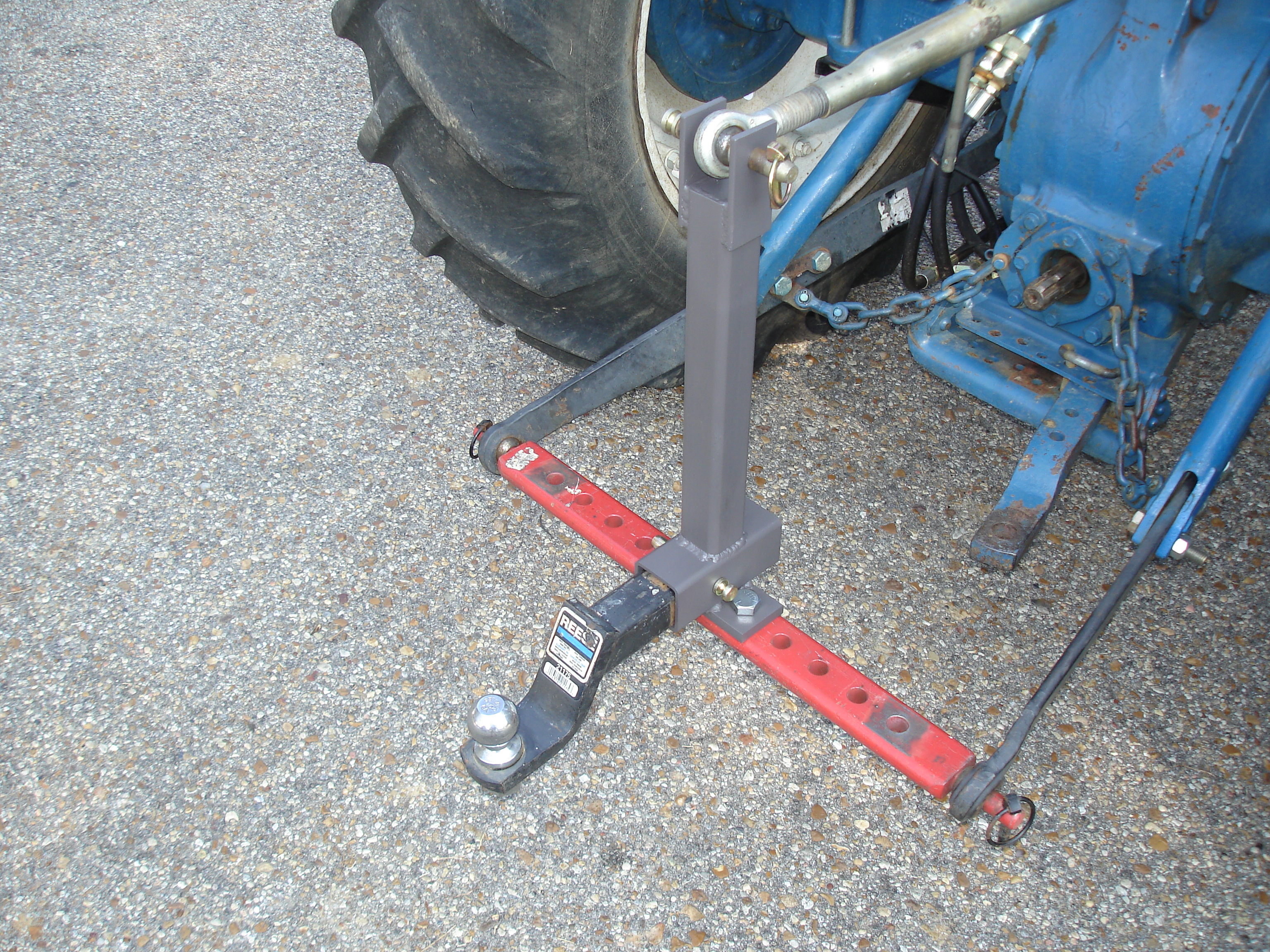

How are those locks at the lift arms?
Are they strong enough to prevent twisting if you're using a ball hitch and a heavy trailer?
I've added the brackets that prevent rotation by connection to top link as it seems more 'solid', but it does limit how tight you can turn with some trailers, especially a camper we had that had a "triangle" instead of a "tongue". They also have one with a receiver that moves the ball back further.
View attachment 629733 View attachment 629734
$55 & $75 at Funkworkz
As long as there is no slop allowing the lift arm to slide on the drawbar pin, there is no way that bar is going to rotate.
You would have to look at one from a better view to believe that they work well.

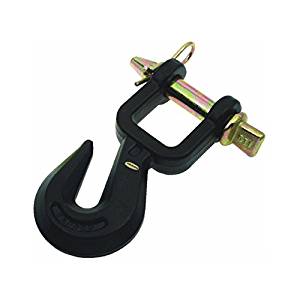

Use a shackle or a drawbar hook to attach the chain to the cross drawbar. No stabilizer needed.
