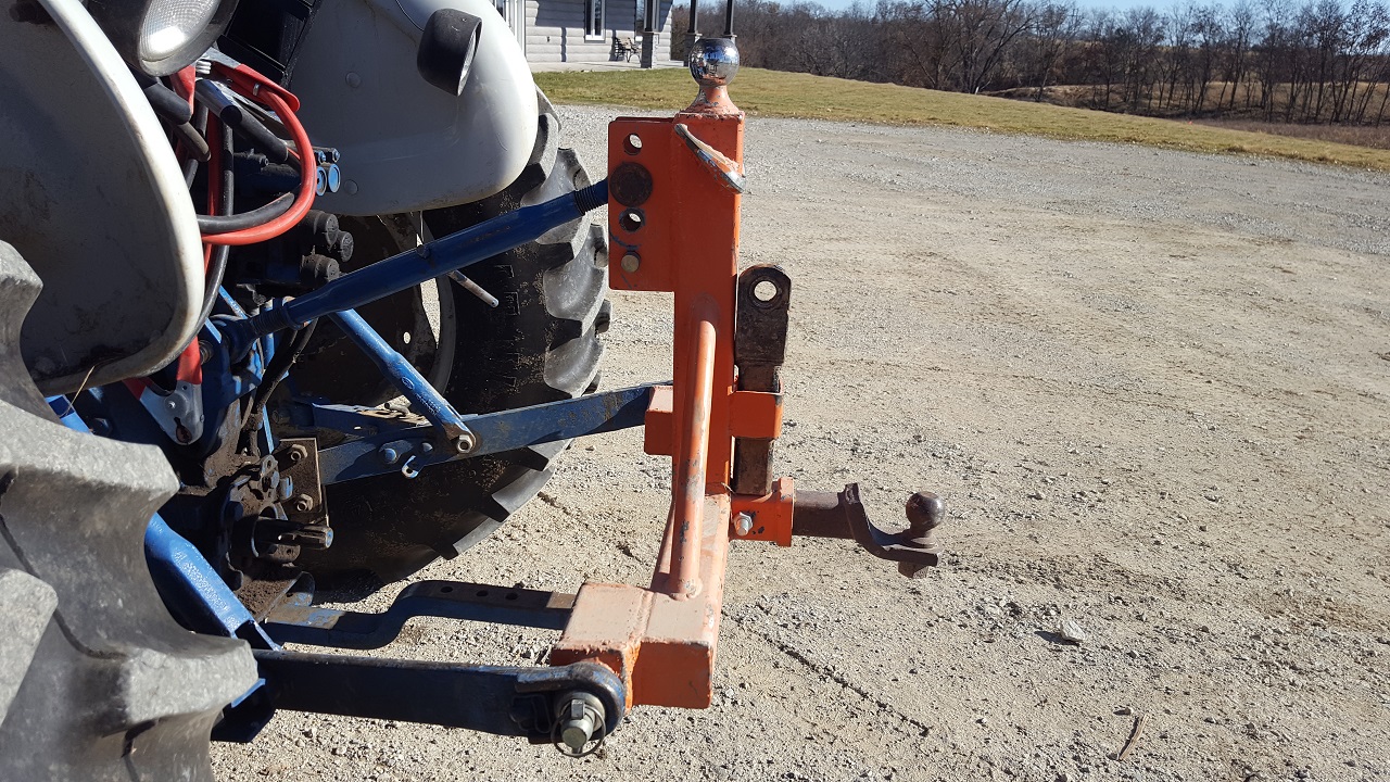

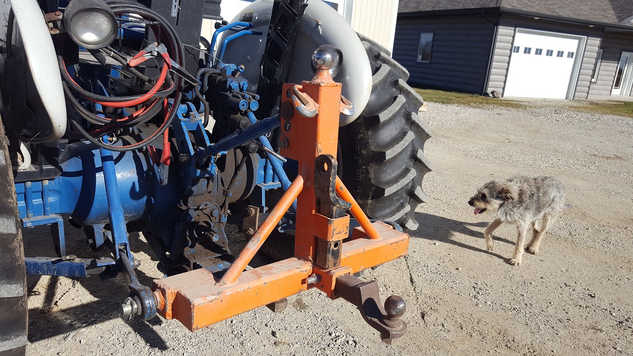

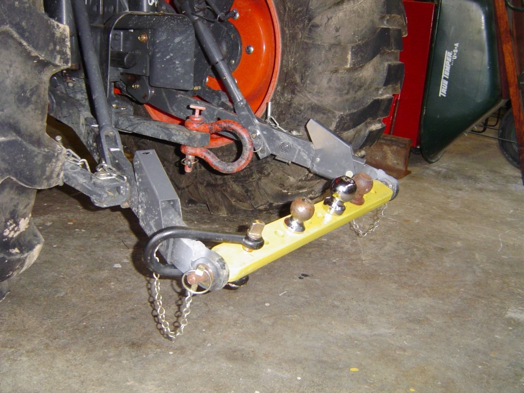

I built this "Hitch Adapter" several years ago. It also fits my Cat II QH. Very handy tool. It's always on one tractor or the other. 2 5/16" ball on top for moving my GN.

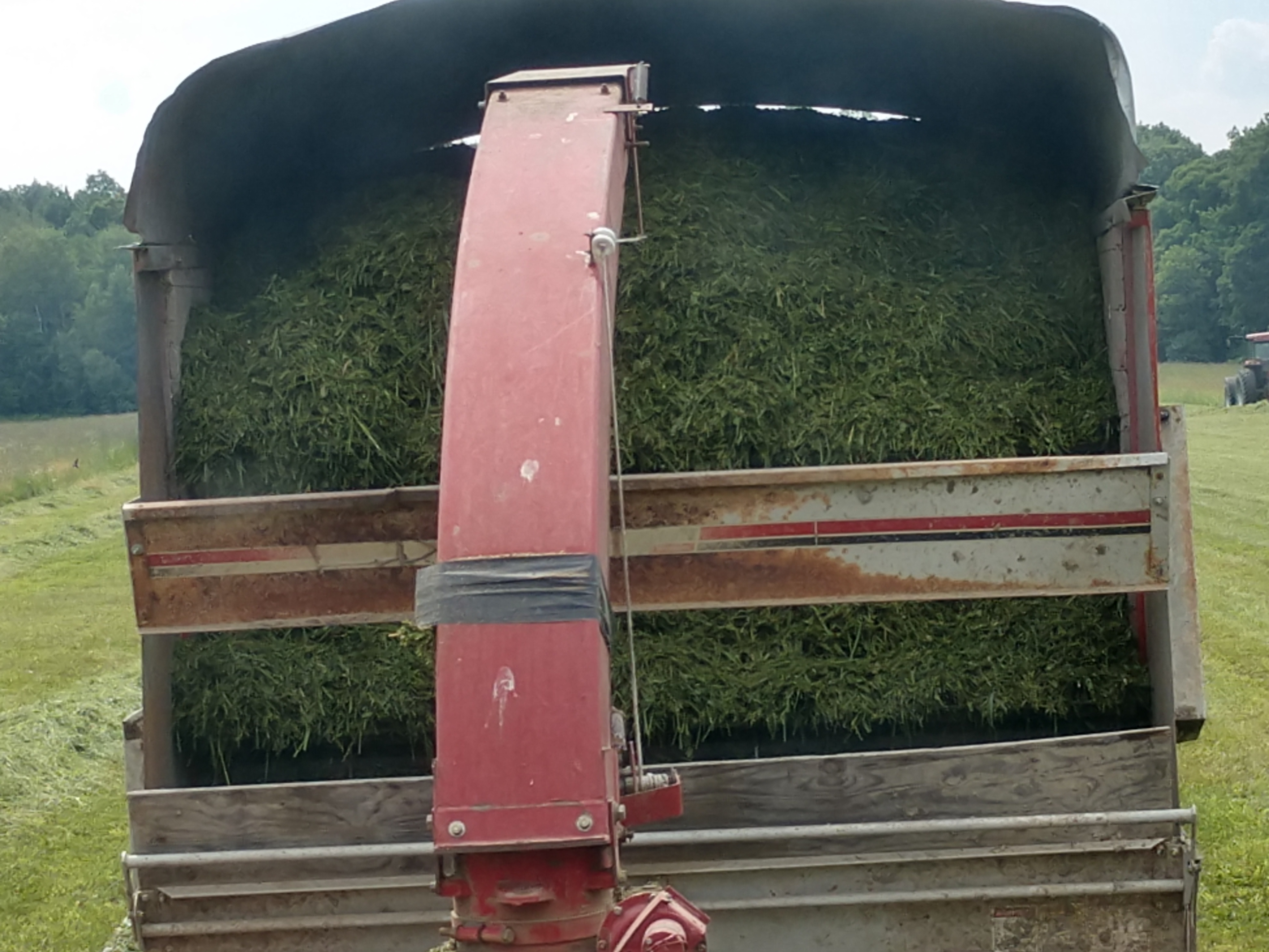

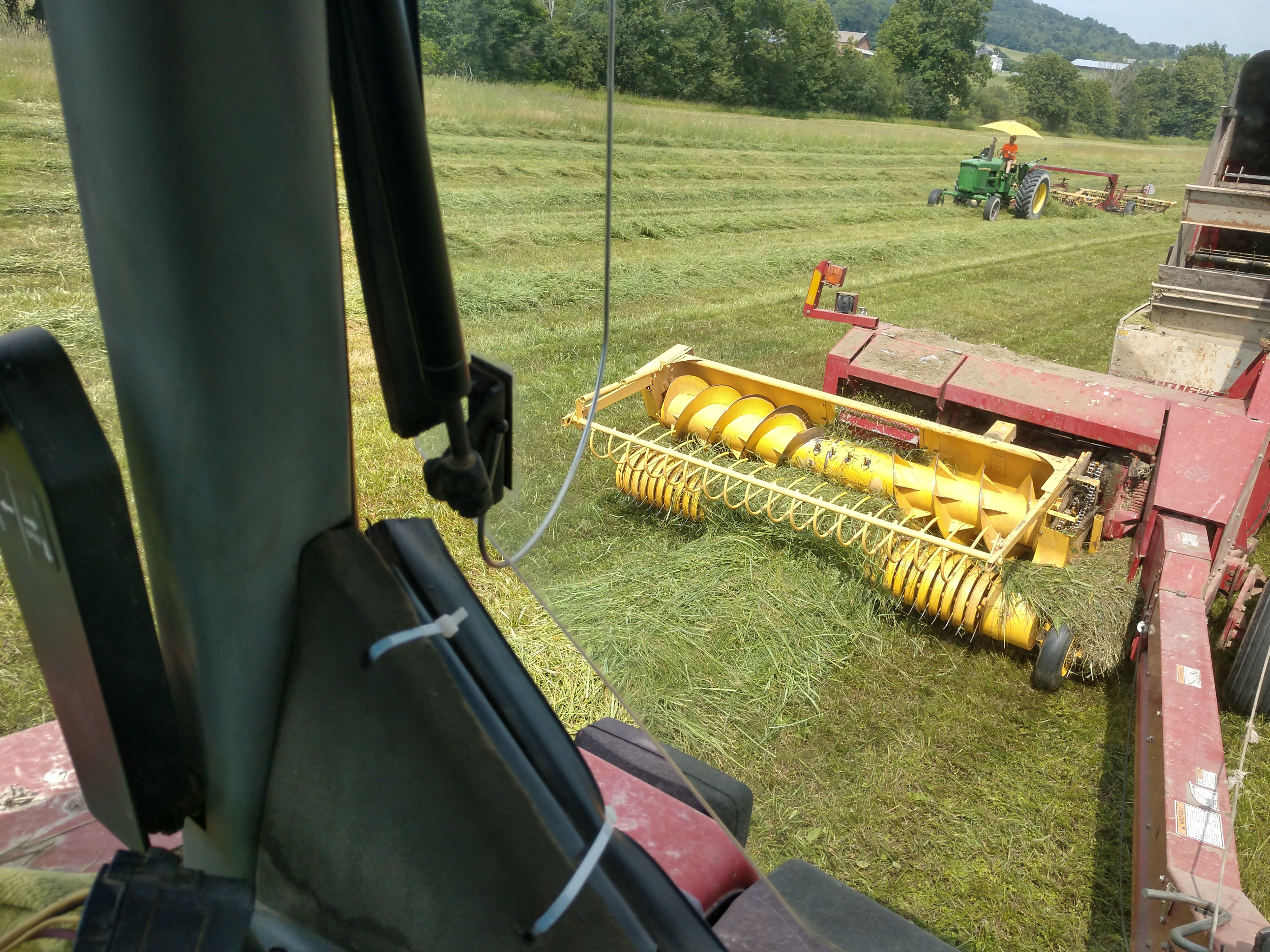

I have hauled a few heavy loads with clevis hitches myself; we do not use tight fitting pins for that reason.
When the holes get to ovaled out a bit of welding will cure that.

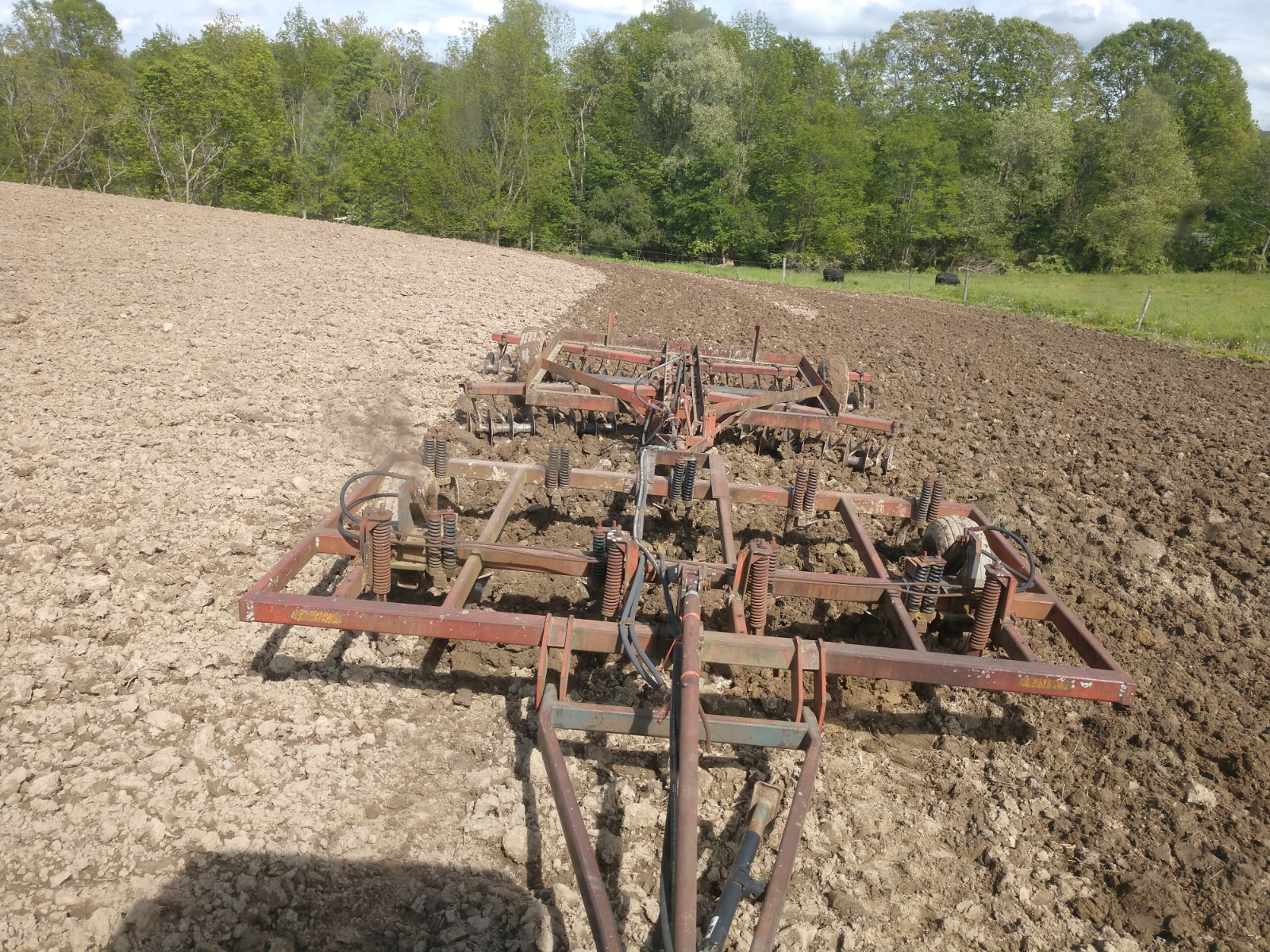

And a few light ones,

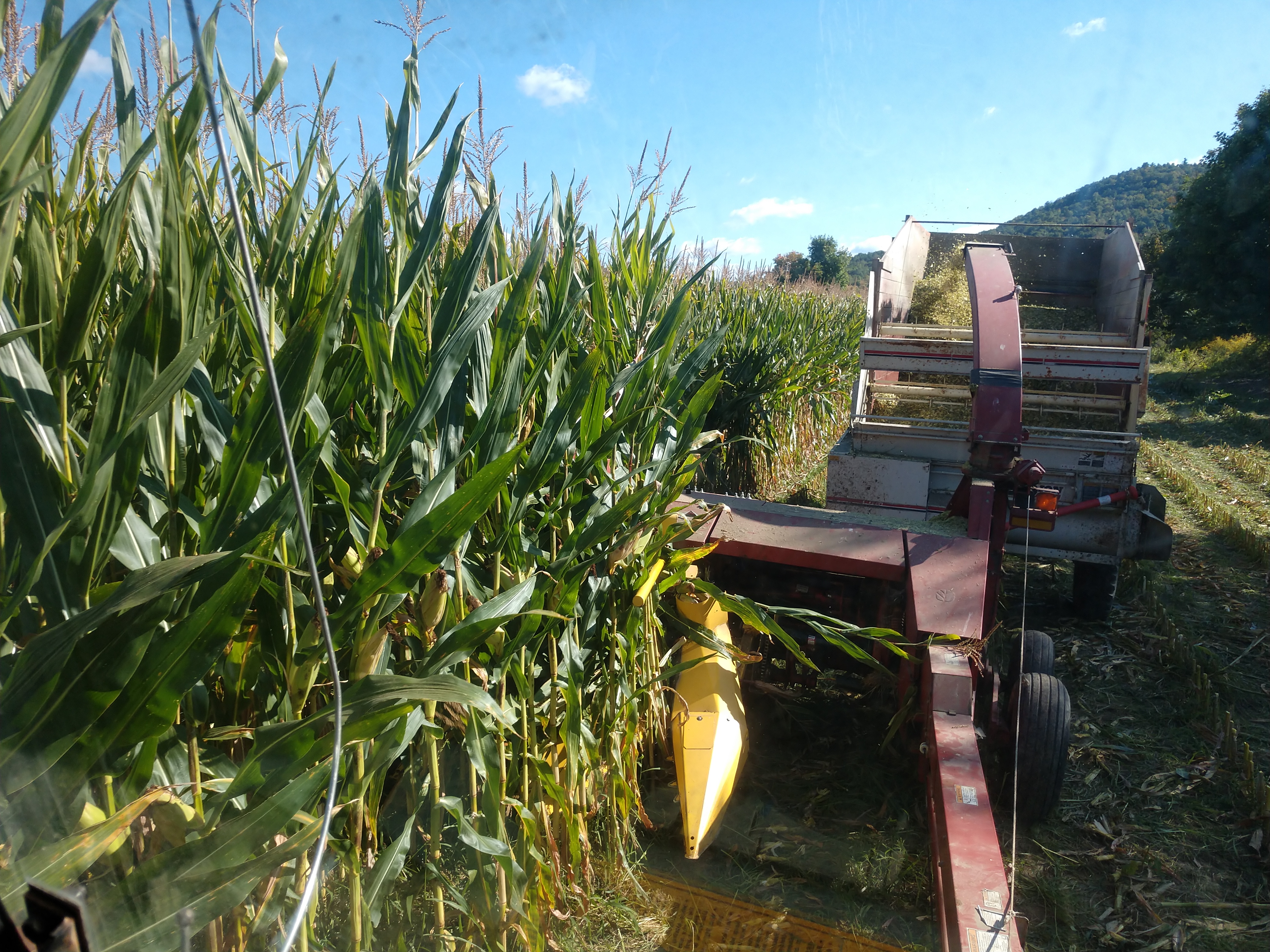

The chopper is attached to the tractor with a clevis and the unloading wagon is attached to the chopper with a clevis hitch.

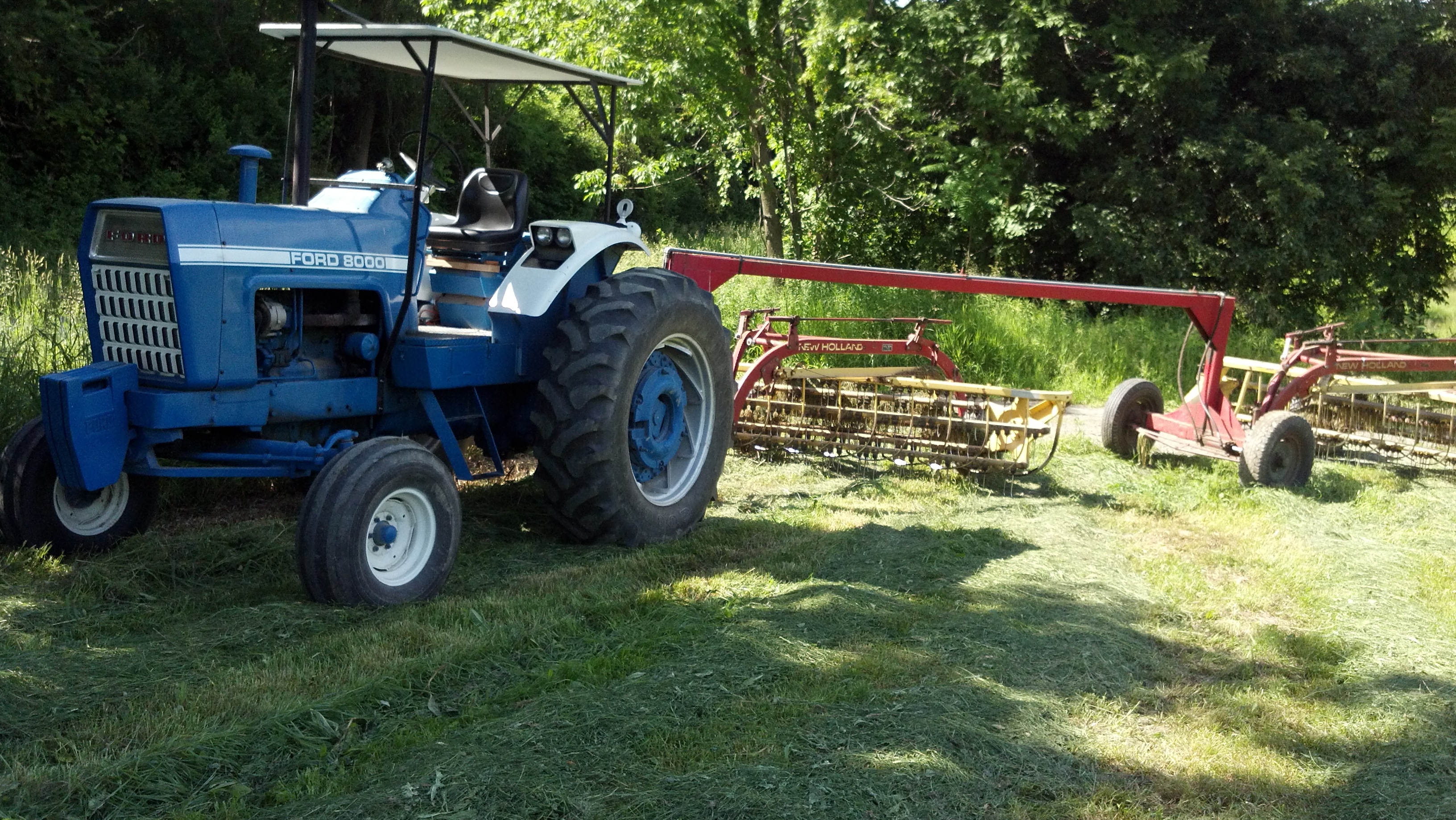

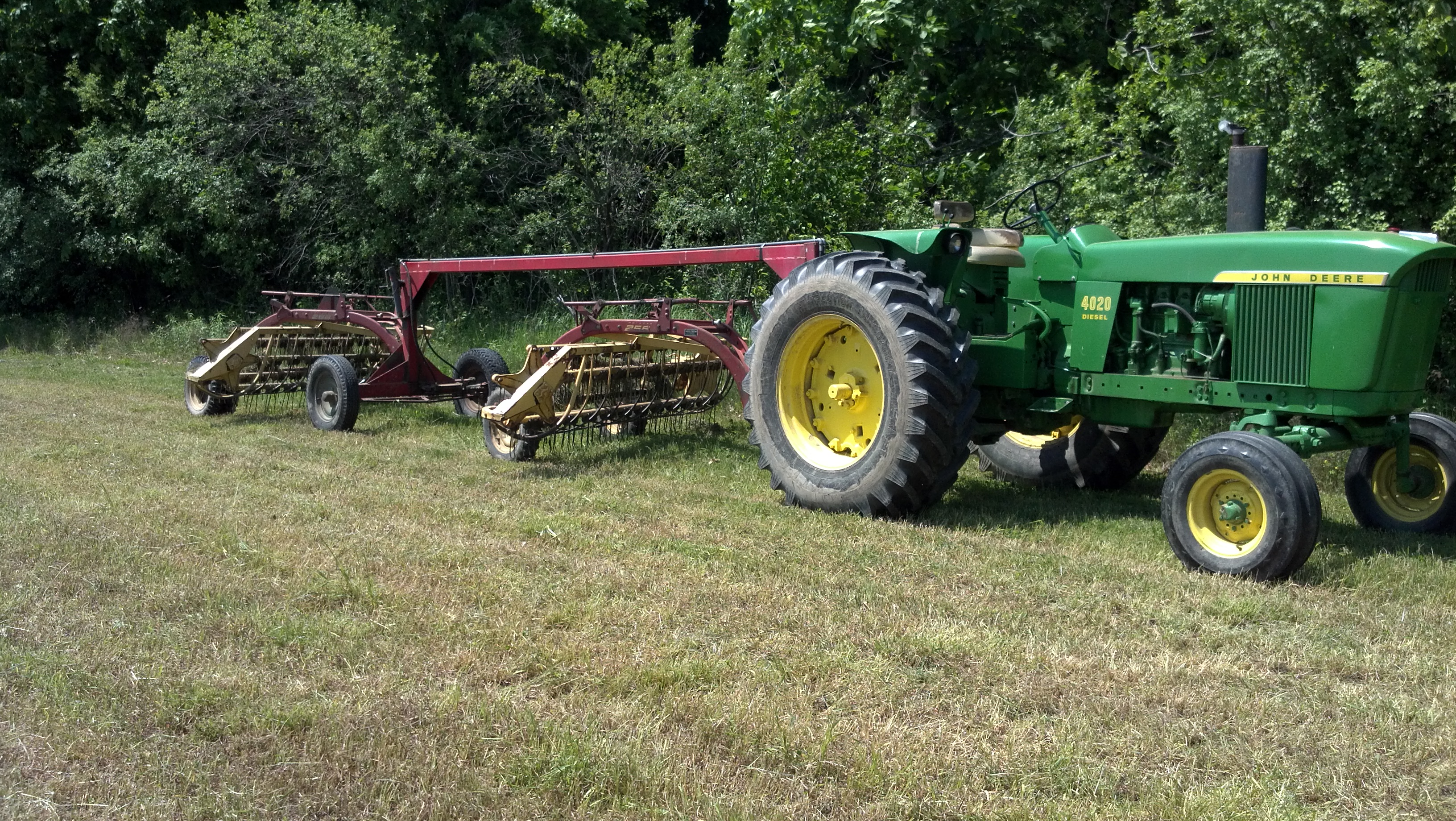

The rake doubler is attached to the tractor with a clevis and both rakes have clevis hitches so 3 in that setup.

That 4020 is the prettiest tractor ever made! Never had one, but loved seeing them in the fields growing up.
   / Broke Down and Got One of those Fake Drawbars :-( #59
The Deere 4020 is nice, I'm partial to the Ford 8000 it was our first "big" tractor we got that in 1968 prior to that the 560 was the big one on the farm.
The 8000 was very nimble with the set back front axle we tried a 4020 when we got the Ford.
The Ford just seemed better in the fields to use then the Deere.
