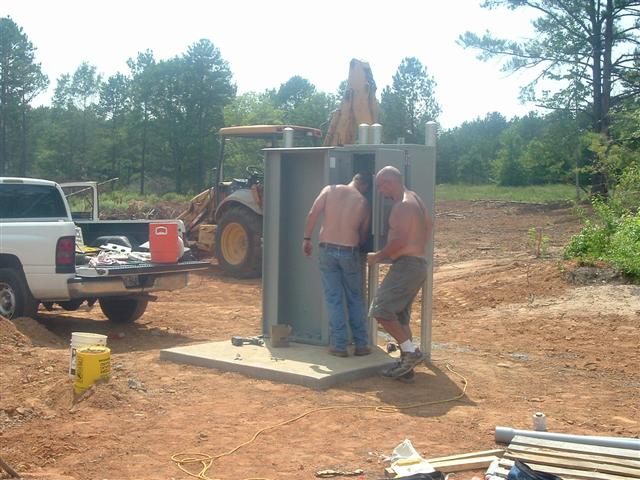

I dug my trench about half way, then unrolled my wire. It's 4/0 URD for direct burial. My trench is 8 feet deep at the panal and slowly works it's way to six feet and will end at four feet.
The reason I'm so deep is that in the future water and sewer lines will cross over these wires, and I don't want to risk digging them up again.

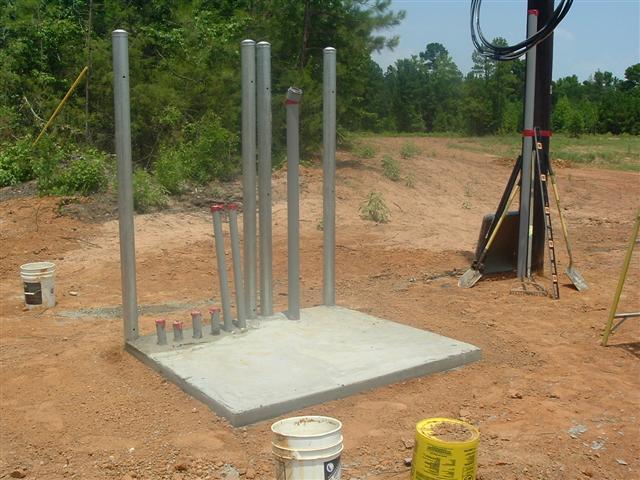

Here's the view from the bottom of the trench. I got lucky and was able to push the wire up through the 2 inch conduit into the disconnect box. It was one of those jobs that you measure in inches with lots of breaks!!!

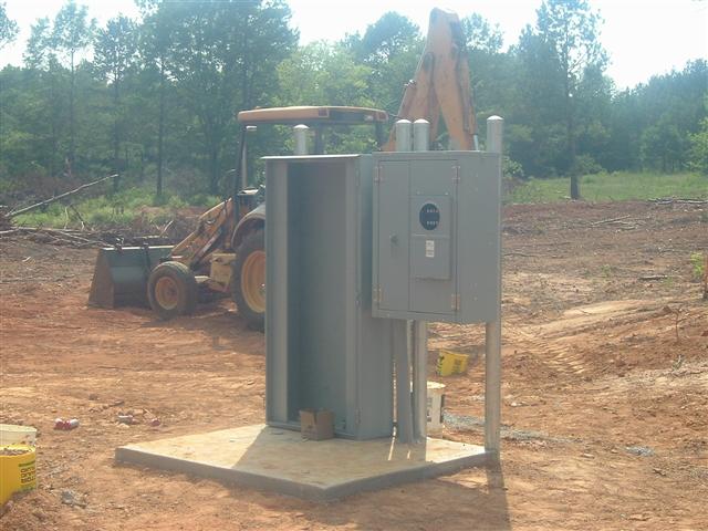

Way back when, I used to seal off the pipes with plumbers putty. Not the best method that I've come across.
I like expanding foam!!!!

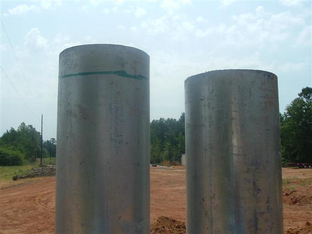

This is the finished product. I angled the shot to maximize the wire and connections. From most angles and a little distance, it all disapears in the background.
The meter is scheduled to be installed today. You have no idea how tired of listening to my generator I am. /forums/images/graemlins/frown.gif

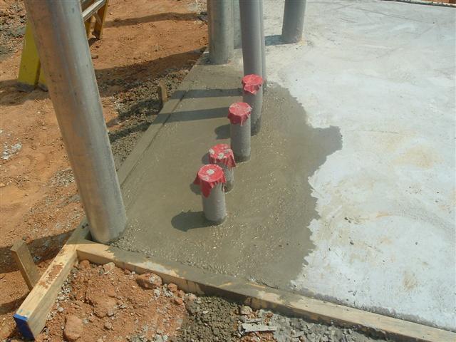

Here's a closer view of the connections. Not much to do about it.
