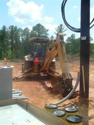

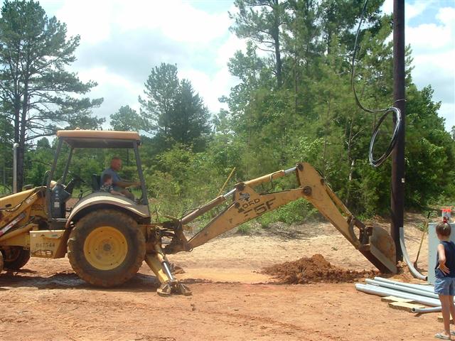

When I tried to glue my conduit toghether I found out the glue had dried out on me. OOPS!! Anyway, I was heading to town anyway, might as well add glue to my list.
This is the 3 inch conduit that will bring the power to the meter box from the pole.

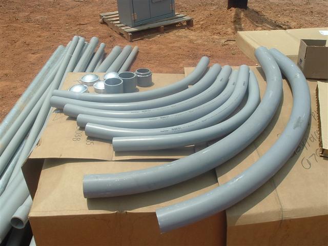

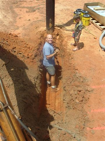

#23
The trench is 8ft deep. I'm running this pair of conduits so deep because I'll be running my sewer main across here at 4 ft deep along with my water main, wich will be 3ft deep. There will also be electrical runs and some one inch water lines crossing it.
My reasoning is to make it deep enough that it won't be in the way when I start installing those other lines.
I'll keep it this deep for about a hundred feet, then bring it up to about 4 ft until I hit the workshop.

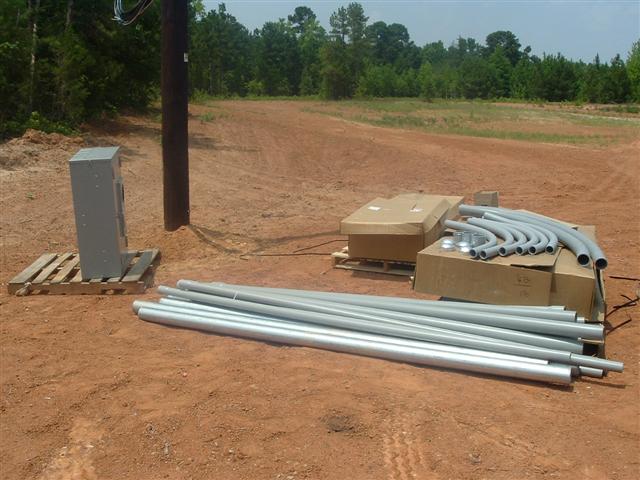

#24
My electrician decided the distance he wants the conduit spaced. I decided what I need power for, and when I'll need it. The buckets are to mark the end of the lines for easy location when I get ready to use them.
