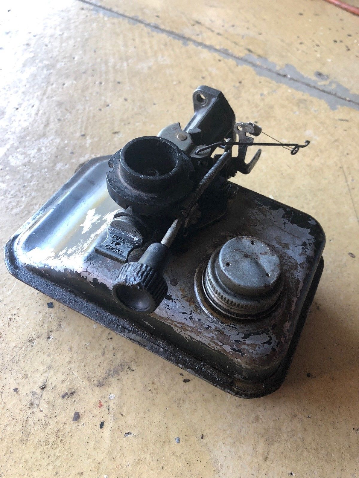

So I am trying to get an old B&S engine running. Got it to run just a bit pouring gas down the carb. Took the carb off and soaked it in thinner, got everything cleaned up. The problem is that the threaded piece ( Has a 7/16 hex with external threads, screws into carb and internal threads, jet screws into) is corroded and broke. Now the engine shroud may have been changed as the Model 80312, Type 1524-01 shows a different carb on the parts list. My carb comes straight out from the horizontal shaft engine, has the tank mounted under with 1 pickup tube. There is no other numbers on the carb. The B&S parts website is down and I need help to find the part/prt# to get this running

The engine is on a Marlow Mud Hog, diaphragm pump. can't find any manuals for it. I am not sure which carb will work as the model numbers may be wrong and I haven't found the exact carb. I did order a high speed jet, p/n 299060, but it was too big. That's why I need the correct p/n to order.

I have the model/type but when I look them up it shows a different carb. Shroud may have been swapped out.
As for ordering a new carb, not sure of the correct replacement. Model/type may be wrong numbers on shroud

Your engine looks closer to a 080202-1672 either 01 or 02 type. Carb looks close, but they use the 299060 jet that you are saying is too big.

Thanks for all the comments and suggestions. I think I have found the carb.
Briggs and Stratton :D11-:rolleyes:-99 - Briggs & Stratton Horizontal Engine (2) Carburetor Assemblies Diagram and Parts List | PartsTree.com
I have ordered another jet that may work p/n 299059. The part I need is 117, but I ordered 681 as an assembly. See part 96A? If the drawing is correct, then that is the defining part for my carb. Parts should be here Dec. 11th so I should find out if I can get this thing running. Hope the diaphragm and flapper valves are still good. A new diaphragm is over $200.00

Those lil 2 & 3 hp carbs are basically all the same. Pulsajet diaphram along with the fuel mixture screws will be what you need. They're all the same. I know what your going thru to find parts for the old style B&S engines. I'm refrub'n a gokart simple yard-cart and have several 5 hp engines trying to fing carb parts for at least one to get er going.

The 2-3 hose early Briggs engines with the shallow fuel tank had the Vacu-jet carb with one dip tube that sucked fuel directly out of the tank to the jet. The 5 horse and newer type engines have the Pulsa-jet carb with 2 dip tubes, one tube goes to the bottom of the deeper tank and it has a pulsed pump that pumps fuel to a bowl in the top of the tank and a second tube goes to the jet from that upper bowl, so as fuel level in the tank goes down the carb does not lean out with the fuel level dropping like the Vacu-jet did.
