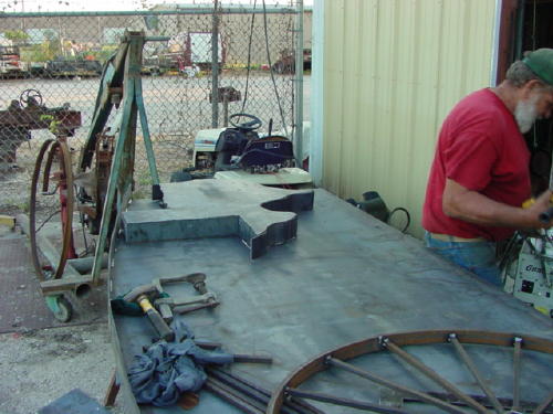

It was trimmed up and hauled to the bridge.

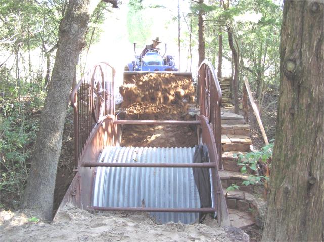

WEEK 7
(note: These and many more are below in the meetings and get together section for members)
At last, the part of the bridge project that requires a lot of tractor work.
It is a beautiful day in central Texas. Mikim volunteers to help and his 5' loader is desperately needed to fill in the 68' wide bridge (my 6' loader would dump too much sand in the gully). Mike is about an hour away and I'm all smiles as he pull up with his big blue.

#117
We travel to the back 40 and position for the ceremonial first scoops!

#118
Since Mike's tractor is the perfect size I get two scoops for the front of the bridge and Mike gets about 20 for the rest of the fill.
