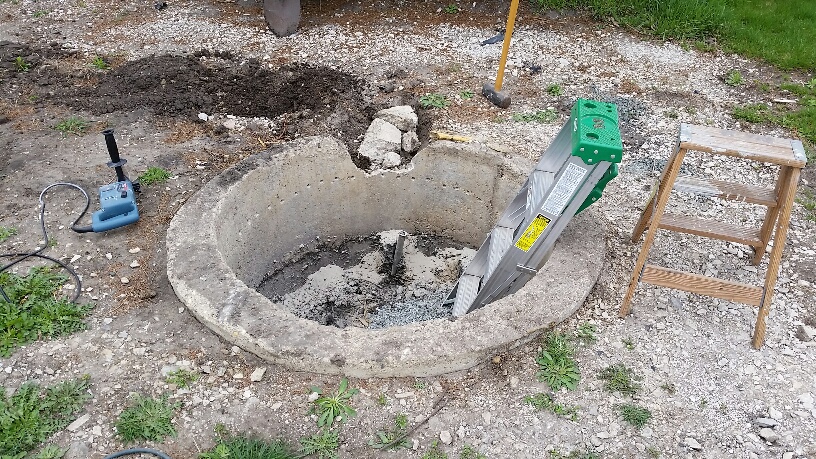

From the photo, I looks like there is a joint about 1foot down (estimate-size on a photo is hard to estimate) but it looks like the joint is about at the dirt line. I would try to separate it at that joint and just lift it out with the FEL.
It looks like there is a cemented joint on the left quarter in the photo. SO digging down about a foot to the seam between joint (as it appears in the photo) then pulling outward on that quarter and it should separate easily, no breaking required.
If you have a FEL on your tractor, then the digging should be easy, not as much as with a backhoe, but very doable.

Looks like an awesome fire ring... I'd keep it! I might cover it with a stone face, though.
That's an excellent idea but it is about 100' away from the road, which is too close for comfort,,,, if you know what i mean.

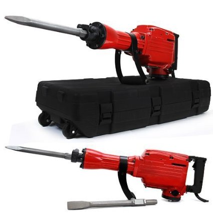

I had good luck with this. i used it to take off the top of an old chimney foundation. Easy to use. My wife even tried it.Much easier than a sledge!
Amazon.com: XtremepowerUS 22Watt Heavy Duty Electric Demolition Jack hammer Concrete Breaker W/Case, Gloves: Home Improvement

I imagine that would work, but for $149, I might come up to Iowa and knock that thing down with my own sledge hammer.. I am telling ya, it is not that big of a deal to bust that up with a sledge. You don't even have to swing the hammer over your shoulder, just swing it along the ground and that concrete will give way.
