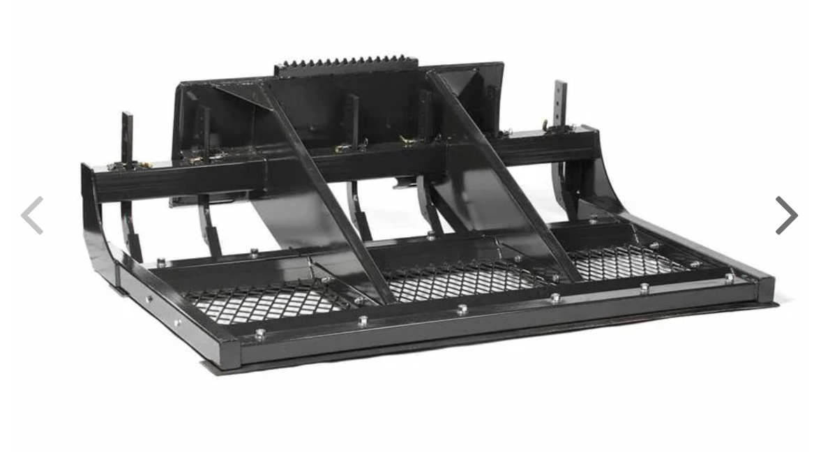

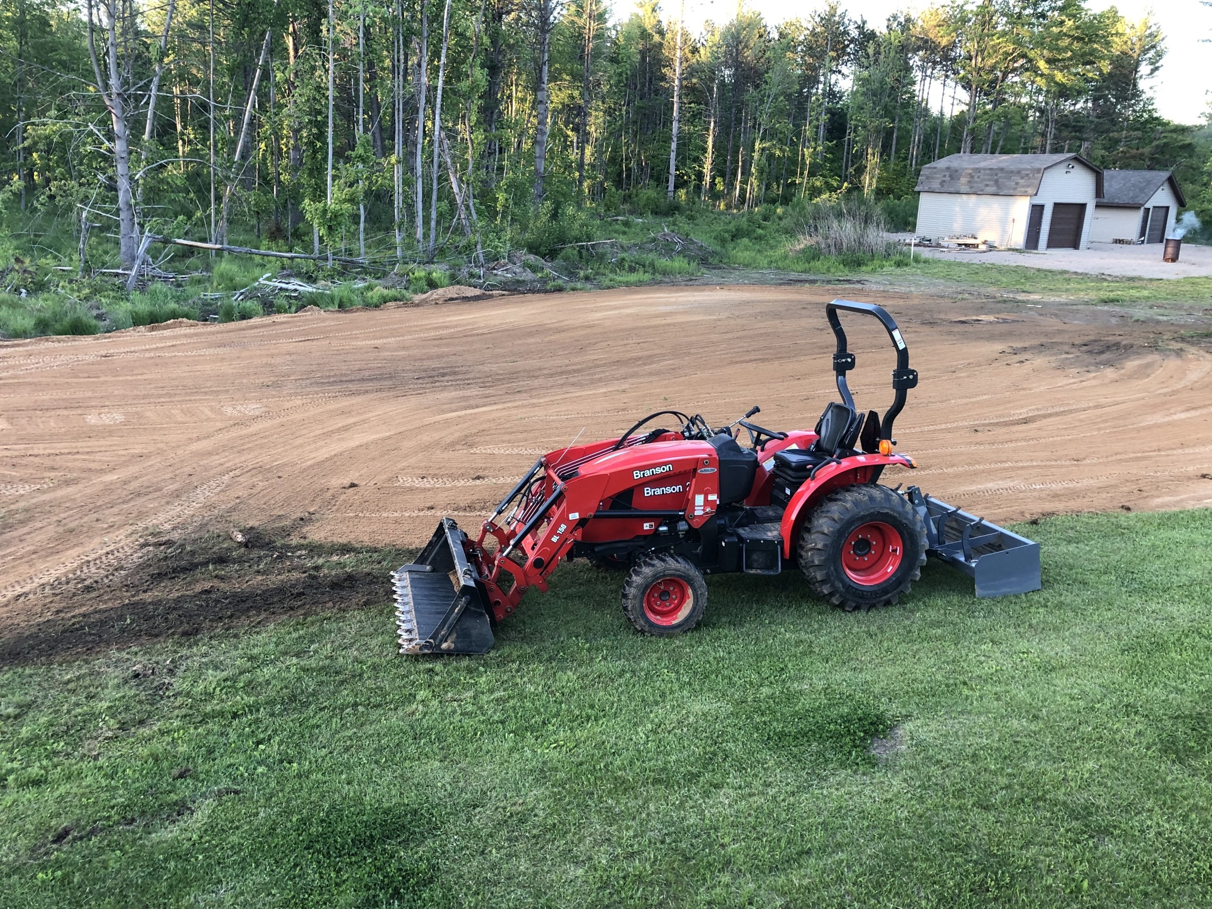

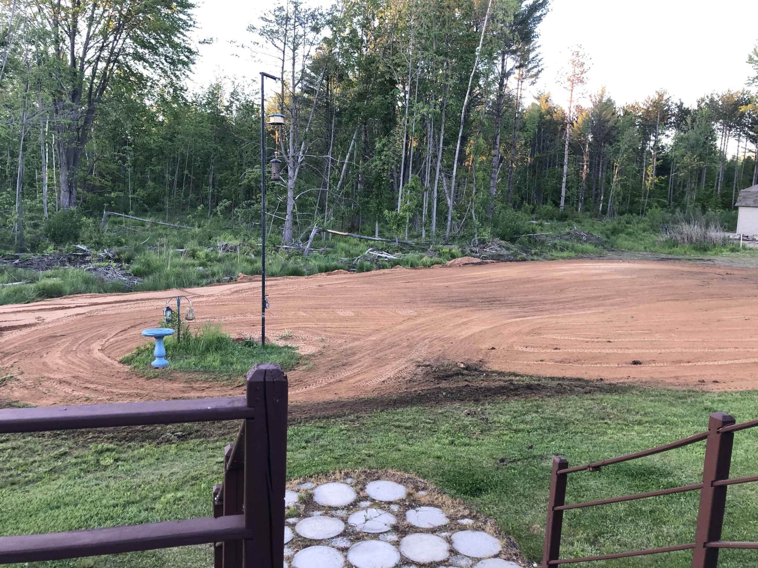

I would like to make something to attach to my bucket to help me breakup and level some areas at my property. I have been doing a bunch of fill work and have gotten these areas close to how I want them but there are some inevitable dips and rises that I would like to level out. These areas have been driven on a lot and rained on some, so a regular old bucket back drag no longer does the trick. I was thinking ideally I could make something to attach to the bottom of my bucket so as I back drag it breaks up this surface, knocking down the high spots and filling in the low spots and finally smoothing it out a bit. I was thinking about having some chainlink fence trailing the bucket for the final smoothing. Has anyone seen a product like this? Does this make sense to do? Is there something cheapI could buy?

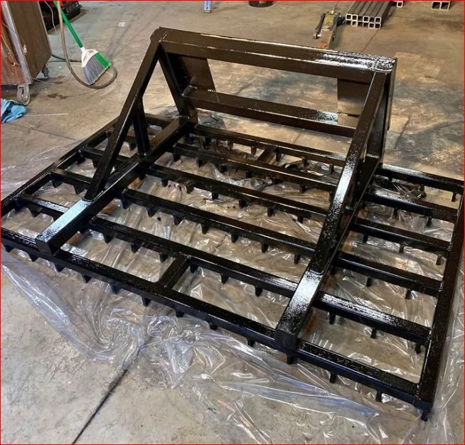

Land Leveler Saw this on Facebook Market place. Made to order.
/ Brainstorm with me!!
I have seen those, that is what I am going for. Those are $800 to $2000, depending on the fanciness. I think I can make something similar for WAY cheaper

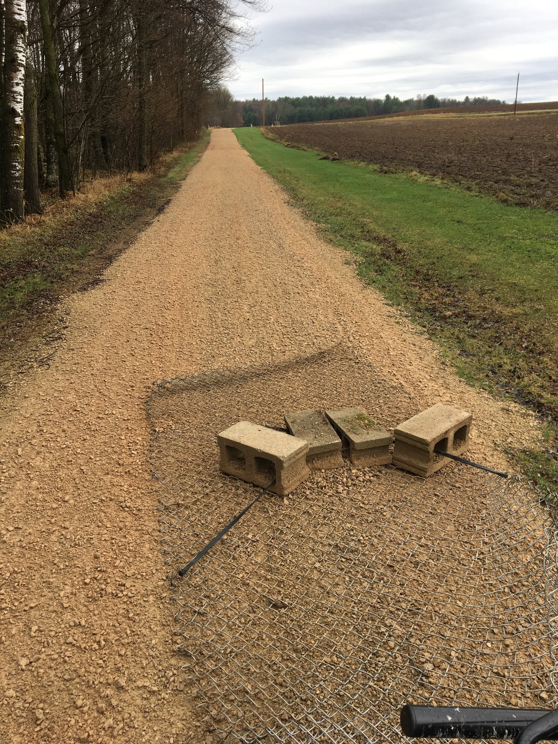

Find a good 10 ft of heavy chain link fence. Bolt together two 2x4 on one end with the fence sandwiched between. Put 3 or 4 cinder blocks on the front and drag with 4 wheeler. Turns out nice .
