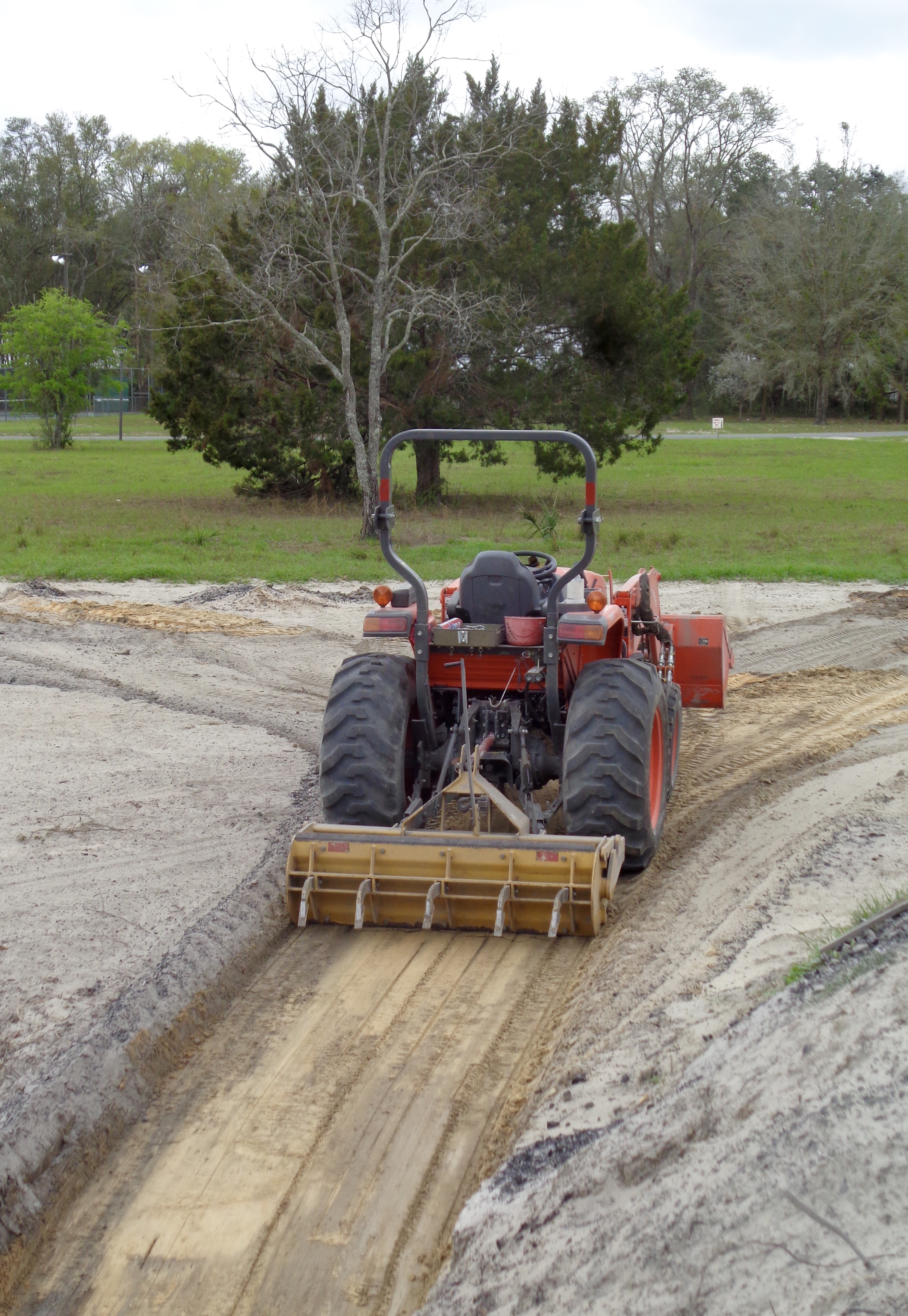

BB1272 = 404 pounds
BB1572 = 504 pounds
BB2572 = 549 pounds
The Three Point Hitch provides no hydraulic down pressure on implements.
Therefore, heavier BBs will cut better than light BBs and require fewer Top Link adjustments for acceptable peeling of dirt layers. The key metric is weight per unit of width.
Consider also the BB's role as Three Point Hitch counterbalance to FEL lifts.
If your rear tires will be "loaded" with liquid, 504 pounds should be just adequate.
If your rear tires will be inflated with air consider a BB of 600-700 pounds.
Box Blades have a considerable learning curve. Be patient.
60" Bush Hog brand Rollover Box Blade in pictures weighs 620 pounds.
(124 pounds per foot of width)
