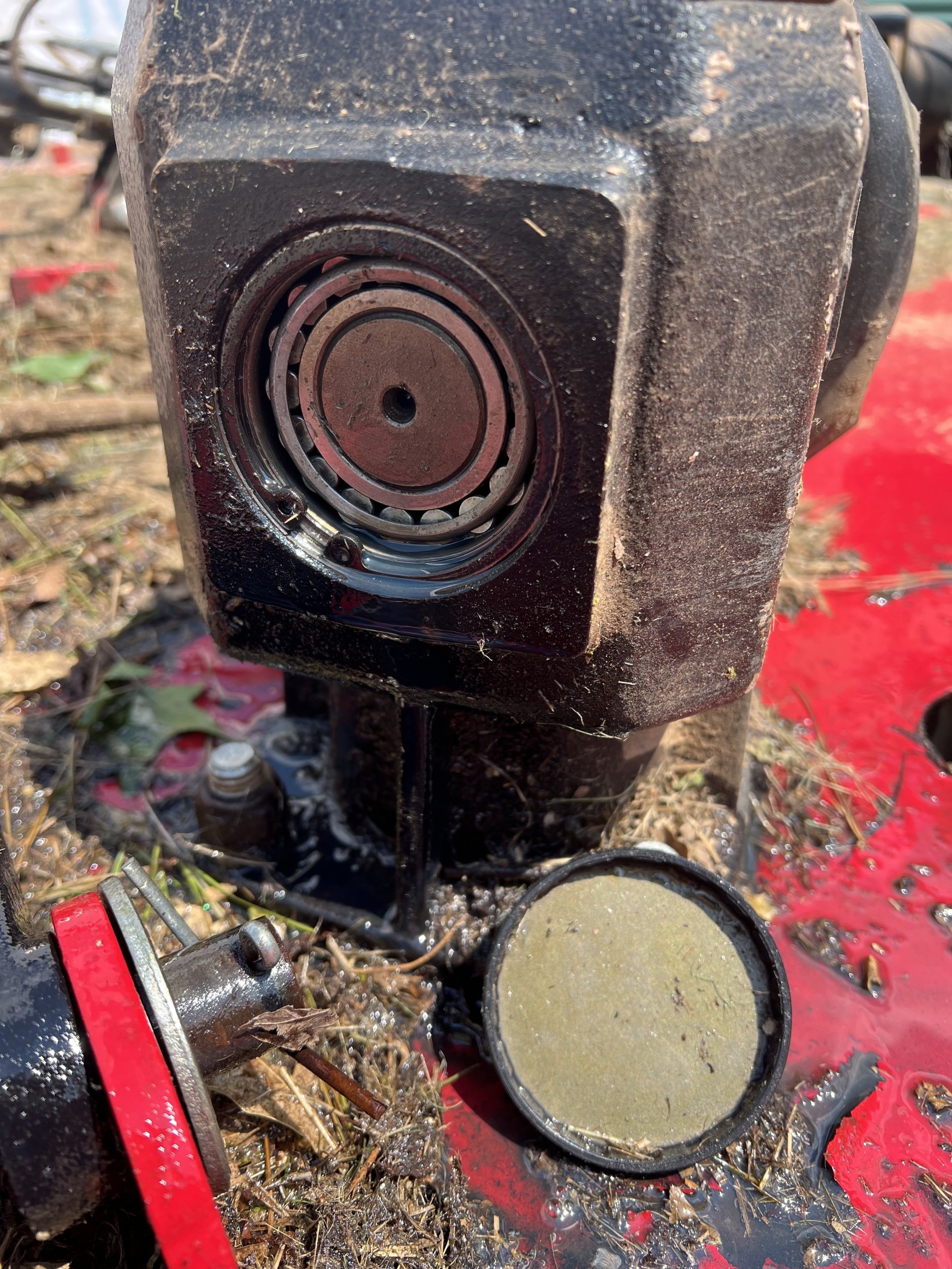

While minding my own business, just driving along, mowing the grass, I heard what sounded like a branch being destroyed by the mower blades. But it kept going of for longer then it should, so I looked back and saw a round cap laying behind the gear box, and oil everywhere.
I headed back in and took of the top cover. The gears all look good, but the gear that goes through the middle of the case, and connects to the driveshaft, slides back and forth. If I slide it to the tractor, it turns the blades. If I slide it away from the tractor, the blades do not turn.

Did it push the snap ring that holds the bearing race out of the groove? Kinda looks like it and then it pushed the plug out.
Being that the bigger gear pushes on that bearing under load, the hit may have been hard enough to push the snap ring out the groove. To be honest, not a very good design solution for that.
/ Batwing Gear Box blew up
I think that's what happened. I took out the snap ring and tried to push it back, but it wouldn't move, so I decided not to make it worse, and I put the snap ring back in where it's at now. The cap that fell out, wont go back in because the snap ring, and bearings, are in it's way

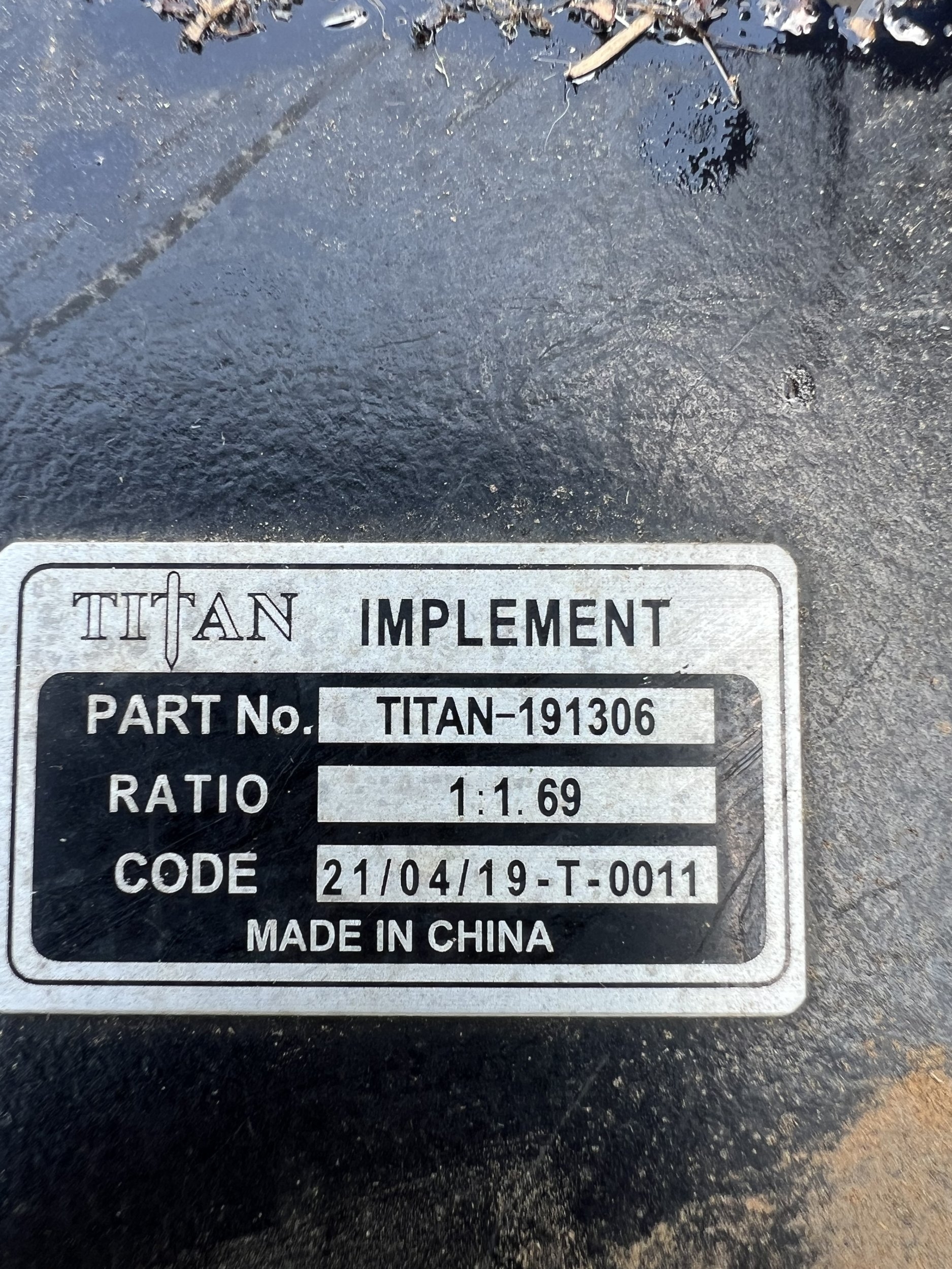

The mower was Titan when I bought it, but a couple months later, they changed their name to Iron Craft after losing a court case against the other implement company in Tennessee that's also called Titan.
This is the top of the gear box.

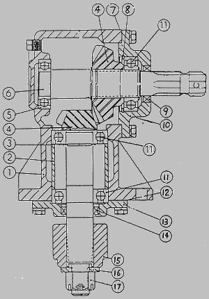

Unrelated to the failure, but it seems odd how the splines on the main drive shaft extend through the front of the gear box. I wonder how you can ever get a seal with that kind of arrangement? I can't see this part on my Frontier cutter, but I'll bet it is the same and probably explains why it leaks oil out the front with very low hours (100 hours, estimated).
This is how I would have expected it to look:
