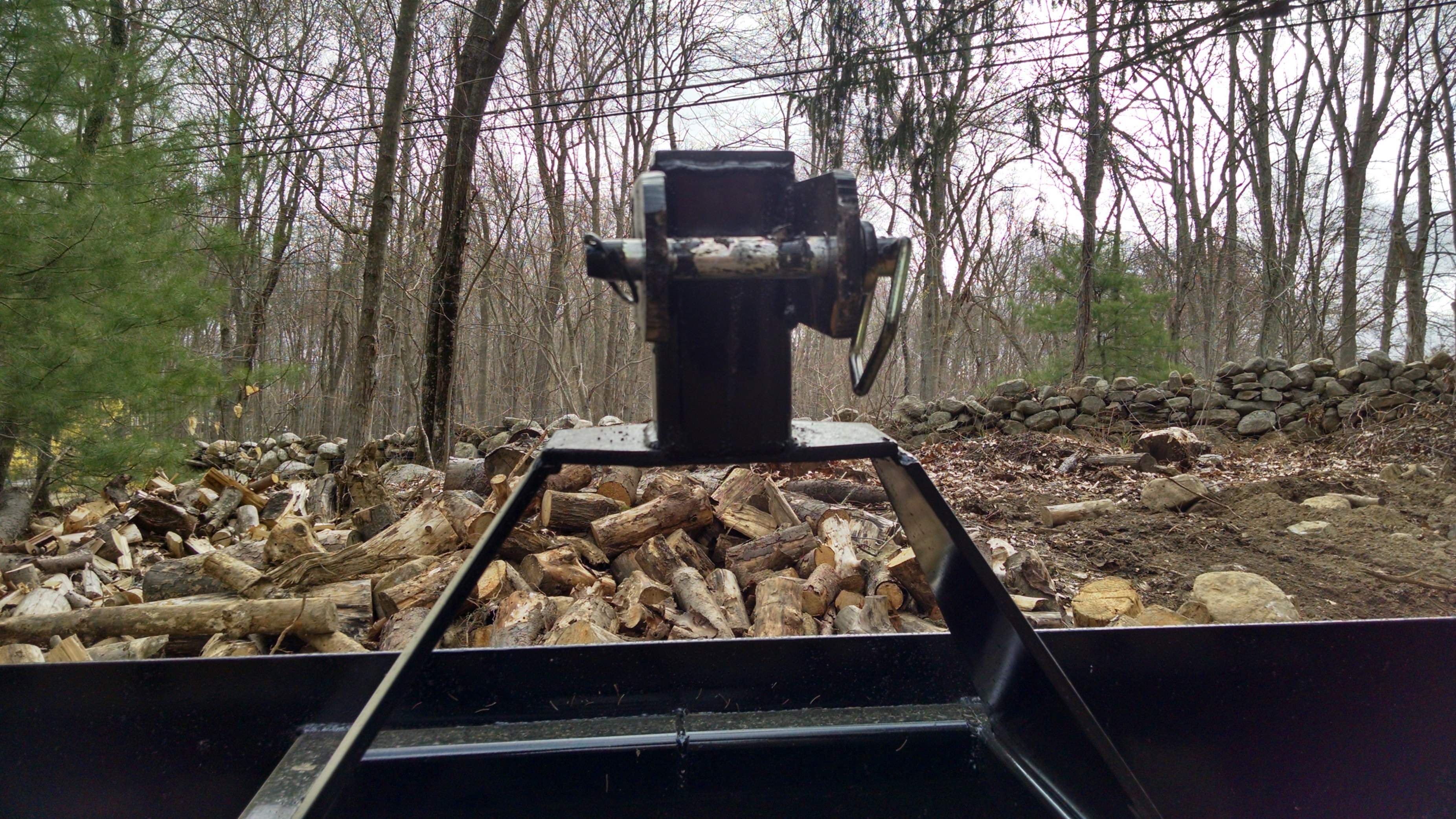

That's a really nice blade, better than I could have built.
I do have one concern, where the top link attaches. It seems like it could use a brace from there to the top of the blade. There can be a lot of strain where the upright square tubing is.

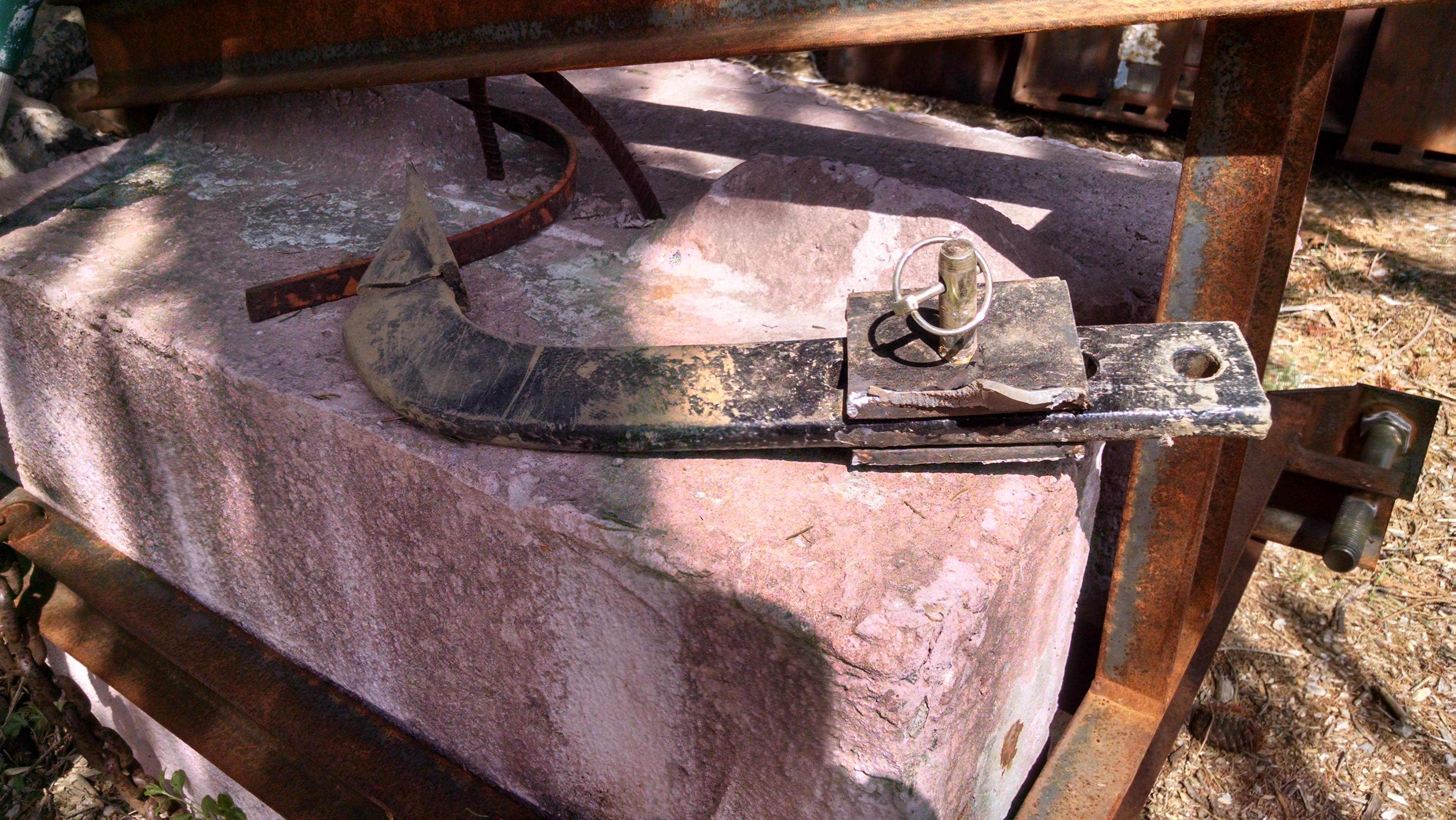

Your concern has merit. I also had concern in that section, but thought the 3" by 3/8" bar would be enough. I figured if it would fail, it would twist, since flat bar isn't very good in torsional loading. Well, it did.
I did test it before painting, and it stayed straight even ripping some hard ground and pulling out rocks.
This happened by hitting a rock pretty hard going backwards. I'm glad I didn't do anything to the 3 point arms.
I'll add gussets or something to keep it from happening again.
I was originally going to add a bar to the rear of the blade like you were thinking, but I found it was in the way too much if I wanted to adjust the ripper teeth. There are lots of designs with the large triangles like I used with no center connection, the reason mine bent is the horizontal section of flat bar as opposed to a formed end like the commercial unit. I'll add gussets and it won't bend again.

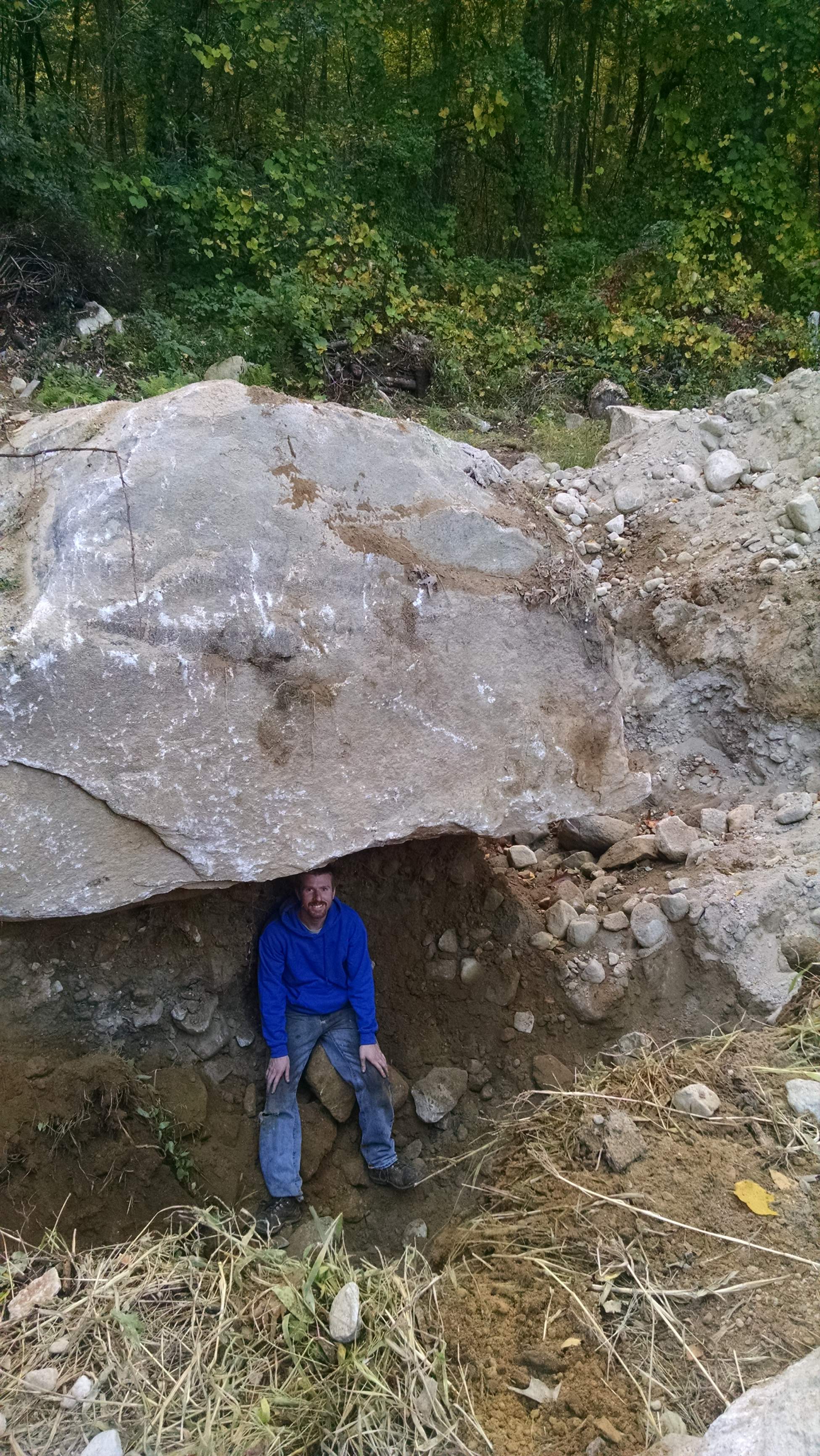

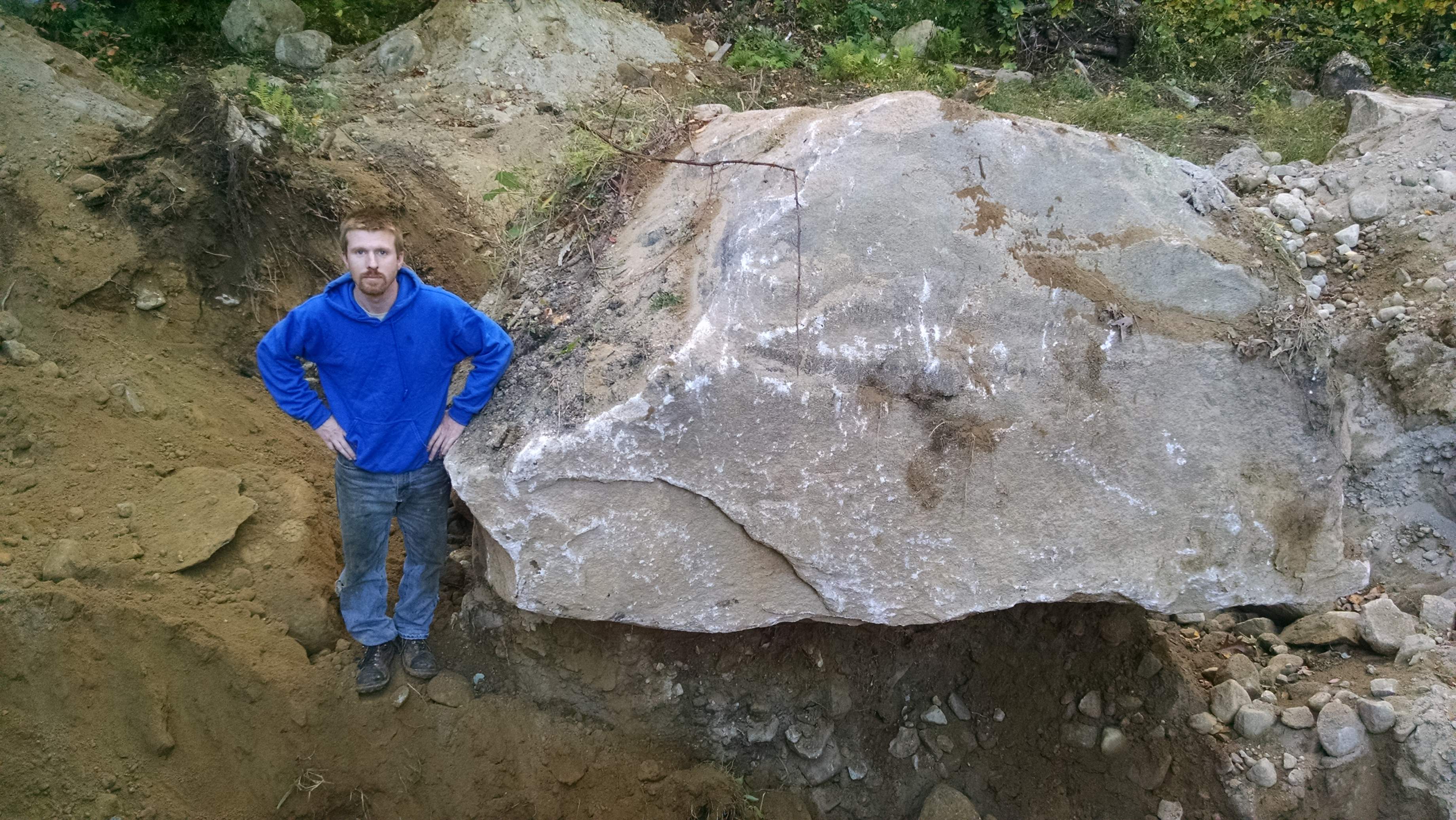

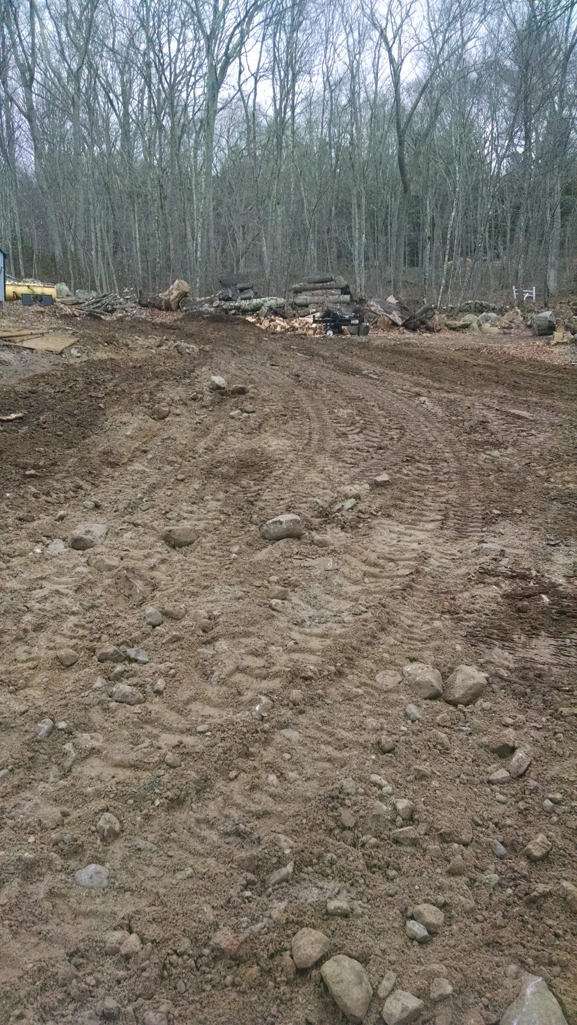

The blade is primarily for loosening rough areas before grading with the loader. I have one project I really need it for, which is cleaning up after burying this rock.
I doubt I'll use it on the small section of gravel driveway I have, a york rake is a lot gentler and all that I need to smooth things out there.

Another good idea is welding another 3/8" flat bar on the bottom of the sides so it wears longer. The front corners wear the fastest. Hardfacing would be good their too.
