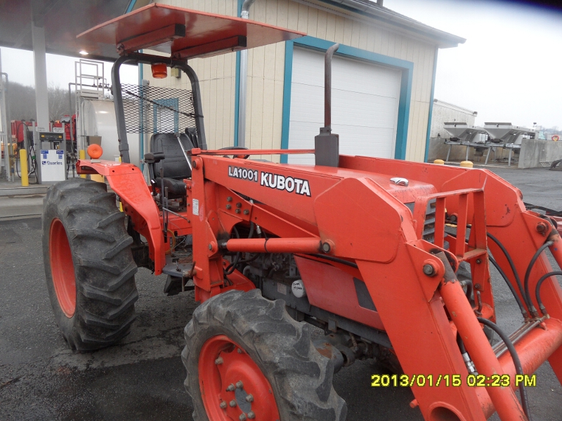

something like this: IMG_20151207_150524186_HDR.jpg
Kubota M4700, 4WD 50HP eng. 42HP pto.
$11,500 when I bought it w/ about 1400 hours on it in 2013

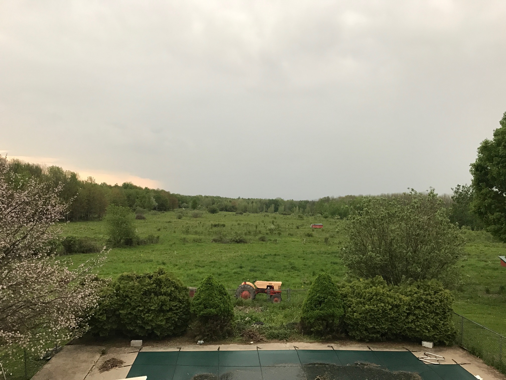

I would compare "reclaiming" to a pasture- mostly weeds with some small brush and a few small diameter (2-4') trees sprinkled about. I thought about going bigger but once the land is up and running I felt it would be overkill.
My plan is to finish getting the brush and fences down this summer and the following spring to have someone come in and take over from there. I don't want to make the investment in enough power to plow or disk it.

OK - so those two pictures show a portion of the 140 acres. I'm on board with Kyle and would recommend at least 75 hp. If you plan on mowing everything down and cleaning it all up - you will appreciate the added power.

The pics are of the rougher area that needs to be cleaned up. Once it痴 cleaned up I expect to have 10 acres of wet area and otherwise un-tillable that aren稚 woods.
I壇 prefer to keep the purchase under 25k Which would limit me to older higher horsepower units and new 2nd tier manufactures.
