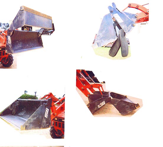

Also, get a spinner for the steering wheel. With a 4410 and a 72 inch deck its worth it. Think about a 4 in 1 bucket with a toothbar. Think FEL on steriods.
jimmo
   / Bought My First JD, Any Last Word of Advice?
#11
what is a 4 in 1 bucket?
   / Bought My First JD, Any Last Word of Advice? #12
The R4's on my 4310 are loaded with beet juice and I have more problems with the front tires cutting up the lawn in the spring than the rears. Loaded tires lower the center of gravity and would be really helpful on hilly terrain. It's like the rears are the correct width and the fronts are too narrow. However, if they were any wider they would hit the MMM when turning.
   / Bought My First JD, Any Last Word of Advice? #13
See attachment for what a 4 n 1 bucket looks like. Do a search and you'll find lots of information! /forums/images/graemlins/wink.gif /forums/images/graemlins/smile.gif
