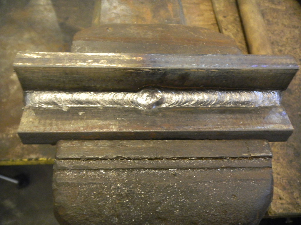

Sometimes it works best to stop in the center.

When looking for advice on how to improve your welds, show the finished weld as welded and not cleaned up or polished so much you can't even see the ripples in the weld. The ripples in the weld can tell more than you think.
/ Bought a Miller Multimatic 200
#106
Its just lightly wirebrushed, just enough to get the soot off - the ripples are so faint it would be hard to see in a photo. Need a different method to get the soot off (to see the ripples).
This pic is simply my first weld, I simply wanted to show that if the first weld is this easy, success is feasible. Not really ready for advice yet as the whole of my experience is not ready for refinement as I was simply testing if it works at all. On my 3rd weld, molten aluminum dropped to the floor and spattered in all directions. My shop has a couple other projects going at the moment, and a pretty good mess brewing, it's not safe for welding, if ever. Normally I weld outside, consequently have to wait for a wind-less day. But how well this first test weld came out,,,,, was inspiring.

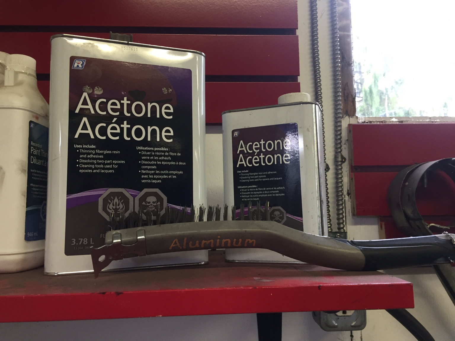

A stainless steel wire brush. But wait until the weld is cold! Also, never use that brush for anything but aluminum!

Also, get some acetone for weld prep. Keep some just for this purpose in a small, sealed (it evaporates quickly) container so that when you soak your rag you don't contaminate the bigger can.
Terry
#112
Thanks Terry. They tried to sell me some "aluminum cleaner" in a spray can at the LWS but I balked, thinking that with a little research I'll findt some existing solvent that's cheaper.
So you don't think the "dedicated ALuminum wire brush" needs to be "stainless"? Thats exactly the brush I used, and it took off all my ripples. Not that there were many. Also I might not'a waited for it to cool.:duh:

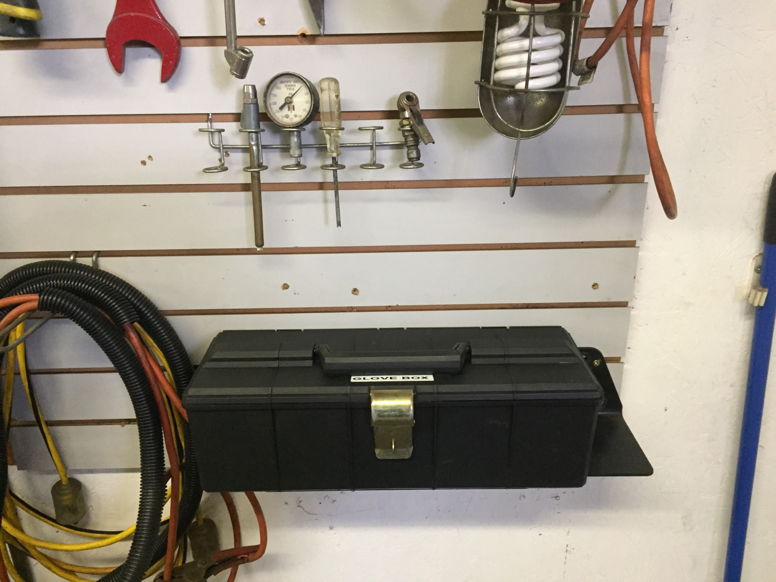

Sorry for the confusion, Sodo. That was a stainless wire brush pictured. It was labeled to remind me it was dedicated for use on aluminum.
At my age I need all the reminders I can get although I have yet to label my sock drawer.

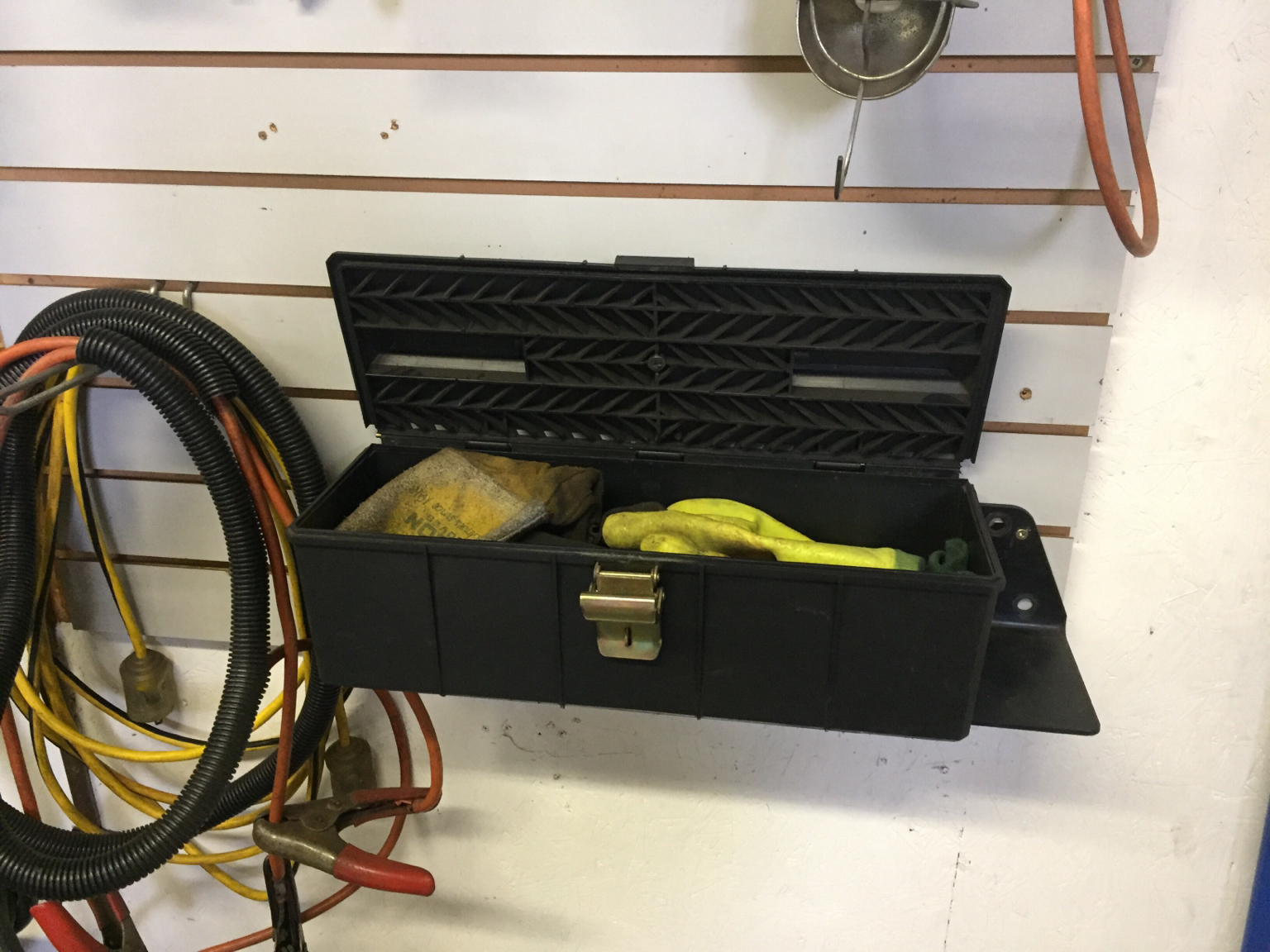

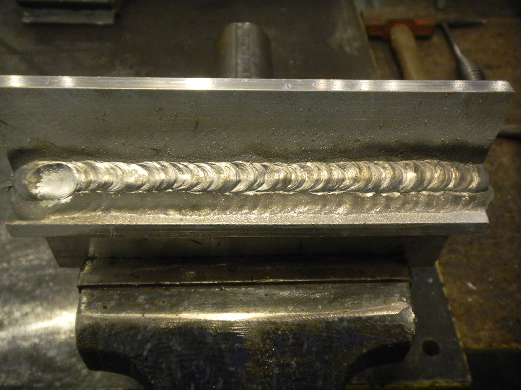

I've been using the Spoolmate100 a bit more. It' works pretty well. One problem I have is the weld start, it takes a little while for the heat to build up and the weld doesn't penetrate. So it kinda seems to me (for the weld quality with the spoolmate) that it's better to start in the middle where the stresses will be low.
You can see that startup lump where it was cold on the inside fillet.
The one outside weld with only 2 legs sucking heat away it looks like the heat built up quicker and penetration is better (than the 3-leg joints).
537079d1516817101-bought-miller-multimatic-200-a-aluminum_spoolmate100-jpg
I preheated other joints to 200F and the spoolmate welded them much better. Even 1/4" thick. Anyway I got my Aluminum projects going with this Spoolmate100 and it's a good tool.

Might try 500 degrees on 1/4. really wets in good. i always turn on acetylene only and soot smoke the weld area. turn on the 02 and heat til the black is gone = 500 degrees. Spoolguns love 500 degrees on AL.
