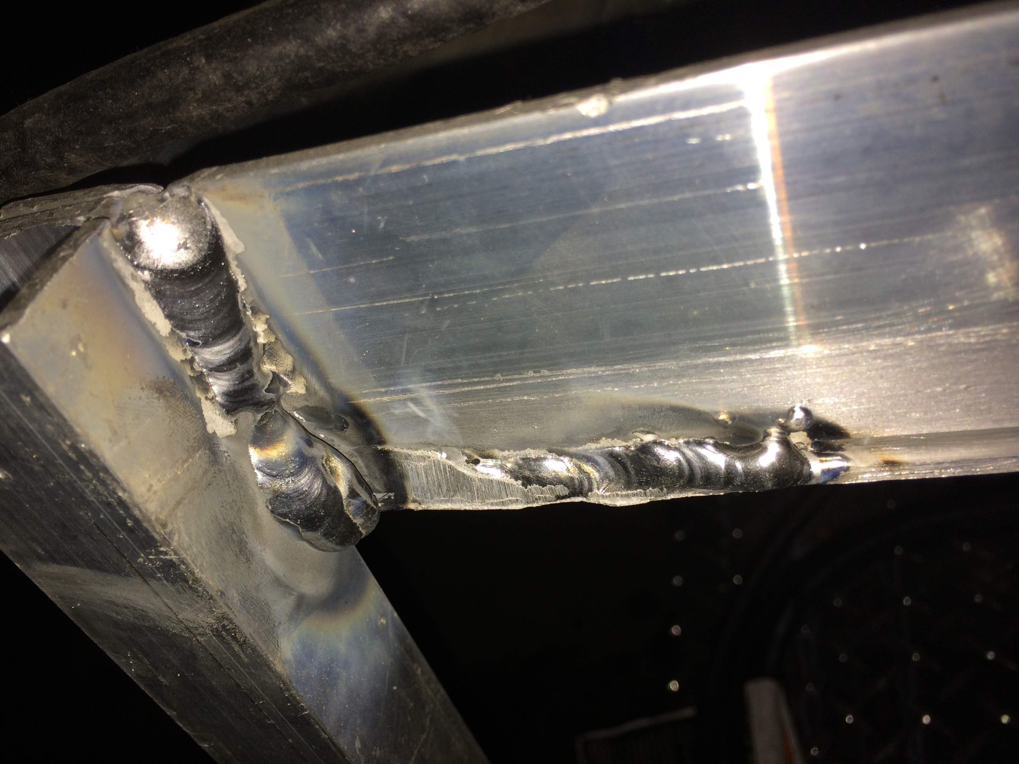

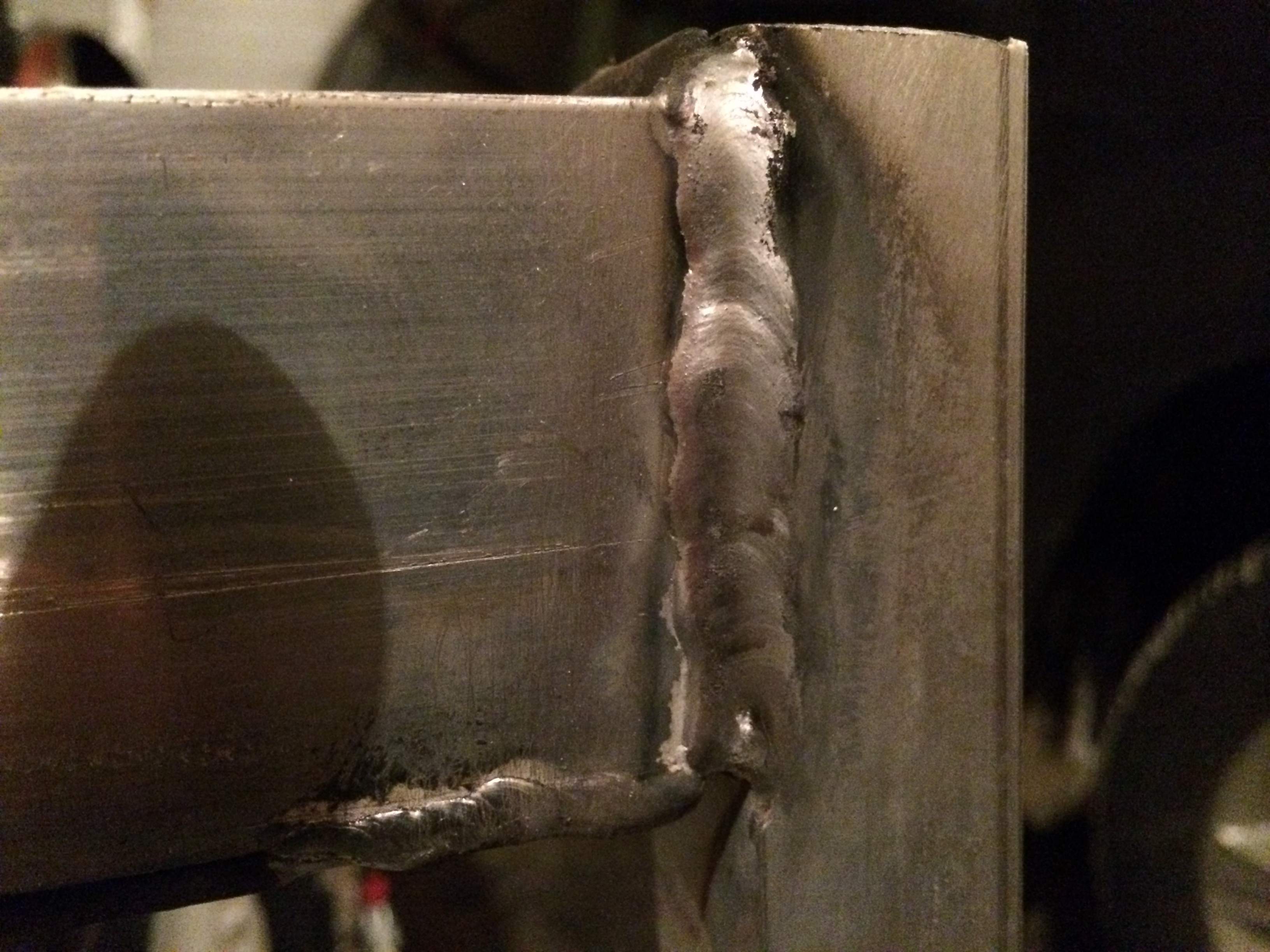

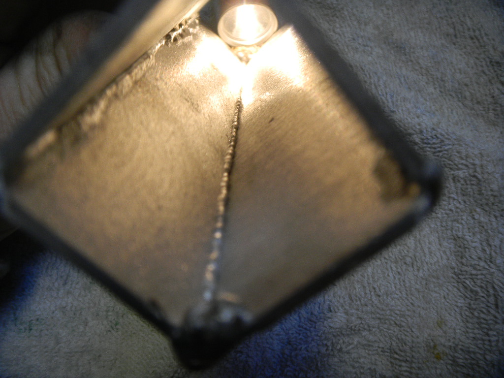

I played with the pulse when I first got my Lincoln V350-Pro.
This weld was done with a spool gun on (I think) 16-GA aluminum.

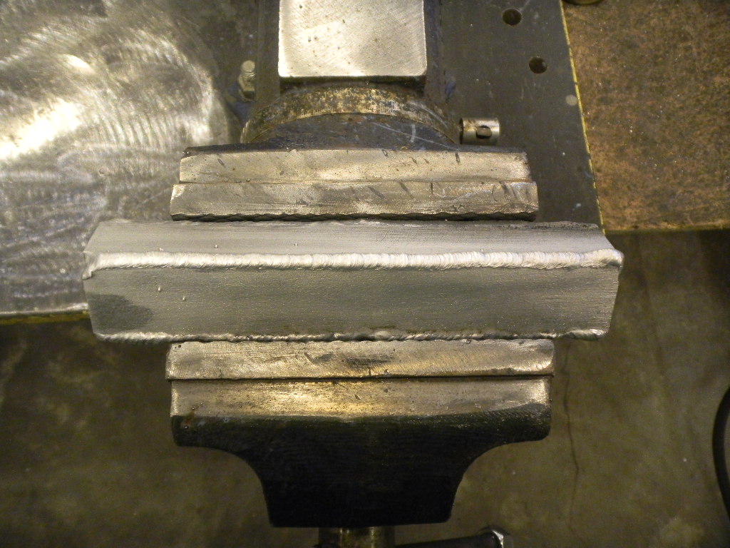

This Tig weld on aluminum was done on DC, with 100% helium.

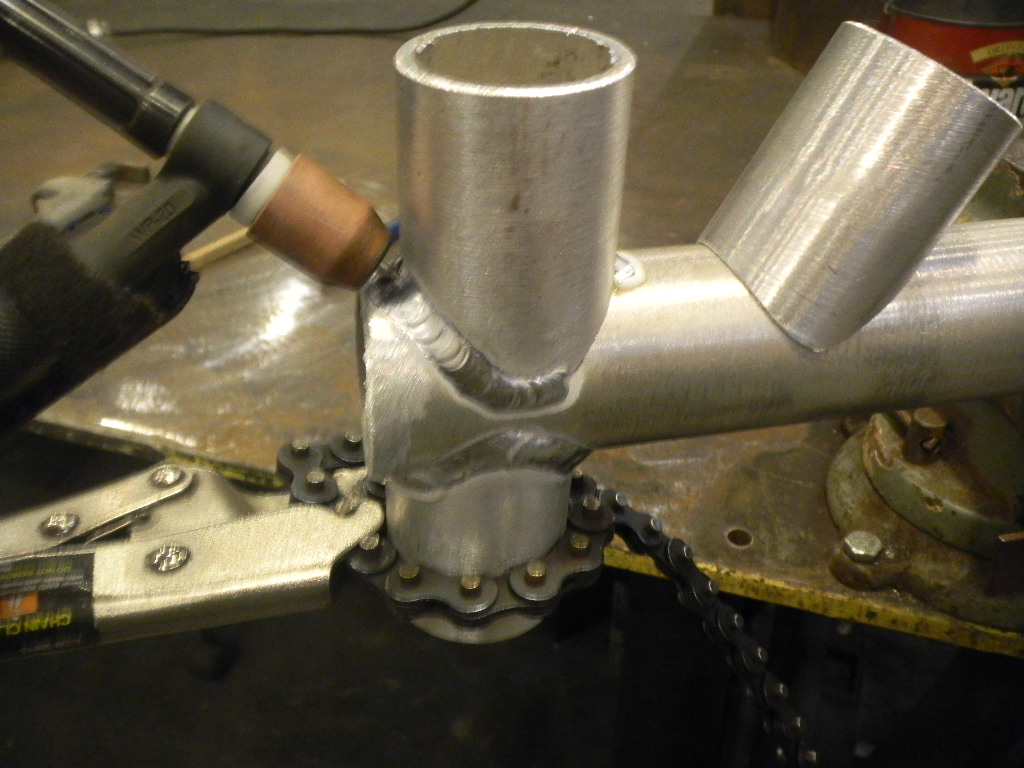

This aluminum weld was made with one of my Everlast stick welders with 100% argon, and a Tig rig. Without a foot pedal you can only make short welds. No way to back off the power as the aluminum gets hot.
489283d1480106698-bought-miller-multimatic-200-a-100-helium-jpg
I would be very happy with that weld. That doesn't look like other folks' descriptions of DC TIG on Aluminum.

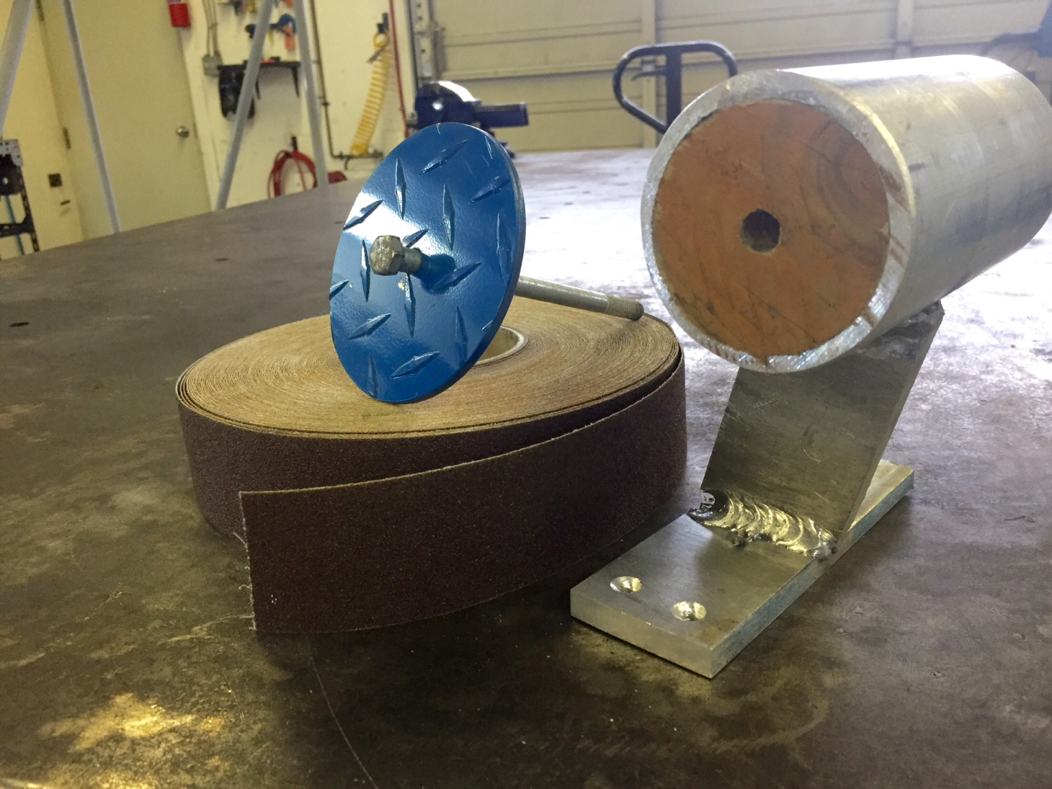

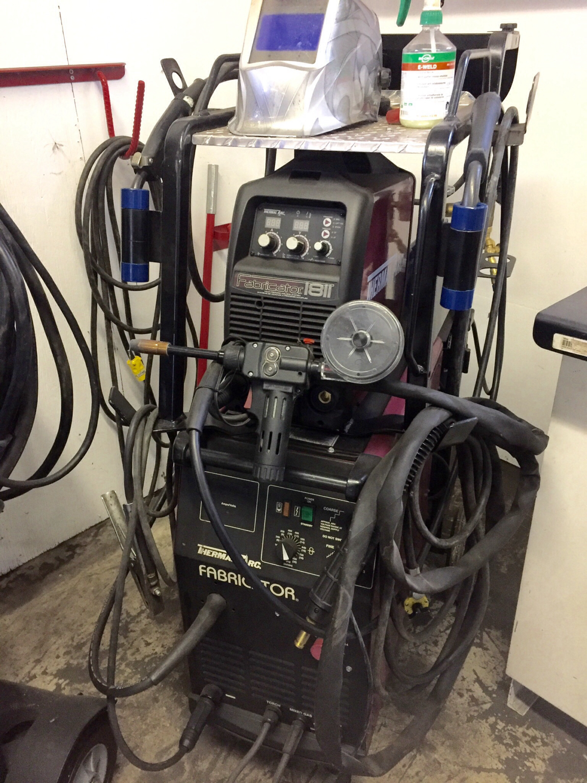

Sodo (Dragoneggs and others) I can only ASSUME my Tweco spool gun for my Thermal Arc 181i is similar to your Spoolmates.
Here's my first mini project 3 years ago when I bought it. 1/4" (pushing the limits obviously by the looks of it) material for a wall mount spool holder for rolls of emery cloth. 650 IPM. 24.9 volts. Inductance set at 1.
I would HIGHLY recommend looking into the spool gun modifications BuckitCase referenced.
These days I only use this setup for light materials such as the .100 bright tread aluminum plate I use to fabricate belt guards.
Okay, guys. Hope that's some incentive to grab a bottle of argon. :)

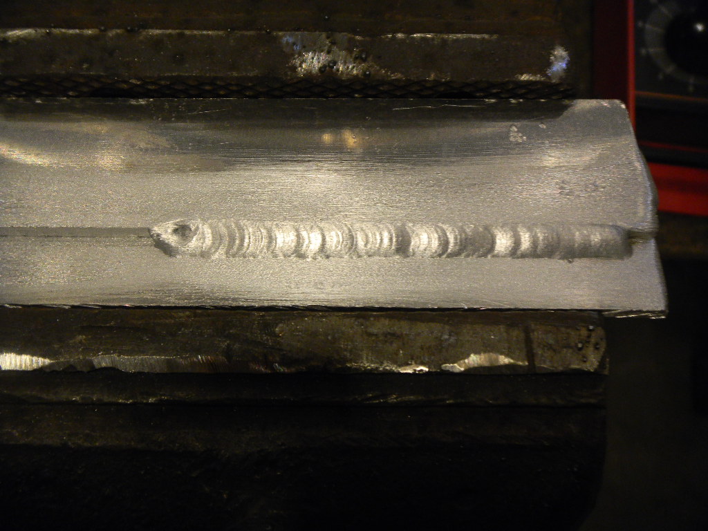

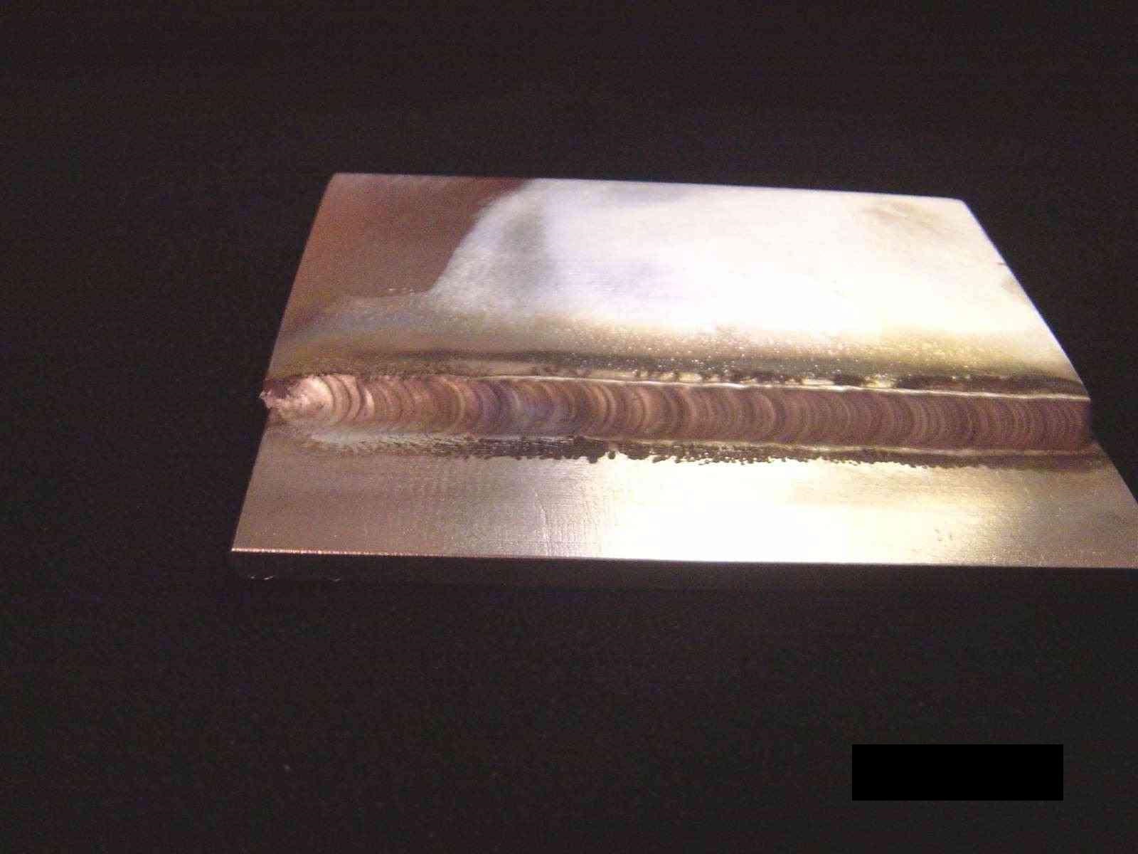

This weld is on one of the thicker aluminum plates I made.
This was playing with the pulse on the Lincoln V350-Pro. I did not whip at all! The ripples are all pulse. 3/64" 5356 wire.
/ Bought a Miller Multimatic 200 #79
That looks REALLY nice! I haven't played with pulse on mine enough to really get it dialled in yet.
