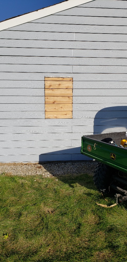

I need to board up a 24" wide window in an unheated garage for the winter.
The window frame has deteriorated badly. Only paint is holding it together in some spots.
What type of material is recommended for this?
Here is an old pic of the building.

After reading all the posts and looking at the forecast, I went to Menards yesterday and bought some ceder 8" siding. That great big you-fix-it store doesn't sell any thing to match what I have.
The only beveled siding they sell is ceder. Everything else is ship-lap.
If I can get the glass out without breaking it or bleeding, the rest should just about fall out with a little nudge. So with my luck, I'll be working till dark just to get the old window out today.

Mission Accomplished.
And it took only 3 hours, but I still need to clean up a little.
/ Boarding up windows #16
Looks good. A little bit of paint will blend that right in.
