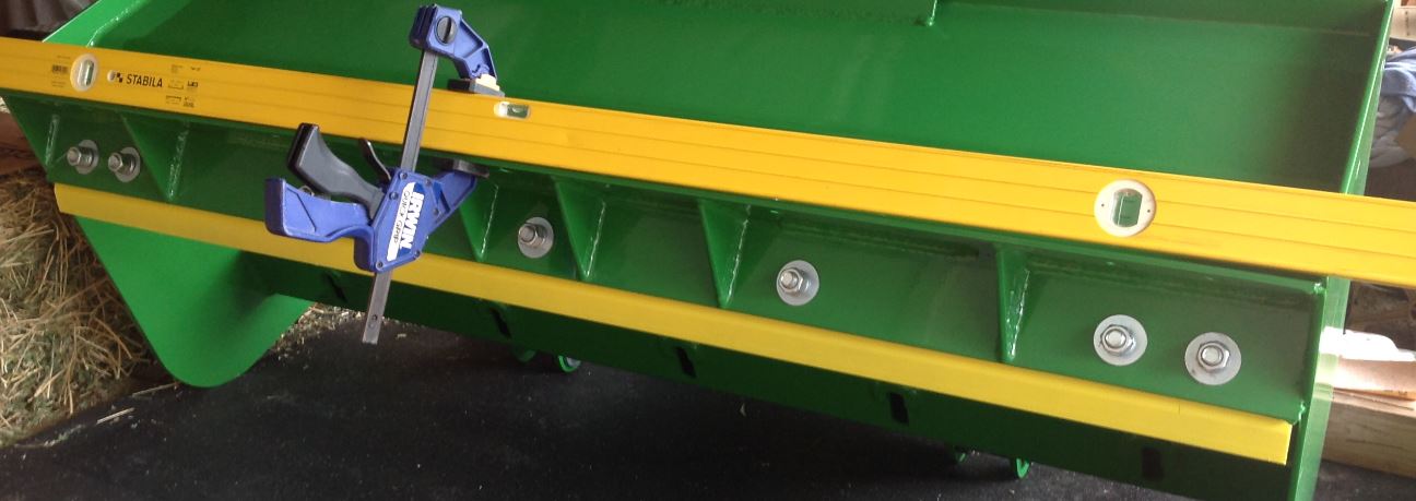

Thanks for posting the additional pics catman8. So with the cutters bolted on solid, the edge of each is now arched?

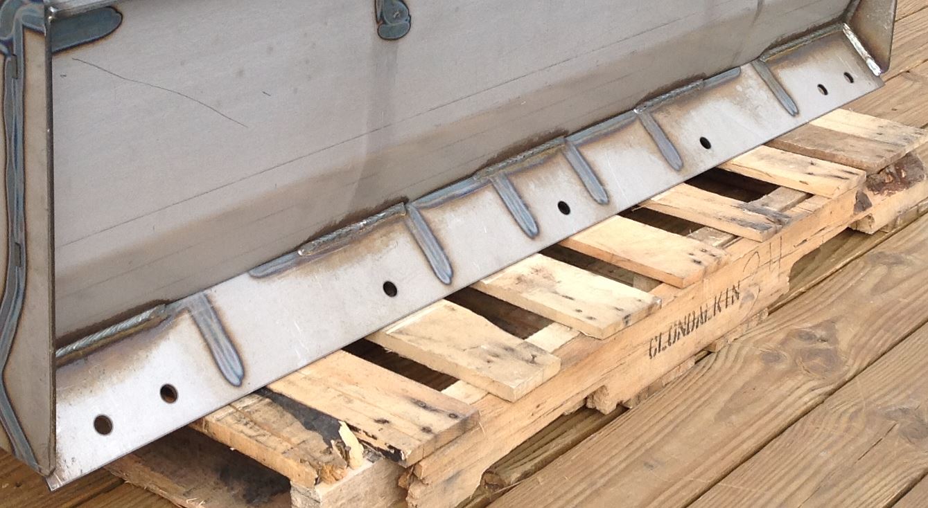

I was at the Farm store today and they happened to have a BB laying on it's face so I snapped a couple pics.
I like these pics. It gives me a good opportunity to point out some structural differences.
The first thing that catches my eye is no bracing on the piece of angle iron. Yes, after looking, angle iron is the second thing.
The front cutting edge and what it's bolted to is the highest stress point of all on the box blade. Rather than welding a piece of angle iron to the bottom of a flat piece of steel which is the moldboard on the yellow box blade, our front moldboard is one solid, formed piece. The moldboard, tabs and holes are cut with the laser and formed in our press brake.

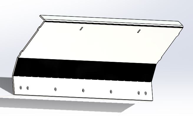

Here is the 60" EA 30-70 Box Blade(catman's) front moldboard:
Now that the front is taken care of and extremely strong and rigid, the rear piece of flat steel is added and triangular braces are welded in between, which creates the durable attachment point for the back cutting edge. Not a single one bent to date.

I was thinking of something else, and i'll think it out loud for a moment. The bottom of the box blade looks totally flat here on the pallet:
Is it the location of the straight edge that makes it look worse. Is the angle of the straight edge totally relevant to the position of the piece when it is lying flat on the ground?
It is hard to imagine without actually being hands on with one minus cutting edges.
I'm not entirely excusing the minor bow, but I do think it is well within tolerance. There's way more to our box blades than meets the eye. I've only covered the moldboard so far!

These are some good pictures. To me, it appears there is a 1/8" bow to the flat surface of the rear blade mount. After mounting the blade and setting the box blade flat, that should equate to 1/16" bow (both edges touching and 1/16" gap in the center). That's all that matters is how flat it sits on the ground, not the bow at a 45* angle.

Travis, when you say the edge that's sitting on the pallet looks straight, that edge is irrelevant. What matters is the flat area where the blade mounts, if that surface is not flat across the intire length it will bow the blade resulting in a cutting edge that's not flat. I will agree with you that EA design is nice, and the reinforcing shows that, the steel you use is top notch and the welds are beautiful.
I think the question we all want to know is there a way to weld your box blade together to alleviate the area that the blade affixes too from warping when you weld it. I think that area is critical to keeping the blade flat. If EA thinks this area being bowed is within tolerance and it's bending the blade where you no longer have a straight edge, that can't possibly be within tolerance. If you went into a hardware store and bought a framing square you would expect it to be square. We are all humans and we do make mistakes and we all heard the saying you must of got that one build on a Friday at 5:00pm :drink: Travis, is it possible to keep that area flat or is there just to many welds to keep that from warping.

I am curious to see the box, cutting edges installed, sitting on a level surface just as everyone see one on a dealers lot, showroom floor, aerospace museum and/or tractor show.

Holy moly, 78 posts arguing over how straight a box blade edge should be, and we still haven't seen a picture of the blade on the ground. Catman8, to be fair to any equipment manufacturer, you can't compare the tolerances of a builders square to a box blade. Unless you plan to frame structures with that box blade. ;)
Put the blade on it and see how close to 'flat' the blade sits on the ground. Then go move some dirt and enjoy it. :thumbsup:
