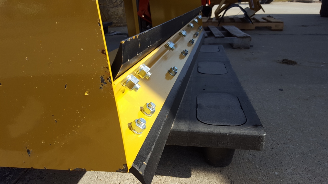

Hello TBN members, need some advice. Owners of box blades: How straight, flat, or parallel do you expect your blades to be. I bought a new box blade and when I bolted the blades to the box they have a curve to them along the length, if I was to hold a level on the bottom of the blade it is not flat. Is this anything to be concerned about or do the blades get ground flat when you use then. I have no experience with box blades so you input is appreciated.
Question I have for you all, did you check your box blade to see if the blade was flat or are you just assuming it is. My opinion is that it should be dead flat since you're using it for grading purposes, but I don't know what the industry standard is.
Getting back to the original question and thinking back over the times that I have used box blades over the last 32 years, a blade with a curve of up to an inch in the middle would not be a problem in the finished result.

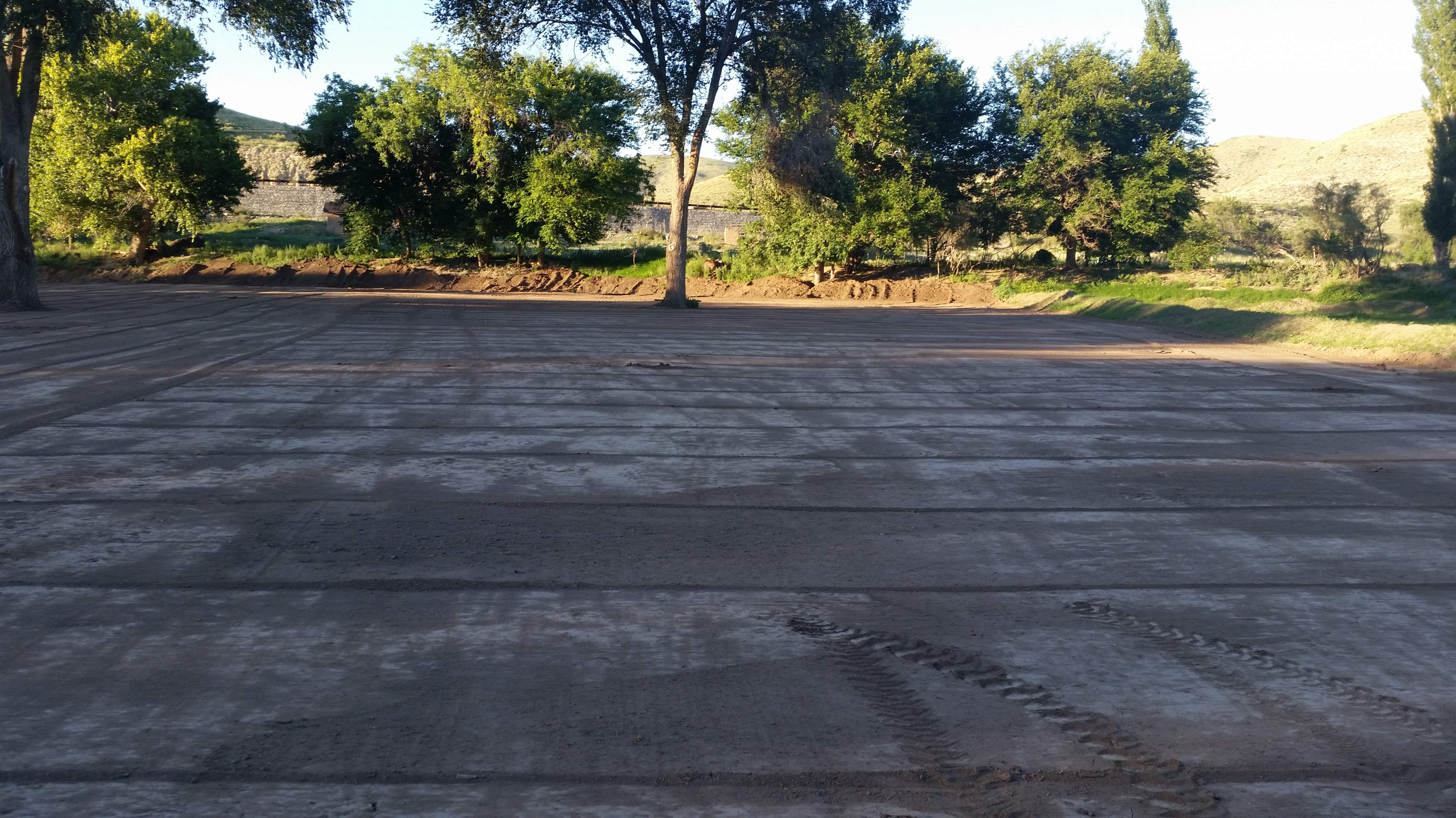

I don't know what you will be using yours for, but here are some of my uses:
Can you tell if the blade is curved?
/ Blades on a box blade
#103
Hello XFaxman, from those pictures, no I cannot see a curve.

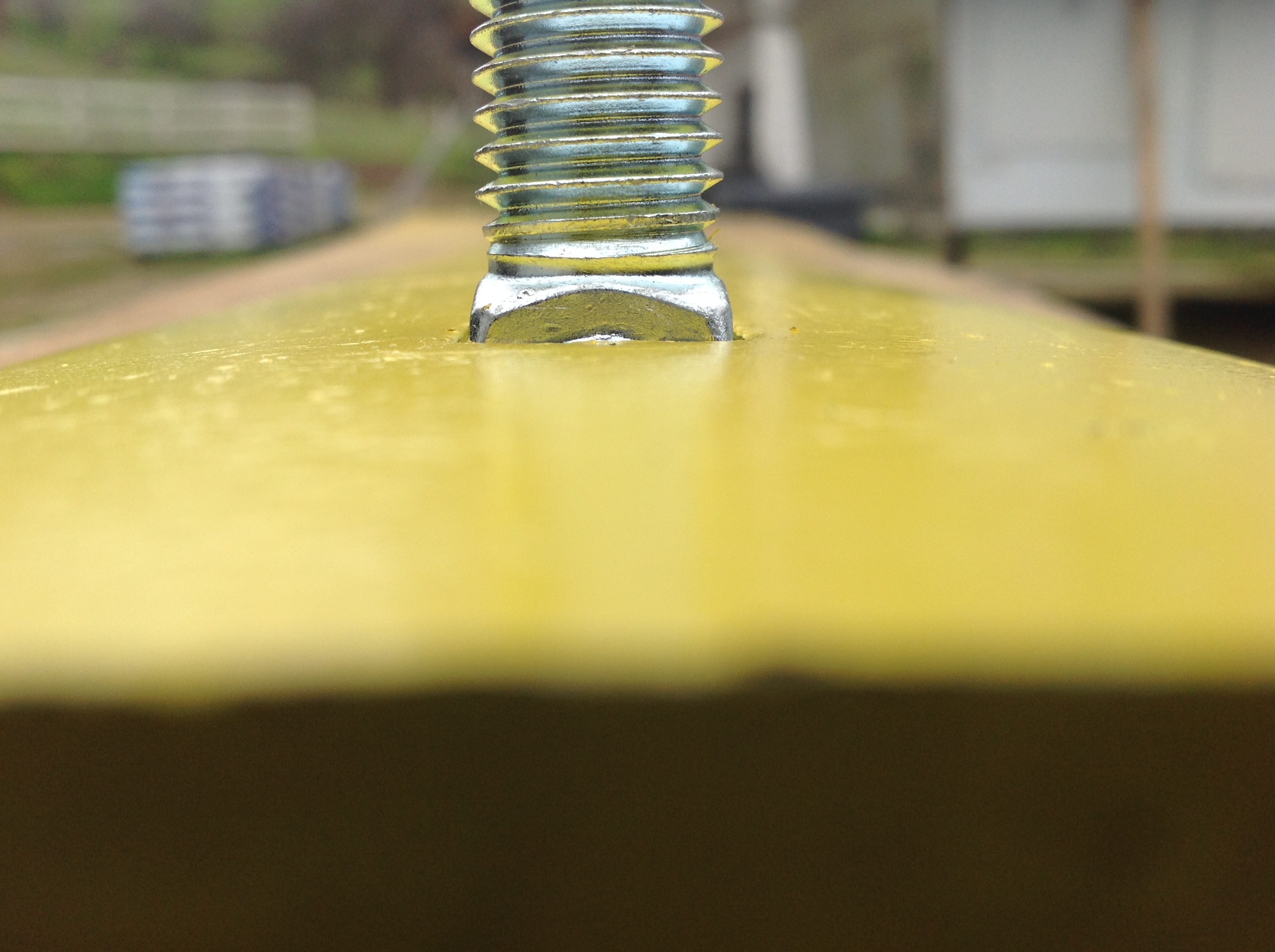

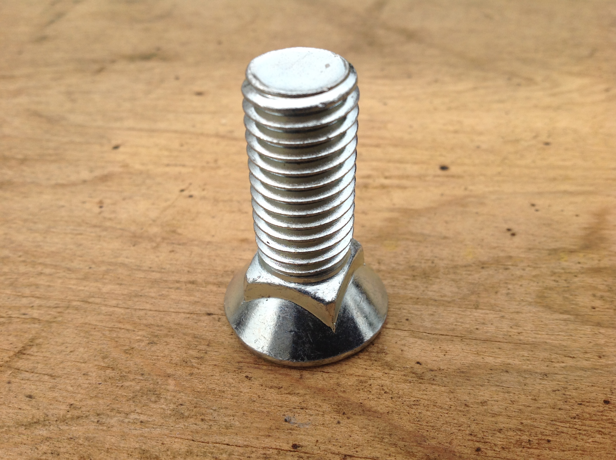

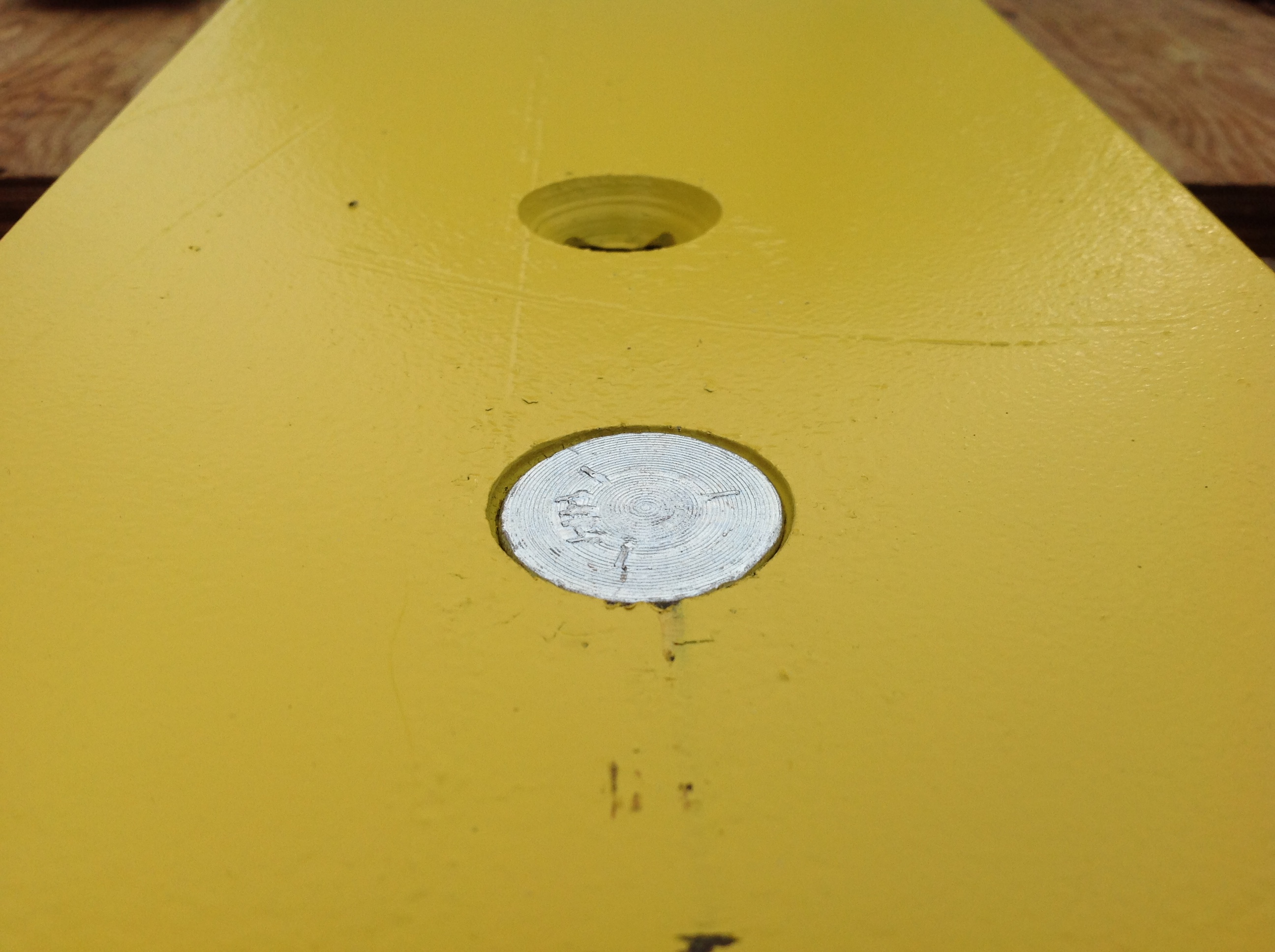

Need some info: I was about to mount the second blade on my box scraper and noticed that the square portion of the bolt will not fit through the hole in the box scraper and if you match up the square part of the bolt with the square part of the hole in the blade, the square part of the bolt extends out the back side of the blade and bottoms out on the hole before the blade and box scraper make contact.
I wouldn't think that they would want you to suck that square part of the bolt through the round hole, that is pretty thick steel. If you don't match up the square you will be able to tighten them up flush but the whole point of the square is to keep it from spinning. Anyone have any suggestions.

Yes EA did supply the bolts, I think why I was able to mount it up flush the first time is because I did not notice the squares not lining up so as I did my final tightening the bolt spun, the squares aligned and the bolt got loose, then I noticed the problem.
/ Blades on a box blade #108

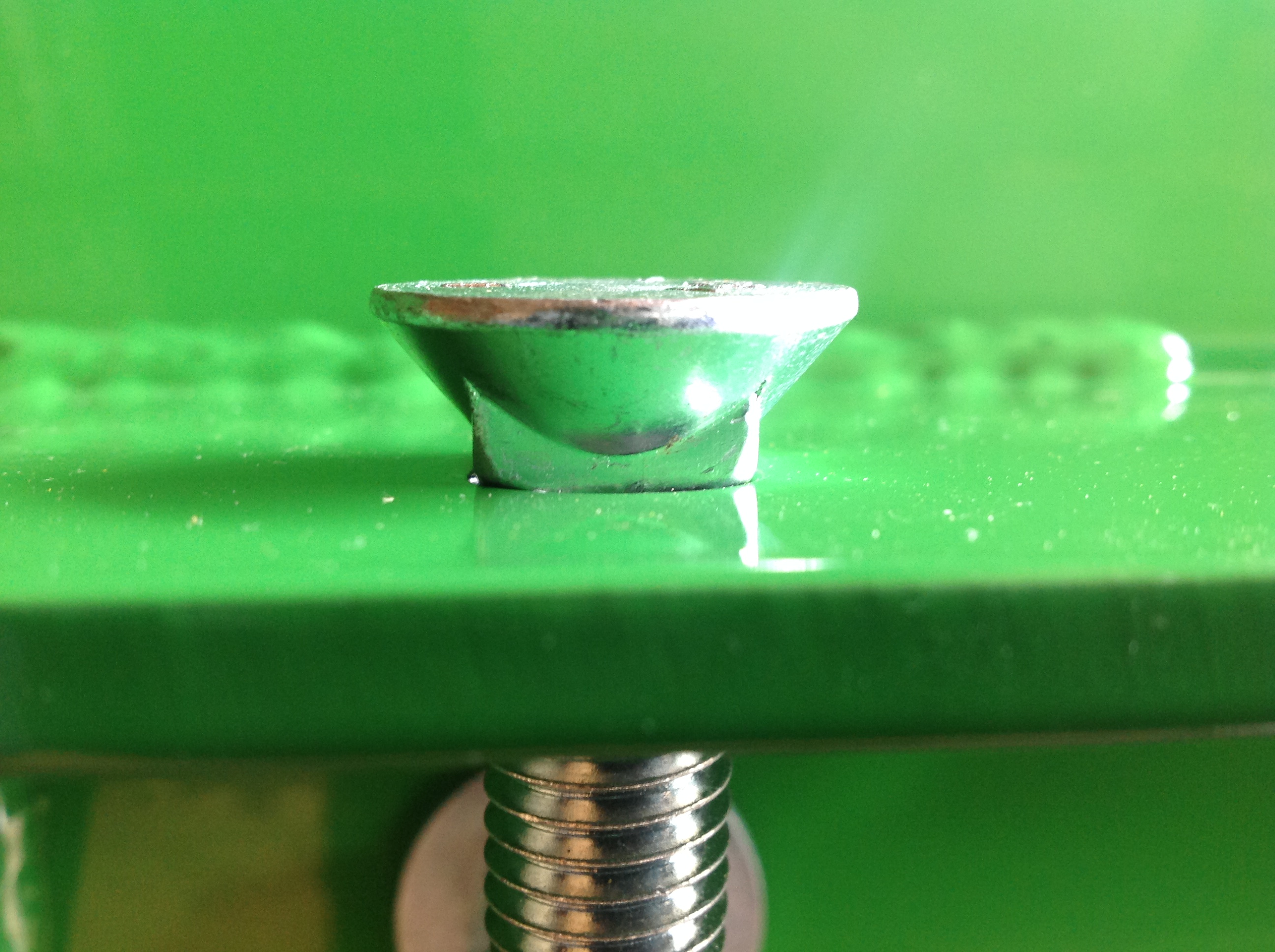

Is it possible the bolts are a size too small???
This would allow the head to go farther into the cutter??
Do they fit the hole in the frame as they should?
/ Blades on a box blade #109
In other words, can you scrounge up a larger size bolt and stick it thru the hole in the frame?

When the bolt is in the yellow blade, how far from the surface of the blade is the top of the head? To me it almost looks like the holes are to deep in the blade.
Just saw your pic. Looks good to me.
When the bolts started sucking up tight they did look like they were getting sucked below the surface more than they should be
/ Blades on a box blade #113
Those bolts look right in the cutter. They also appear to be the right size for the hole punched in the frame.
Sorry, I don't have an answer for this problem. But it has to be addressed.
Maybe take a bolt with you to the hardware store and compare it to the bolts they have. These are called "plow bolts". Not sounding condescending, just clarifying. What I would be looking at is the depth of the square portion. Maybe you can find a set of bolts that won't extend thru the cutters. :(

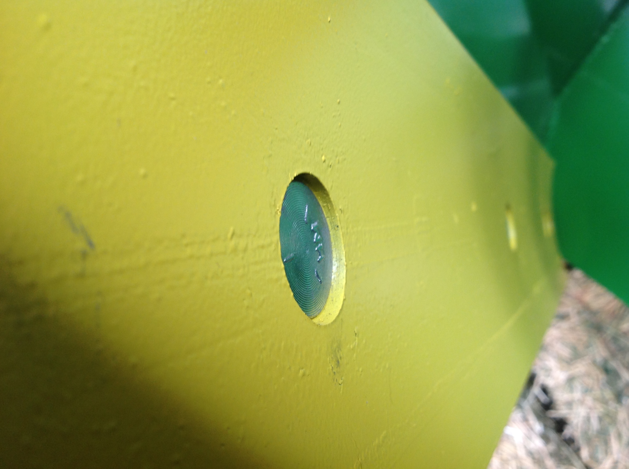

Powder coat is much thicker than paint. You may have to remove it from the holes to get the bolts to seat.
Are you sure the curve in the one blade is not due to mis fit from the powder coat?
/ Blades on a box blade #115
This problem is NOT caused by powder coat.
The problem is the bolts are seating too deeply.

Thanks for your suggestions but this is looking like an issue of the holes being drilled to deep in the blades.
Wet paints are applied in thicknesses of 0.5 to 1 mil (a mil is one one-thousandths of an inch, or 0.001-inch). Powder coat is applied in thicknesses of 2 to 6 mils for decorative finishes or 6 to 10 mils (and thicker) for functional finishes.
