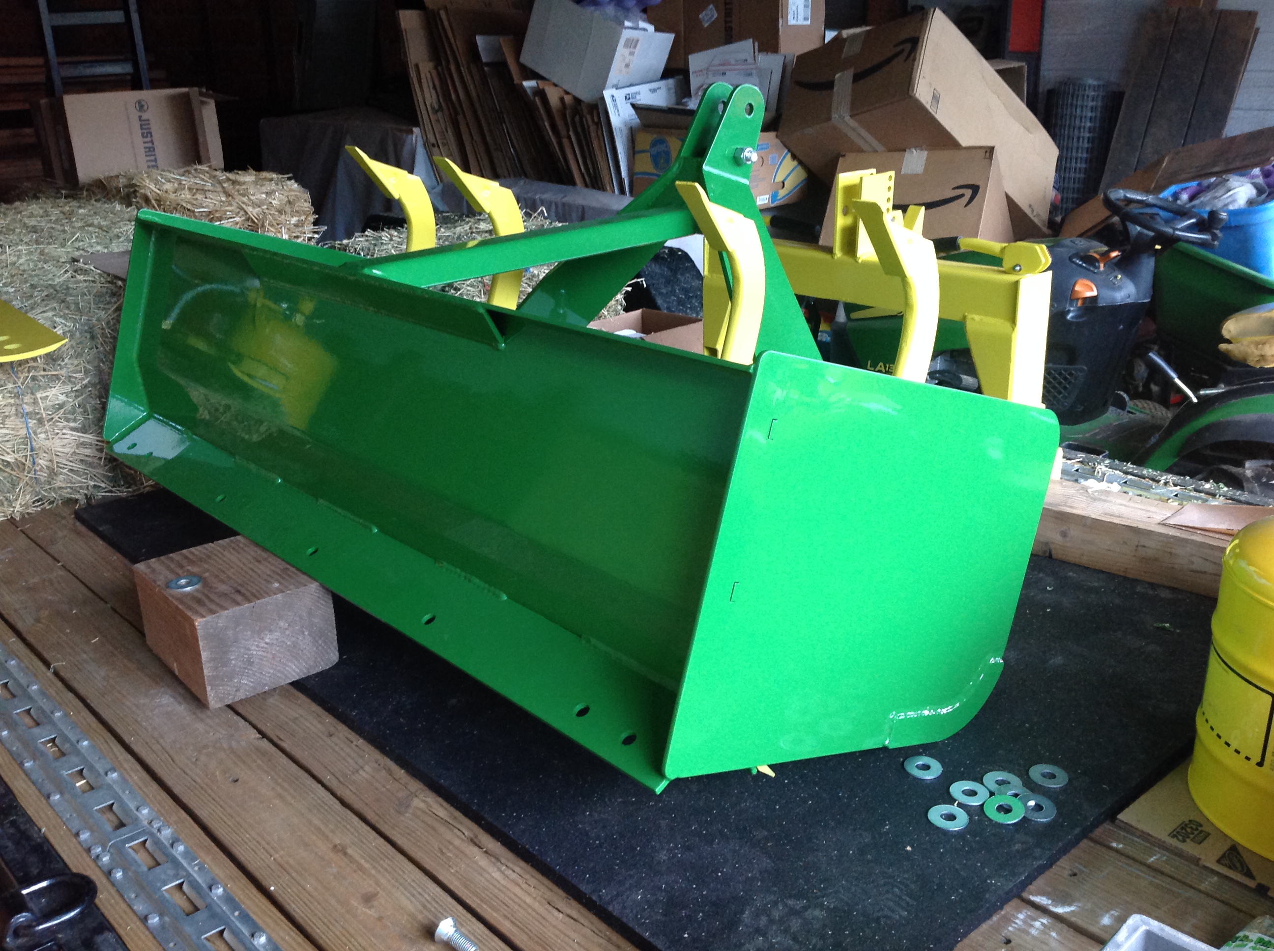

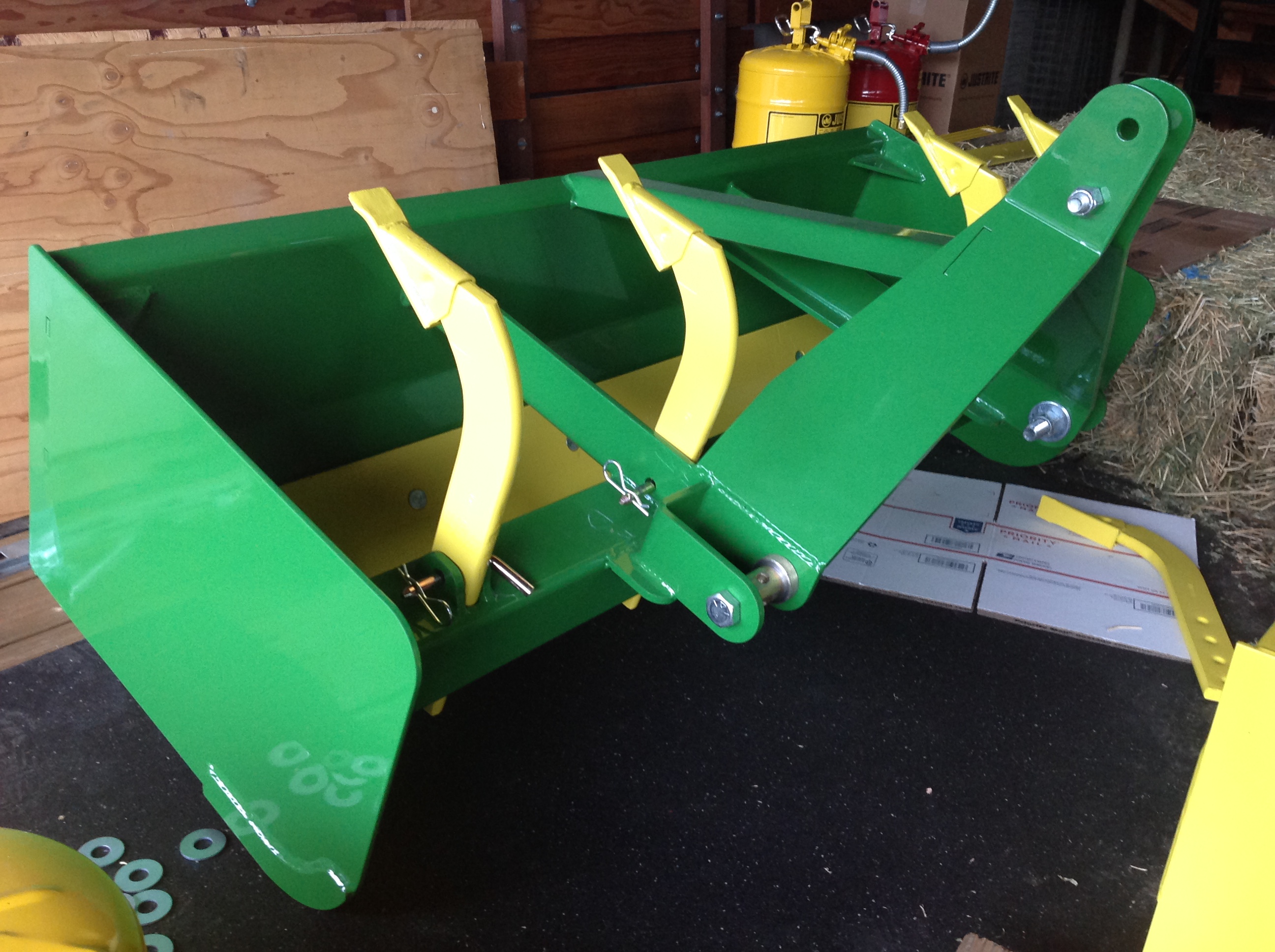

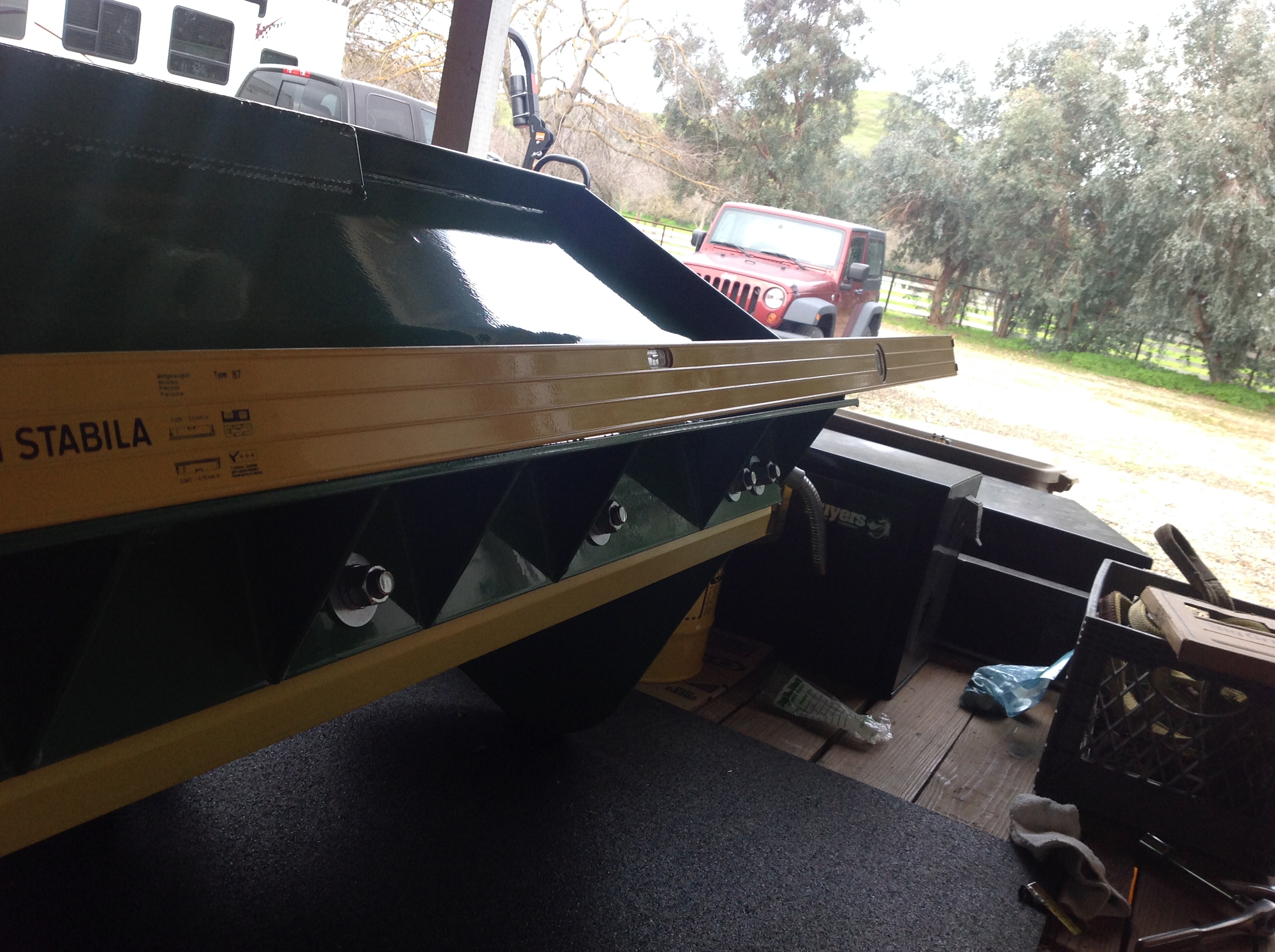

Looks like the unit may have been tweaked while building, or perhaps shipping (harder to see it if there is no paint on the box - normally would see chipped/scratched paint Etc.. when it arrived if it happened in shipping)
I will say the Aerator I bought from EA is straight, everything seems to line up perfect and is very nicely made. I certainly wouldn't let one problem here and there worry me. There is a lot of things that can and do go wrong and it is sometimes very hard to tell what really happened. I personally believe EA is just trying to understand better what is exactly wrong and looking at different photos taken different ways can sometimes help determine an issue. Don't believe they are calling anyone out or trying to get out of anything. If it was my business I would want to look any photos I could get to see what happened. That really is the most effective way to find the problem and figure out how to correct it without putting anyone out too much.
/ Blades on a box blade #83

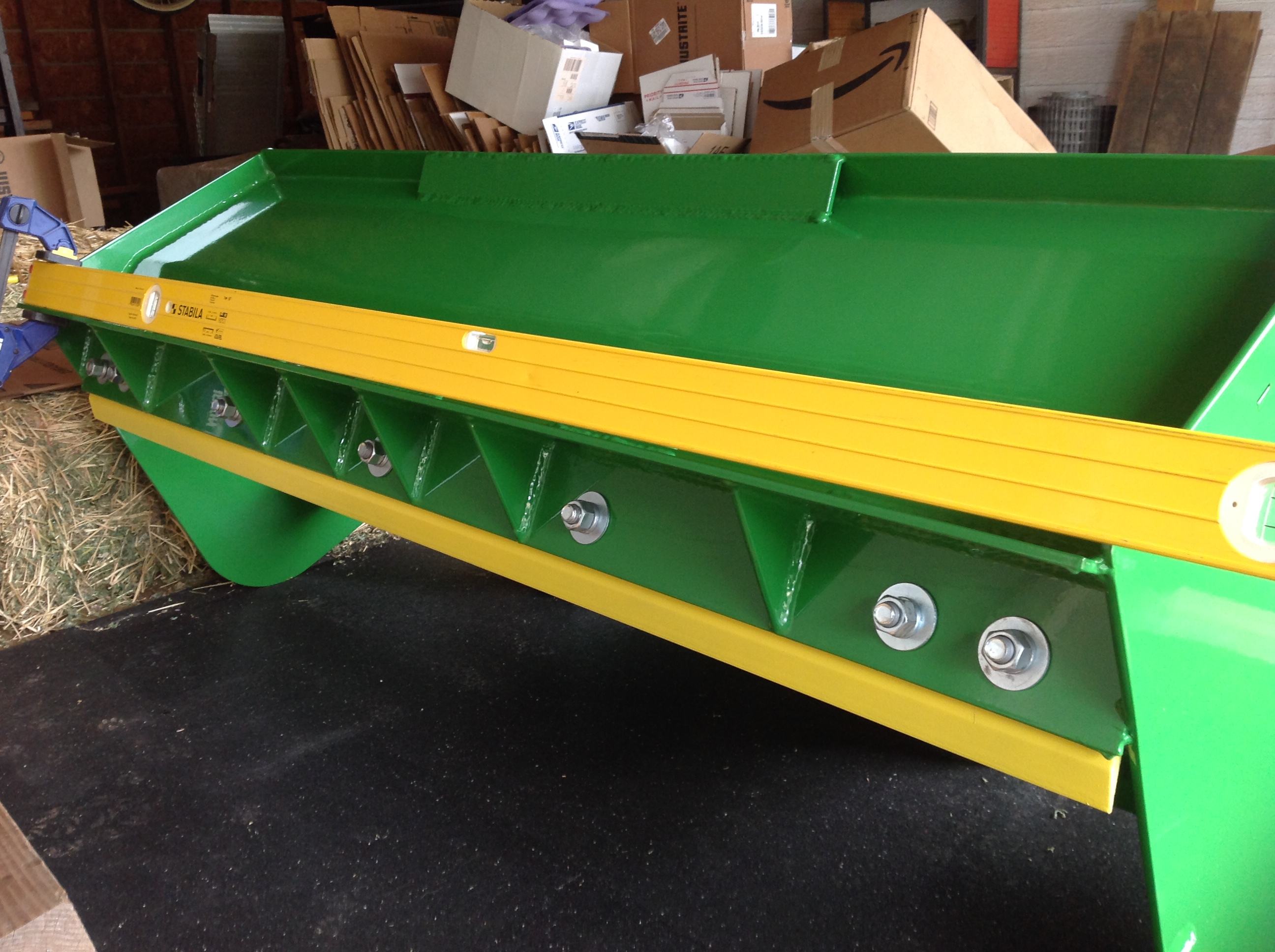

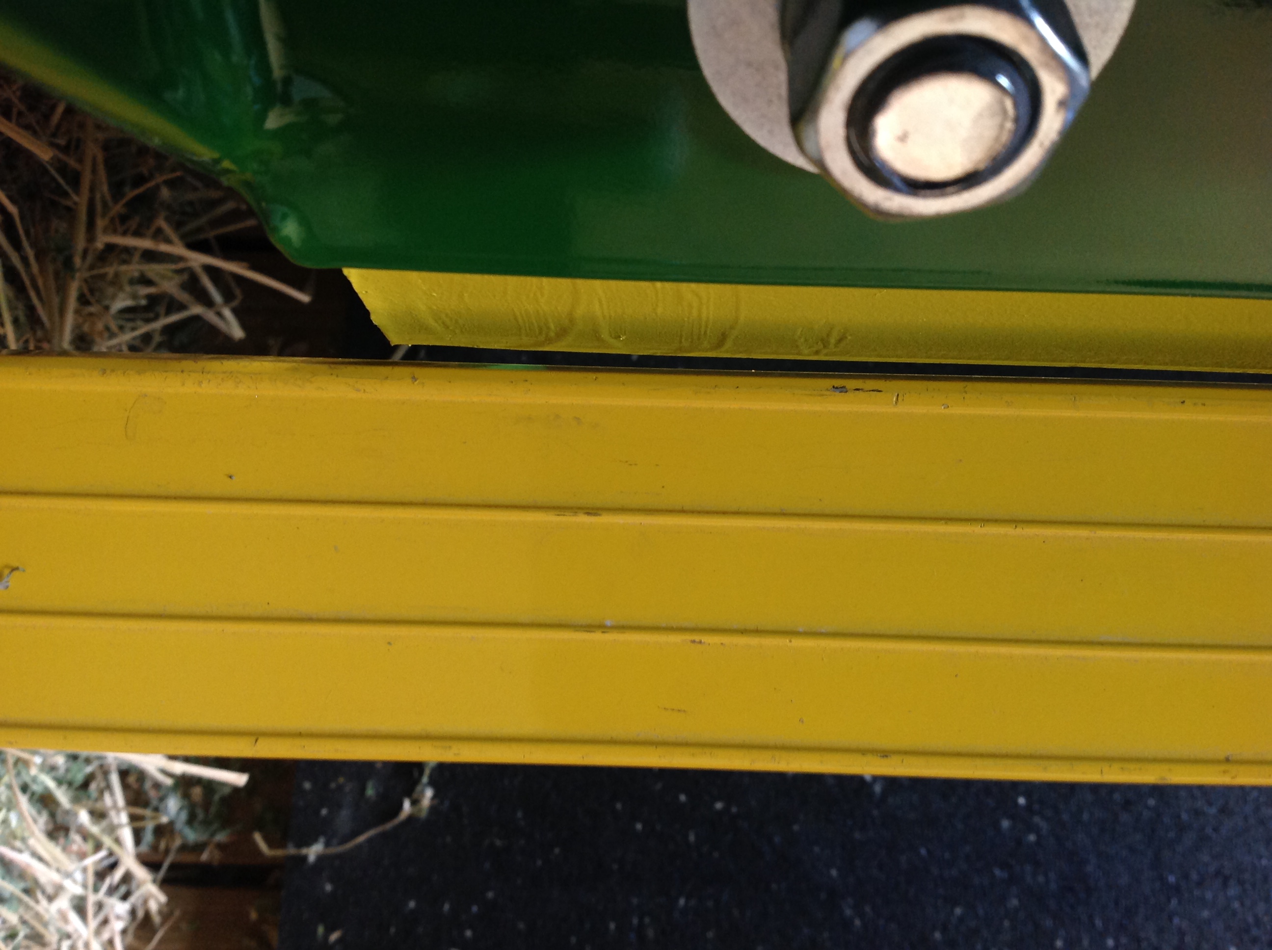

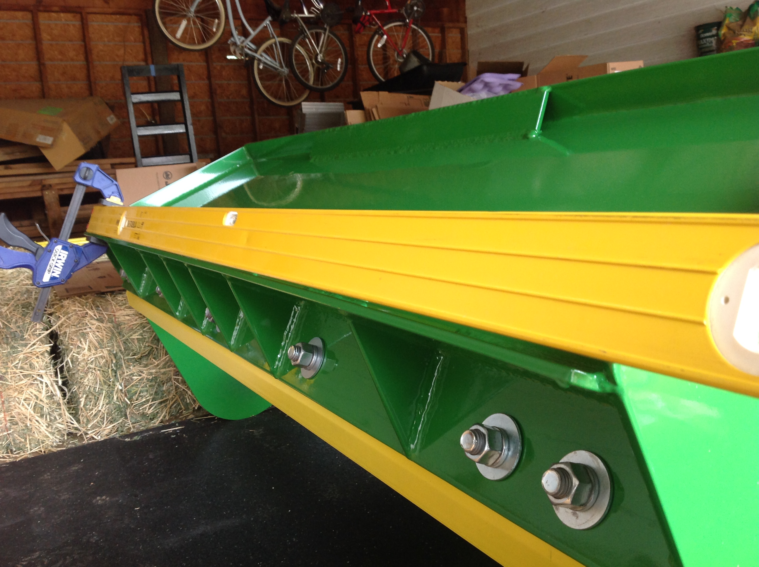

The top link holes, while disturbing to a new owner, won't make a bit of difference. Why won't it make a difference? Because the 3pt top link has a ball end on it that will align on any angle, and adjustments can be made in the side links if needed. Most folks with box blades know this.

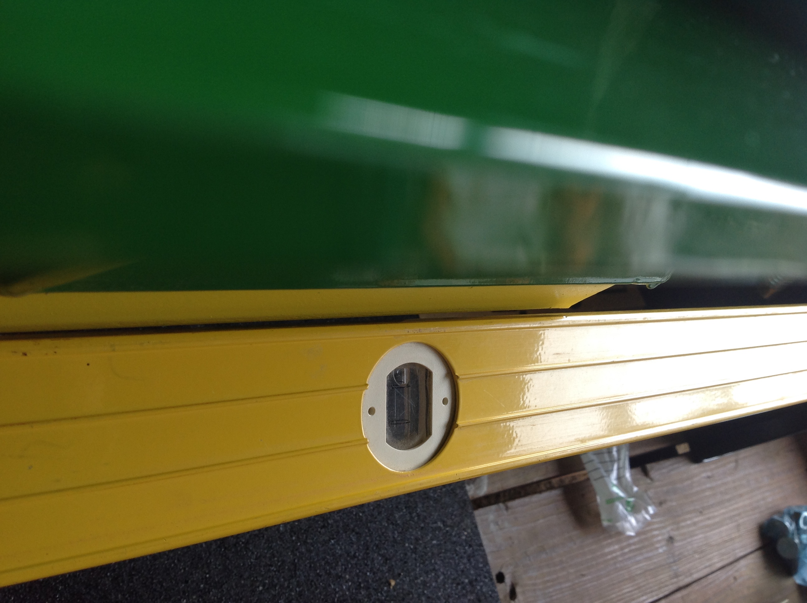

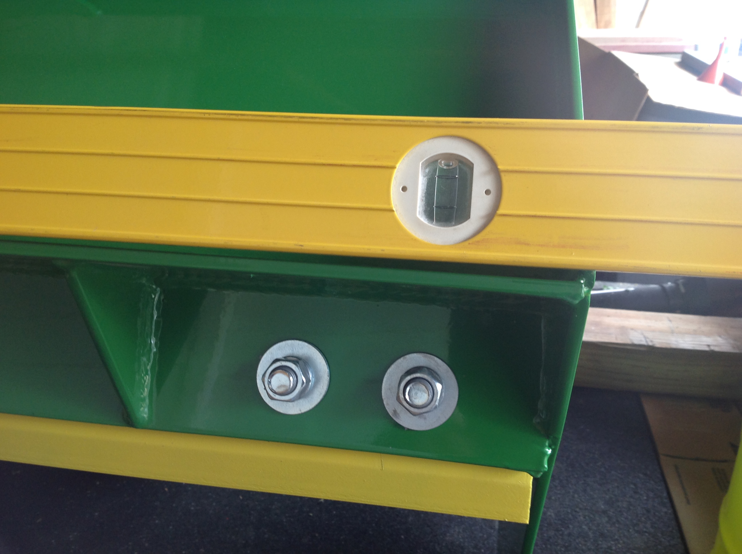

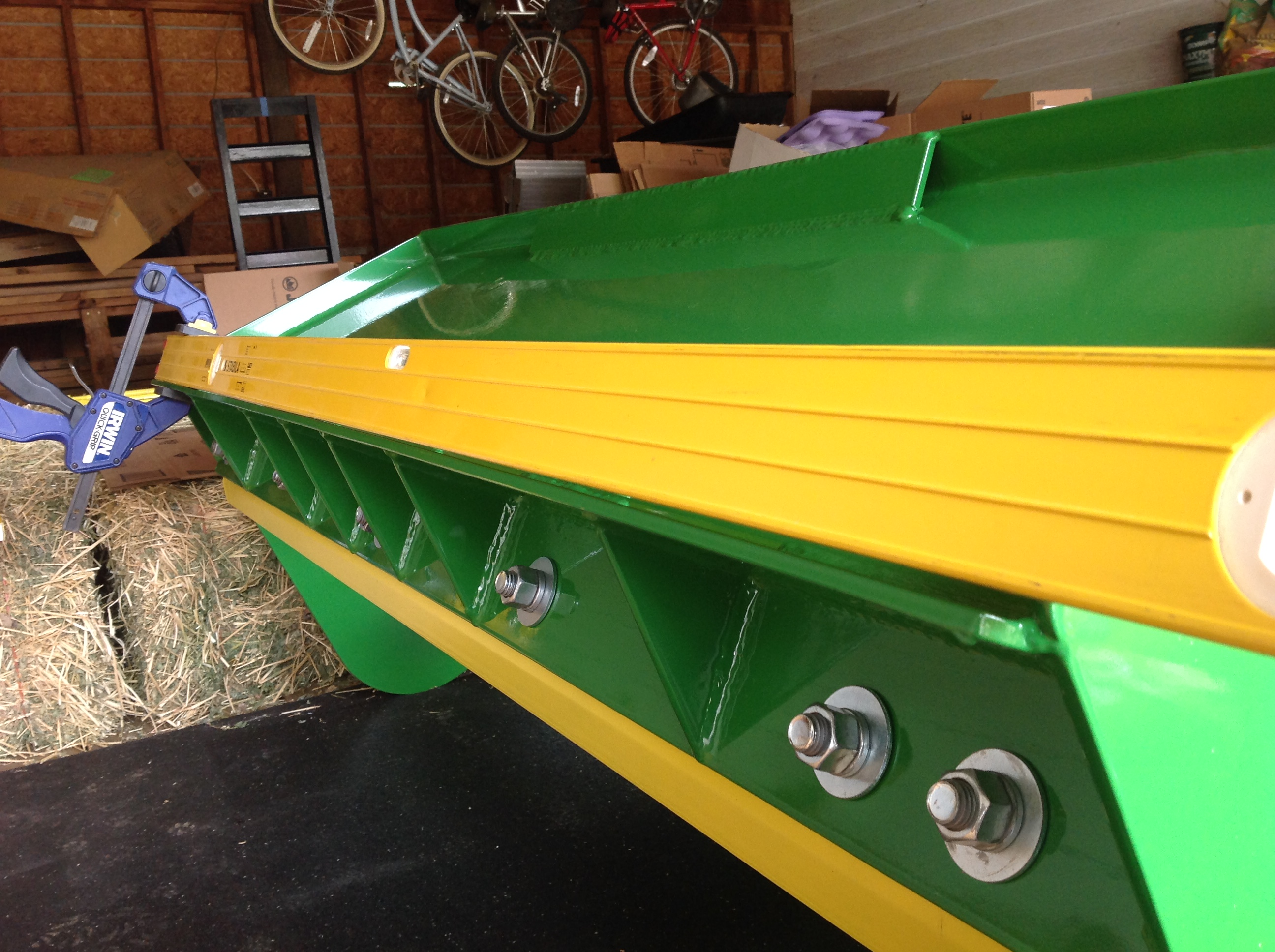

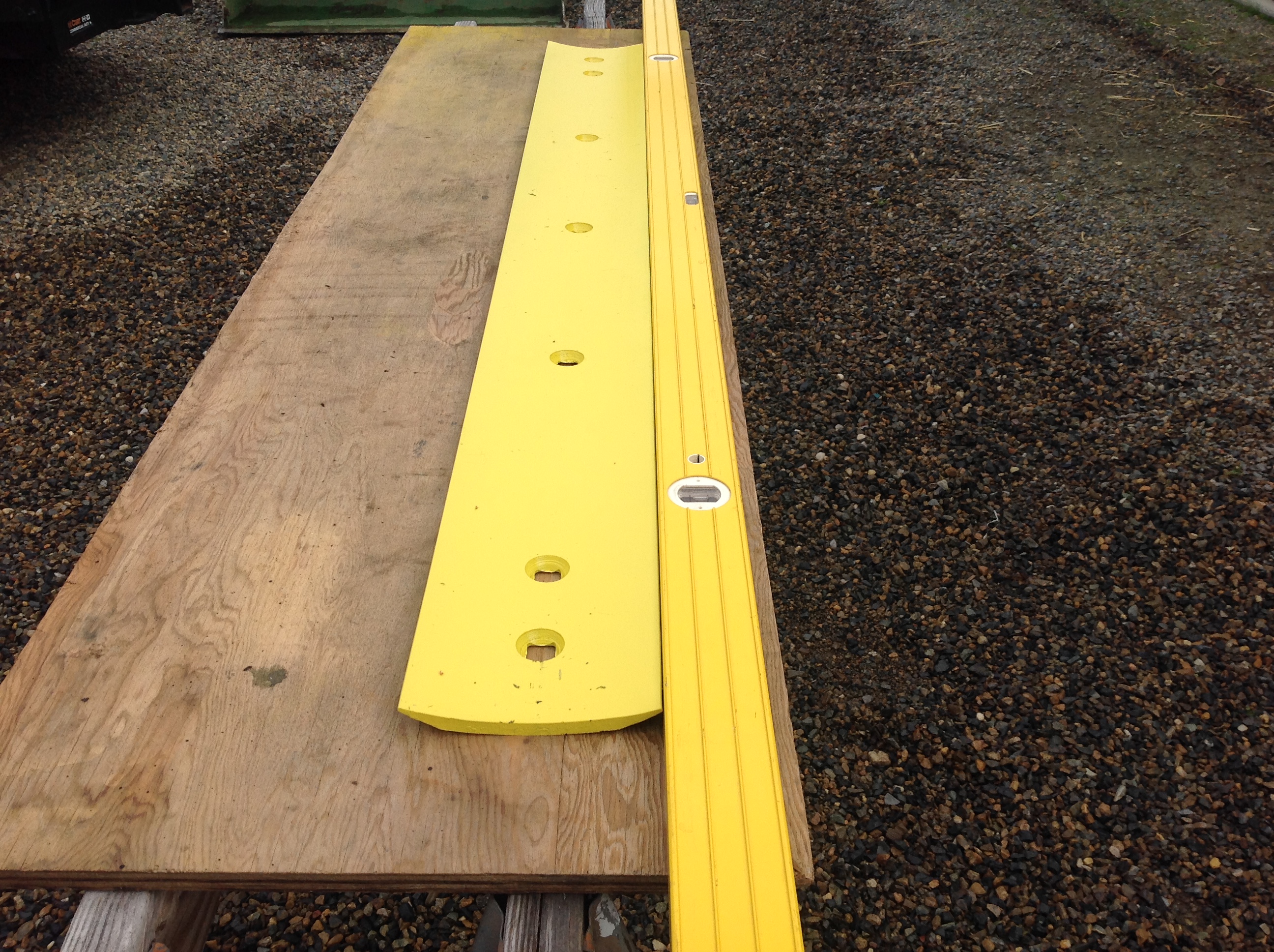

As for the curvature issue in the original post, it is extremely minor. Extremely! You could get worse results if one of your rear tires is a couple PSI different from the other. After you do your field or road leveling for the 5th or 6th time and you still have washboard results, and you come to the realization that the implement moves up and down with the hills and valleys and won't stay level, and the tractor goes over the undulation of the land adding another axis of movement to the mix, and you come to realize you can't operate a box blade for beans just like most of us can't either.... you won't be able to see the results of maybe 1/8" to 1/4" of offage in the blade over a 5' width. :laughing:
You're looking at the curvature at a 90 degree angle perpendicular to the cutting blade. It will be much less of a difference when the blades are mounted and is sitting on level ground.

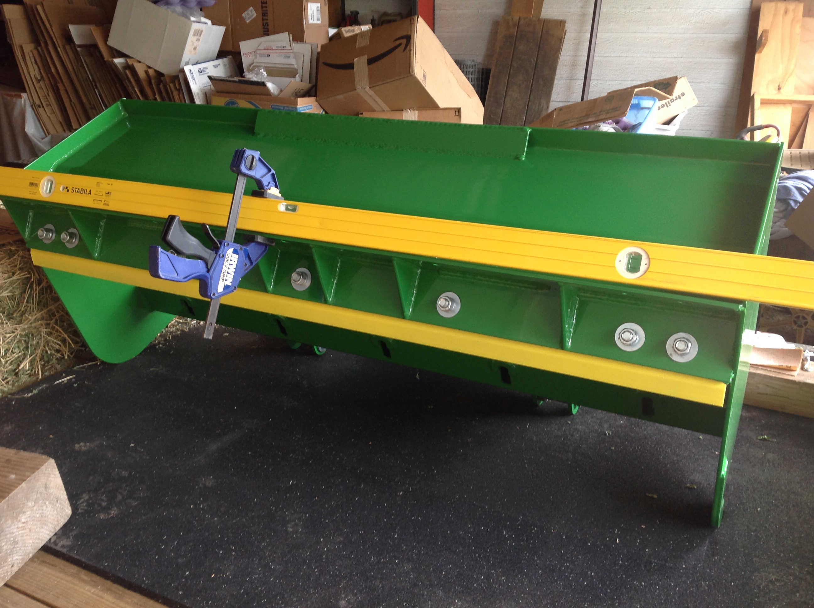

I suggest you mount the blade (s), but not real tight. Set the box down on a flat surface to get them squared up between all four ends of the blades, then tighten them up. THEN measure the gaps from the flat surface to the blade and take some pictures. Any gaps will be smaller and quite acceptable, I would think.
That is a beautiful powder coating! :thumbsup: Get the blades mounted up, square to each other on a flat surface, tightened down and see how it goes. :thumbsup:

From reading a lot of people's post I can tell that they are not understanding the geometry involved, and I just thought of a way to explain it to you.
Take a piece of paper That will represent a blade, hold that paper 90 deg. To the top of a table and then curve the paper, the cutting edge remains flat to the table, now take that curved piece of paper and slant it back on an angle and now you see it's no longer flat to the table. That is what will happen to any blade that does not have a flat area to mount too. On this box blade the (V) portion is not mounted crooked, both sides of the (V) are dished, and the result will be each pass you make in the dirt will be dished. So putting the blades on and trying to adjust them straight would be impossible because as soon as you suck those bolts tight you curve the blade, and from my example with the sheet of paper it's very easy to understand.
The box blade was never damaged in shipping because there was not a mark on it.
