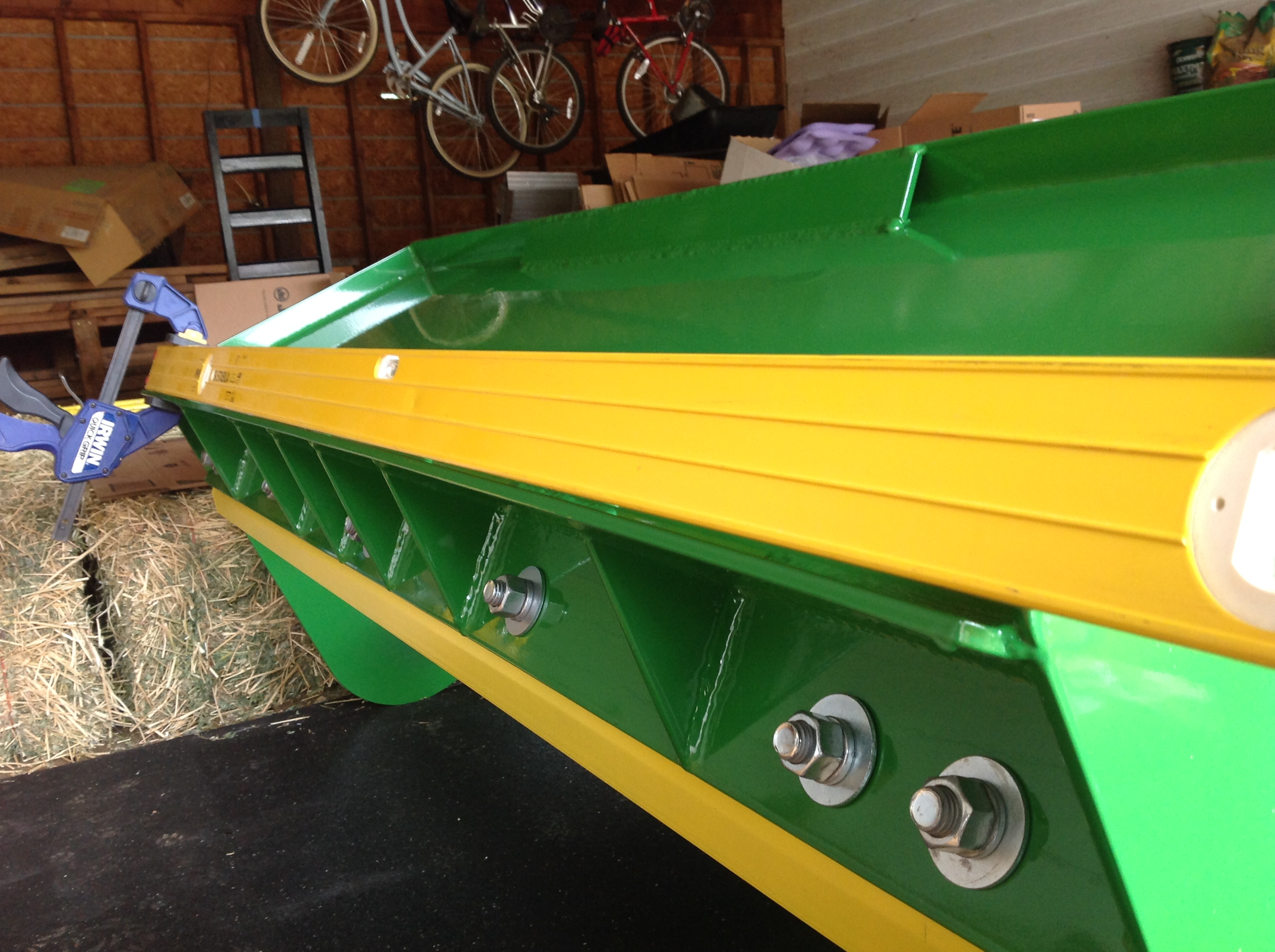

The blade is straight, the box blade is bowed about 1/4". When the blade is mounted its bowed about an 1/8" on both sides.

Thanks for posting the additional pics catman8. So with the cutters bolted on solid, the edge of each is now arched?

Thanks for the photos, I wish you would of laid a flat level on that edge so we could see. I am familiar with welding and know all to well the affects it has on steel, warping, bending. I notice all the extra bracing on the EA compared to the one in your pic, trying to control the part from warping with all those welding beads is probable very hard. If you ever welded you know what I mean.
Yes, they are both arched when bolted on tight.

Thanks for the photos, I am familiar with welding and know all to well the affects it has on steel, warping, bending. I notice all the extra bracing on the EA compared to the one in your pic, trying to control the part from warping with all those welding beads is probable very hard. If you ever welded you know what I mean.
Yep. I fabricate a lot. Extremely hard to control warping, especially with a MIG.

Based on the photos it looks like a miss to me. It doesn't look warped- it looks like it was welded in crooked.
I now have a greater understanding of your disappointment/frustration since it has been powder coated. You are stuck between fabing some type of shim that doesn't create point loads or wrecking the paint to fix it. Bummer either way.

To me it looks like a mistake lining it up when welding, but a minor one at that. With the nice paint job I don't think I would worry about it at this point and use it. Can always adjust the side link a tiny bit to correct it....

Sorry I did not respond to your post I forgot to go back and reread it. Do you think it's ok to put washer on the bolt holes to shim it straight or do you think it needs shiming across the entire blade for support.
If I did anything to it I would use a couple of flat washers to shim it close enough. Then tighten it down and start using it. I would agree with others that this is a minor issue though and nothing to be concerned about.
If you are new to using box blades understand that it takes seat time to be proficient with them. Do not think for a minute that this warping will cause any problems with grading. With practice and patience a box blade can achieve good results +/- .25 inch.
