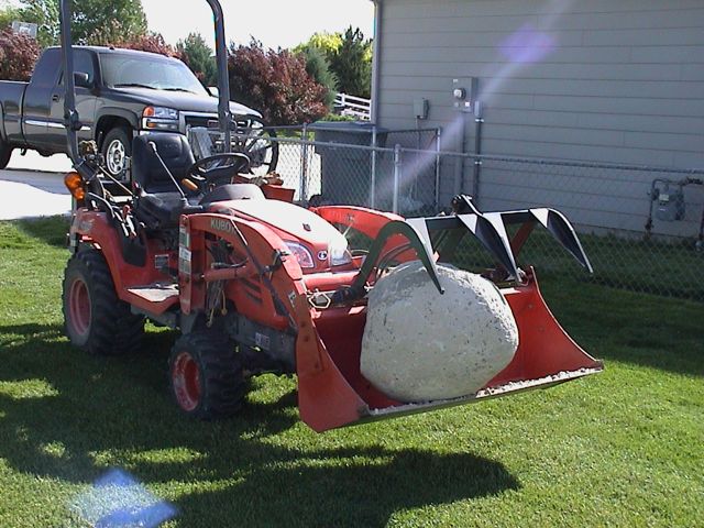

Here's a set of rock tongs that I built to move some stone around. The stone in the photo must be over 300 pounds. It lifted the front end of the tractor off the ground until I put the stabilizers down. There still some work to do, but it is almost ready. One thing that needs done is to lengthen the attachment that holds the hook for the chain. Right now it is about 1' long, but really needs to be about 2' to keep it away from the bucket. Also, a couple handles on the tongs will make it easier to open the tongs to put around the stone. Last, I'm thinking of replacing the channel used for the grips with some angle that lift thr stone from the bottom.

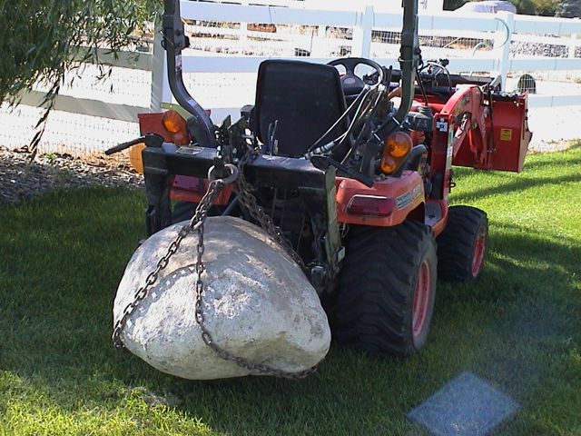

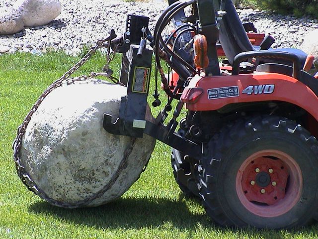

I have moved many rocks the size you are talking about both with the FEL and if they were to big I would use the 3 point. Using the 3 point you would lower the 3 point as low as possible tie chris cross a chain from the quick coupler with the lower arms touching the rock then simply raise the 3 point. If you happen to have a hydraulic center link have it extended the shorten it when you raise your 3 point. This keeps your center of gravity low so side hilling is no problem.

Thanks for the information. My problem however was not only to move the stone, but also tyo place them. As you can see in the first photo, I have close to 100 stone that have to be placed into a wall, sometimes each stone needs to be placed several times as it being fit, so the tongs work for placing as well as moving.
