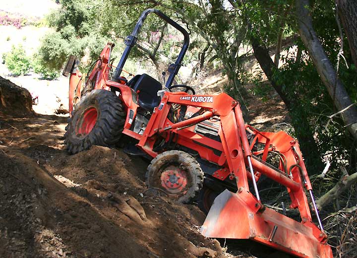

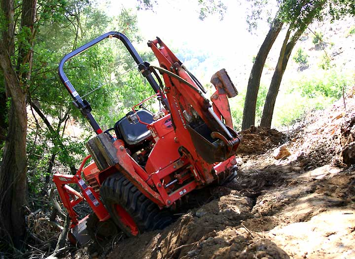

"Maybe I've misunderstood you, but pulling from a high point on the tractor, such as the ROPS, is the surest way to flip the tractor. A local man was killed in my area just last year doing that. Any time you pull with the tractor (or are pulled) you must attach at the center line of rear axle or lower to avoid flipping. "
Yes you could pull it from the rear axle but depending on how it slides it still can flip. Look at the 2nd picture again and see if you don't agree??? If I tie right to the ROPS at fenderheight there is no way it flips. The worst that might happen is the tractor starts to lean towards the direction it is being pulled and you have to back off a little and go for a second attachment point.
Sure if you pull the top of the tractor when it's on level ground it could flip real easy but this is a little different. Also I am not really referring to the top, but more correctly the upper half of the tractor(botttom of the ROPS)
When it's leaning way over like it is in the picture pulling from a little higher might make sense. Think about it, if you wanted to pull this \ on angle up a slope you'd pull from the bottom???? Maybe I am just picturing the tractor being tugged uphill more on a "sideways" angle than in reverse as it sounds like you are picturing it being pulled. As long as the front swings downhill and doesn't catch and flip, pulling it up from the rear axle in reverse will work as you suggest. Not so sure on a hill like that how it will go, and what the angle of attack for the "tow" vehicle would have to be. Doesn't look like you can pull it in a straight line from the back in picture 2 does it??? If I could I still think I would just wrap the strap through the big FEl mount and bottom of the ROPS and pul it up sideways, but my tracor only weighs >3000lbs and my trucks almost 3 times that so it would be easy. There was another poster not too long ago who tried pulling from the lowest point while stuck on a steep sidehill almost exactly like this one and it flipped. The tractor is leaning way over... north of the center of the tractor, near the bottom of the ROPS would seem like a safer pull than down near the bottom. I also suggested he pull it with something around 8000lbs like a one ton truck. With a the truck connected to the lower part of the ROPS there's no way it's going to flip. In order for it to "flip" down the hill as you suggest the top would have to go down hill first, not likely when the middle of the ROPS is tied to an 8000lb. object anchored on good level ground.
Maybe we're both right, lets split the difference and attach straps to the bottom of the ROPS and the axle so we've got both angles covered /forums/images/graemlins/cool.gif
/ Between a rock and soft dirt #22
"If you pulled from the drawbar it might cause the tractor to roll on its own...sort of just the opposite of pulling something with the tractor from the rops..."
Yes Henro,
That's exactly it.
I based my post on past experience. I tried pulling a Chevy Suburban (much more stable than most tractors) from a similar predicament. Being an automobile my choices for attaching were limited to the Subs frame area. A couple of good pulls with my F350 an it started to look like it might tumble down the hill. The uphill side unweighted, the downhill side sunk and it got ugly quickly. It became apparent I could get him out but whether it was wheels up or down was questionable /forums/images/graemlins/grin.gif, at that point I backed off and a wrecker (read: insured helper) came and got him out.
The bill for the wrecker,a stern warning from the police not to trespass on my neighbors property plus some nasty damage to Dad's Sub completed a rotten night for the teenage driver looking for a place to "be alone" with his girl /forums/images/graemlins/blush.gif

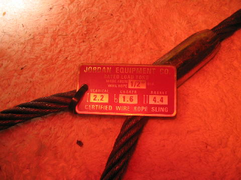

I will Leave this string with a pic of one of my 2.5 ton straps...(!!!!!!!!!!!!!!!oh yeah and thats only on a basket!!!!!!) and how much more forgiving a properly taken care of nylon strap is vs. a steel choker as far as the loss of lifting weight on a choke!!!!....i will git into this !!!!MUCH DEEPER later..
BY THE WAY!!!!!!!!!!!!!ON THE JOB THAT I JUST FINISHED UP HERE IN MAINE!!!!!!...........at the jay paper mill on paper machine our biggest lift was OVER!!!!!! 78,000LBS.!!!!!!!..
AND THE 2 CHOKERS WE USED WERE RATED FOR 100K APIECE!!!!!!!!!!THATS MORE THAN TWICE THE LOAD LIFT RATING!!! YYYYYYY!!!SAFETY FIRST!!!WE COULD'VE USED TWO BLUE 40,000 LBER'S..SO WHY NOT...BE SAFE!!!ITS JUST YOUR LIFE AND I DON'T HAVE AN EXTRA ONE OF THOSE TO SPARE!!DON'T KNOW BOUT YA'LL BUT I'LL SAY ONE THING...
