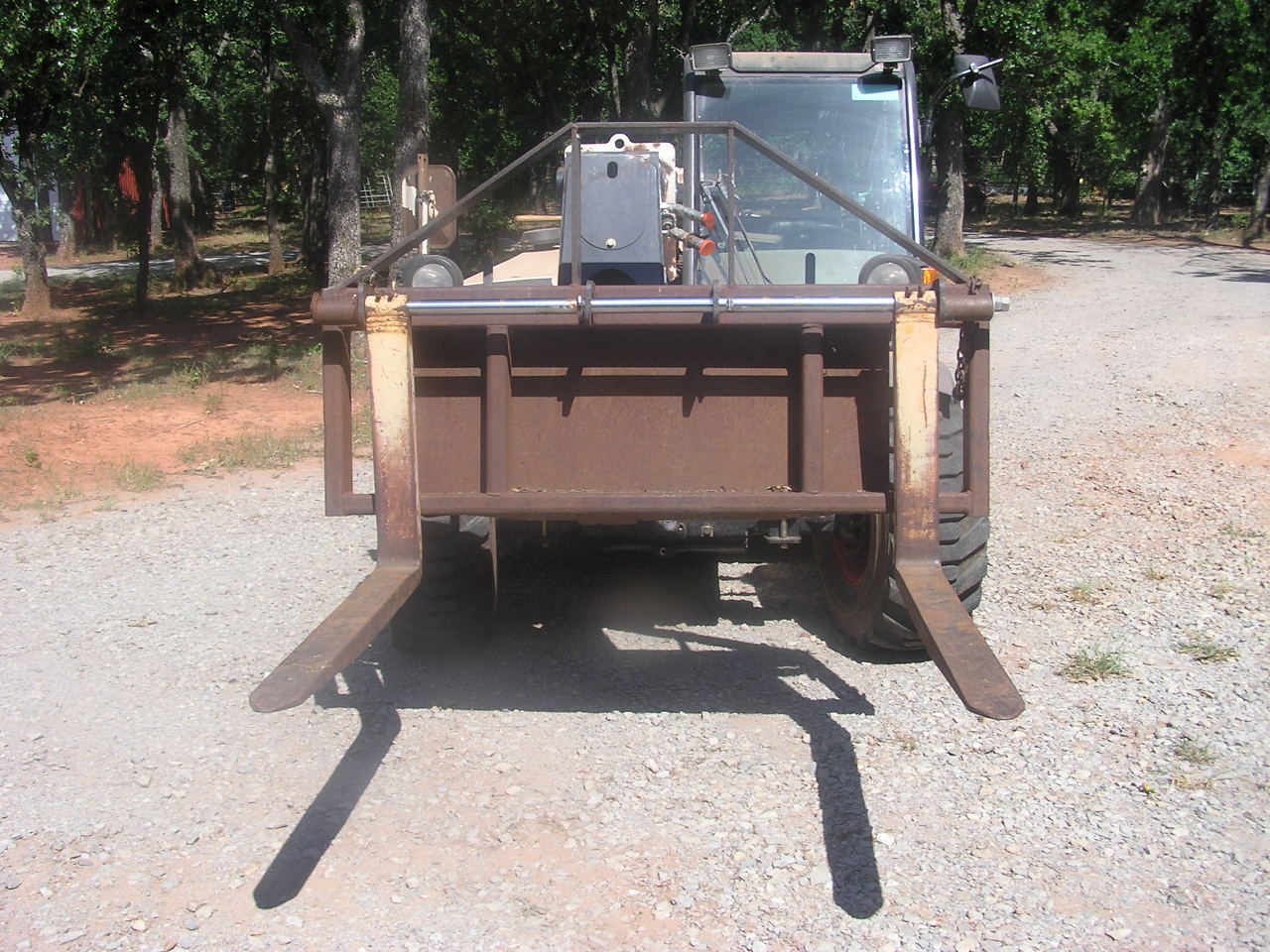

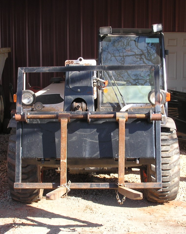

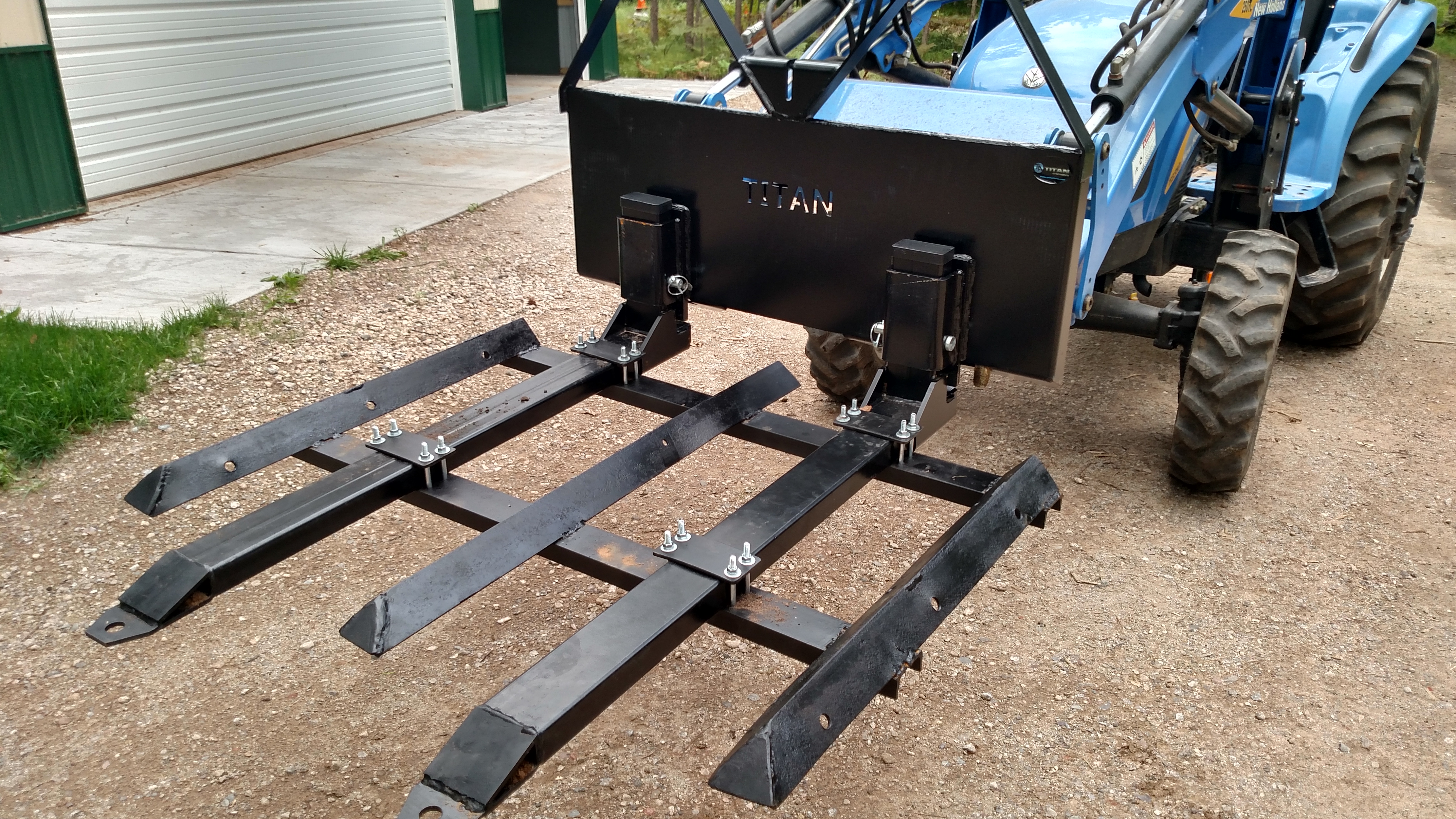

I got the brush forks off the loader. Some of the nuts did not want to move, but I got them loose with a big wrench and greased the threads. I worked the turnbuckles and got them loose, too. Next time, it will be a lot easier to remove them.
I am now much happier about the forks. Now that I can remove them, I can also move them around when I need to use the tractor as a forklift. The only difficulty will be keeping the forks level. I should be able to move stuff approaching 1000 pounds, if I understand the label on the forks correctly. It says the weight limit is 1500 pounds, and the label appears to be for one fork. The forks themselves are heavy, so I figure I deduct maybe 150 pounds from the tractor's lift capacity, giving me 1350 pounds, and I should be okay lifting 1000 to give myself a margin of excess capacity. The forks can apparently take it.
