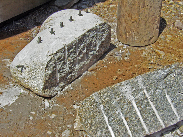

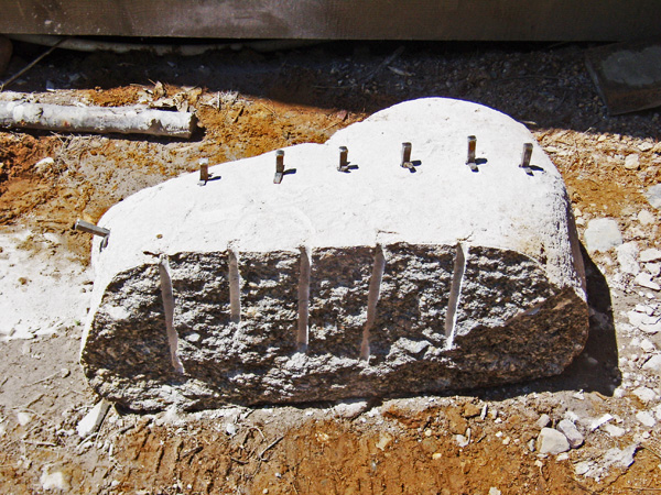

If it has to be split: a 1/2 in. SDS rotary hammer drill with feathers & wedges will work well. Split into flat slabs & use for landscaping or sell. An angle grinder with a dry cut rock blade would help score a break line.

I agree with the other two that mentioned it, feather and wedges, or wedges and shims (depending on where you are from). They have been used for a long time, just don't get small ones for a boulder that size. I don't split boulders, but I was splitting large rocks with the ones I bought. Drill, insert, tap down the line - crack and done.
Here is a link for you : Wedges & Shims
I am not claiming that their stuff is the best, but I bought two carbide chisels off them that were fantastic. I wouldn't use steel ever again. When I went to a dry stone class the instructor used their stuff too.
