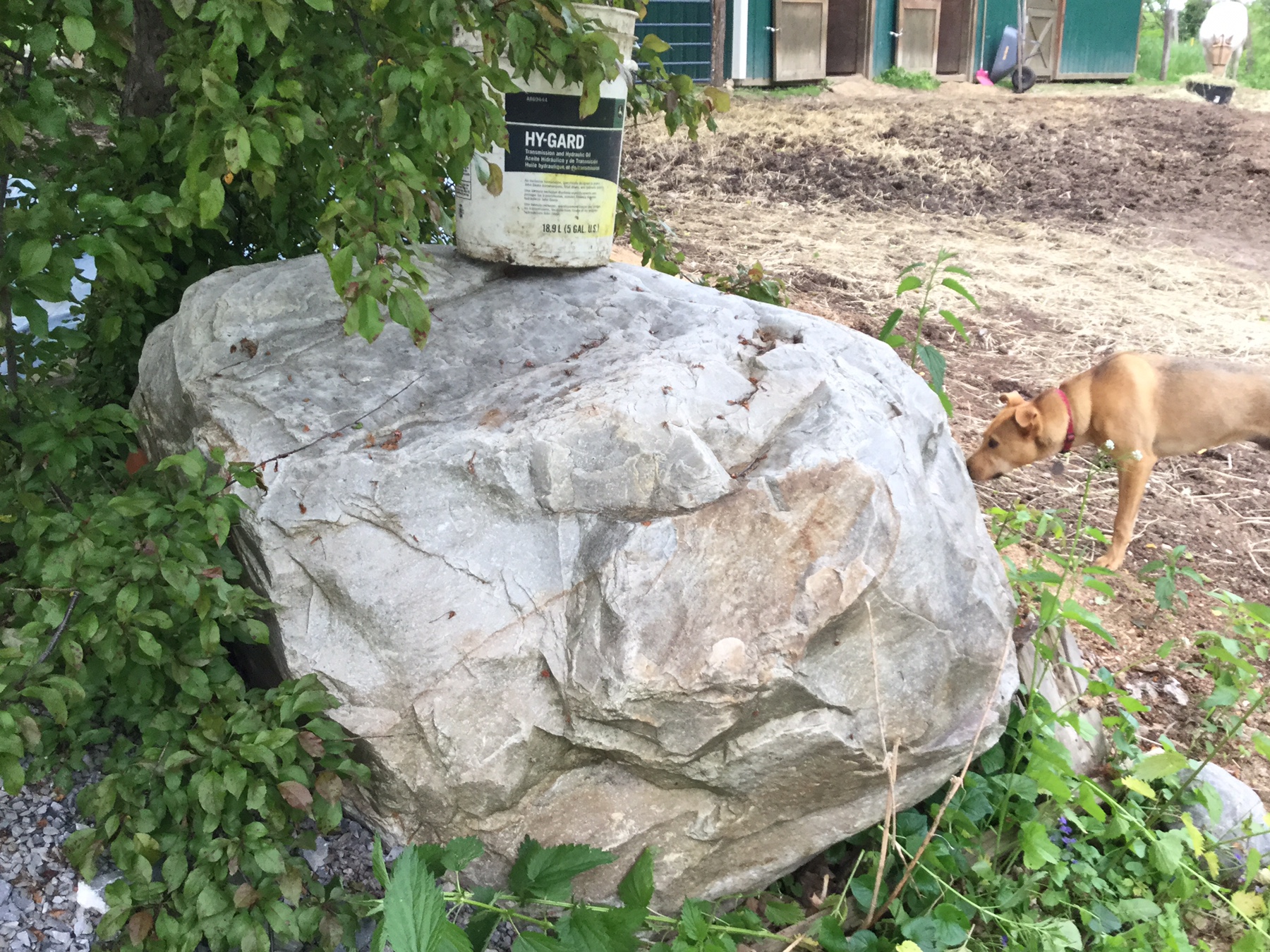

There's another thread going on about best way to dig 3' of bedrock. This is similar, but different enough that I didn't want to derail that one.
I have a (let's say 3'-4' diameter) boulder that got dug out when I built my barn. Not sure what type of stone, but seems pretty dense/hard. Excavator was able to roll it, I was able to push it against a tree with my 8000lb tractor and that's where it lies. I think that if I could split it in half, or more, I might be able to lift the sections with my FEL.
The other thread introduced me to Expanding Demolition Grout. Seems like a good option, but how do I drill holes and not end up spending $500 on a rock? When all I get is.... more rocks.
What type of drill? Type of bit? Bit diameter? How deep? How many holes? How far apart from each other?
Any way a homeowner can drill with a 1/2" electric drill? Would grout still work. Any experience? Guessing my chances are probably slim to none.

/ Best way to split 3'-4' boulder?
This is the rock. Bigger than my original estimate.
5 gal bucket included in picture for scale.

/ Best way to split 3'-4' boulder? #18
Well,,,,, Google says a cubic foot of granite weighs 170lbs.
By the picture, I'm gonna say it weighs 6,000 lbs. I think I'm high.
So, doesn't take much of a trailer to haul it. Just gotta get it on the trailer.
Sure wish someone would come to me willing to pay me thousands of dollars to move that rock!!!!! I'd be all over it. :)
