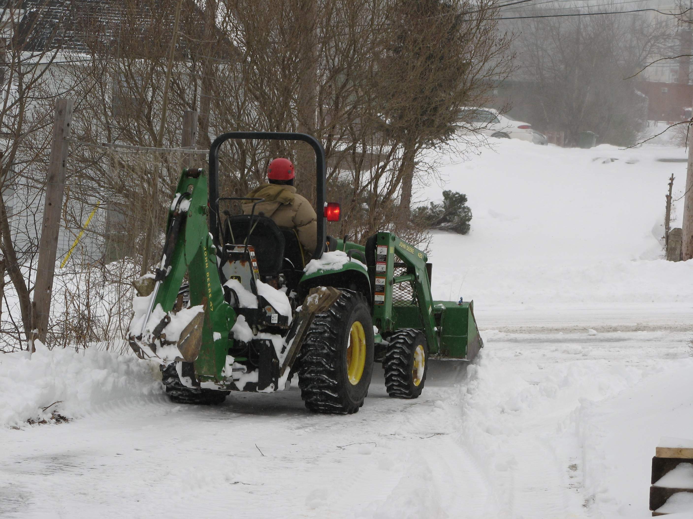

Keep the Hoe on and add chains if necessary. The Hoe can help get you out some difficult situations.:D
The only drawback, for myself, is the stuff sticking out back that you must always be cognizant of. :)
