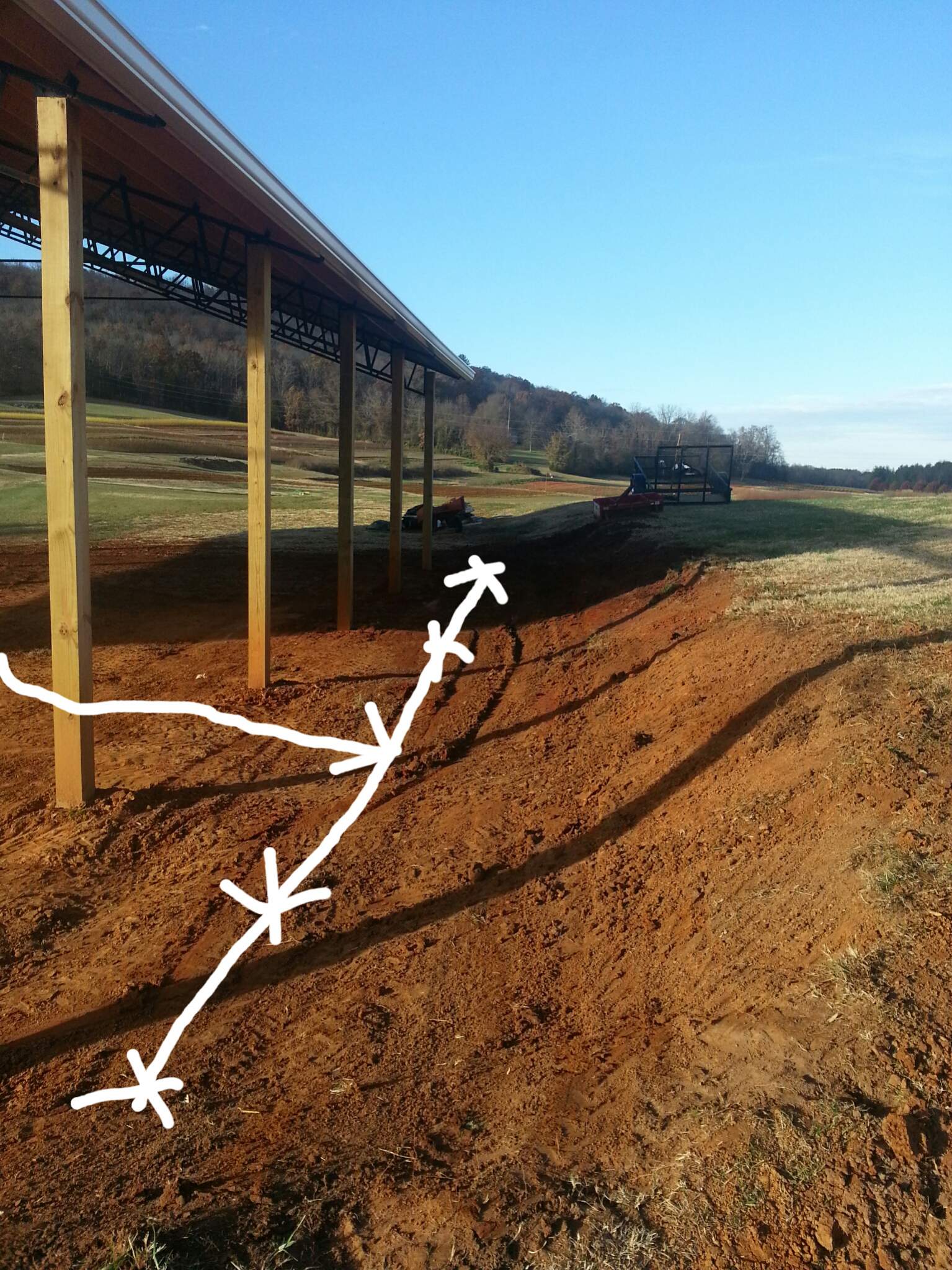

I built a 48x50 pole barn, and was wondering what type of drain to install to reroute water around the building? I cut into a slight slope to build the building, and some of the water flows down the hillside toward the barn. I installed gutters on both sides that helped tremendously, but there is still some that runs off the bank toward the barn. I'm wondering if a french drain, or install a few drains where the X's are in the picture, would be better.I plan on getting the barn/pad concreted, and if I run the pipe across and under the barn, I can tie that into a drain I'm wanting to put in the center of it also, and keep routing it on out in the same direction. I plan on having gravel on the outside of the barn on the side pictured, and sod the slope. I just wanted more opinions on what you all though the best drain type would be? Thanks!

What a fine looking barn and a beautiful location!
If this was my barn I would change the contours of the ground around the barn.... create a grass-lined waterway to carry run-off around the structure, rather than try to trap / pool / pipe it away....
The cost of creating a GLW is in machine time, and has almost no maintenance, where any form of enclosed drainage requires parts (pipe and gravel), will accumulate silt, and therefore have a set life-span...if your GLW gets overgrown, it is wide open for maintenance...running the mower or dragging a box blade thru it will cure that problem....

X2 on Terry's drainage swale. It looks like that high side needs to be cut down and widened some more. If it will hold grass with the runoff that's fine. If not, then a rocked bottom would be the next step although not nearly as easy to maintain with a mower.
French drains are meant to dry out a wet area, carry ground water away from foundations and the like. They don't do much at all for sudden runoff which is what you are trying for.

Grade Grade Grade. Your just not finished yet. The further you can get the water away the better. lt190b

Well it looks like I'll be doing some more grading! Thanks for everyones insights. I'll keep chipping away on the upper side. I wish I could use the dirt to raise the height of the entire pad, but I'm at my limit on the upper side for door height, so the grade on the upper end (pictured) is the highest I can go. I should be able to get the hill graded down low enough to create a natural waterway though. Thanks again!

You need to remove more dirt!!!! You need for your soil to slope away from your building far enough that when water is flowing, it doesn't come close to it. Then you need the dirt on the other side of the slop to be angled enough to maintain it with a mower, or turn it into landscaping that you can maintain. A retaining wall would be my last option because of the expense involved.

I'll get to removing more dirt in the next day or two if it dries out enough. I've got about 30 more feet of slope I can play with until I start running into another shed, so I should have plenty of room to remove more dirt. I should be able to get a small waterway/trench deep enough to keep the water flowing, and have an upslope easy to mow. I can get sod relatively cheap around here so I may use what I'd use in drains/gravel and throw it to the sod.

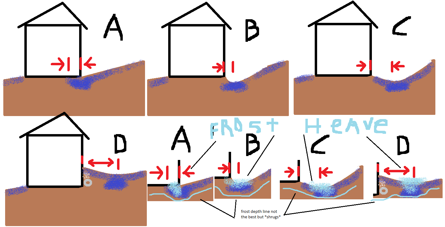

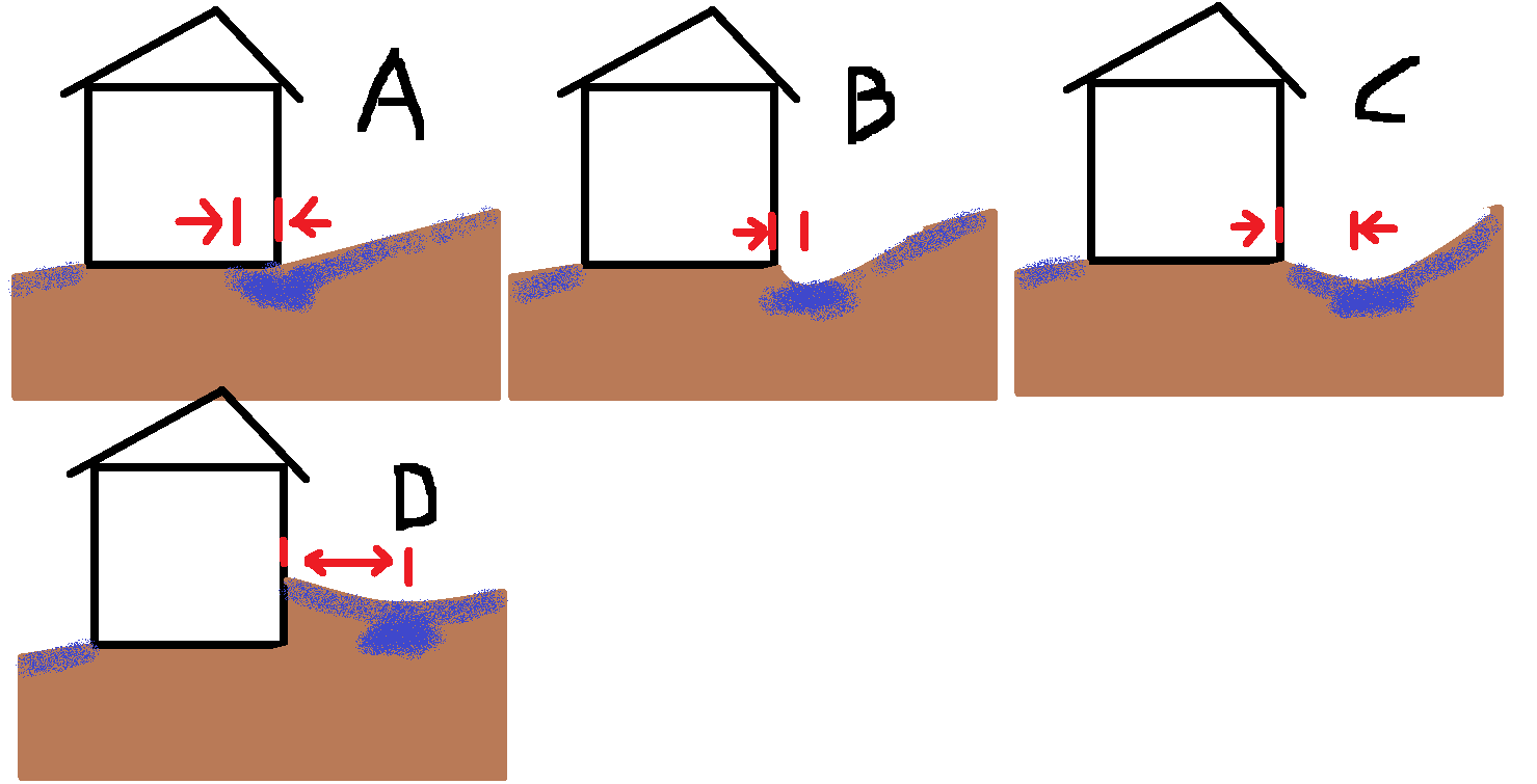

*rubs chin* ground water... for me, i have to worry about "frost heave" ground can change from 0 to 3 inches easily in some areas on this farm. some larger sliding doors hang freely in summer by a 1" or more, and ground heaves (freezes in winter) and land locks the doors shut, with a paper thin sheet of ice.
i need to re-look it up, been a while, i want to say frost depth for me is 3.5 or 4 feet deep.
see attach picture
A = all water runs into the shed (no good)
B = little ditch maybe even a french drain, and some surface drains = water still getting under wall of shed
C = alright good, ground water that soaks in, is now starting to move away from the shed and no longer under it.
D = moving ground water even further away from shed possibly. i am showing a french drain up against the wall. to help drain area of water. ((fresh fill dirt going back in, it will take some time to settle / compact itself. and until then ground water going to move into the area.
soils are different all over the place, some drain better than others.
percolation test = digging a hole, pour in say 5 gallon bucket of water, and timing things at a set amount of minutes and see how far it drains down, and how long it takes to fully drain out.... to be honest i don't know the numbers to tell ya good or bad. a backhoe or excavator = easy dug hole at x depth, or a PHD (3pt hitch post hole digger). good draining soil = excellent cheaper smaller septic fields. vs soil that takes a long time to drain = larger more expensive septic fields. is about all i know of it.
while you may think you are dealing with a lot of "run off surface water" what does soak in as it runs down the hill. that soaked in water in the ground is going to also slowly soak it's way down towards your shed. how well it drains to lower depths of the ground, and removes it from the frost depth for your area.. *shrug* not a clue. your local companies would know much better, that work your area as a day job dealing with dirt / construction.
when frost heave hits your shed floor, it will hit it unevenly, causing it to crack in places. more so if you have not done correct compaction of the soil.
take pictures with a grain of salt, more of attempting to get concept across, more than anything. and in that further away you can divert water from shed the better. trying to collect and divert it right up against shed :/ gets ugly.
