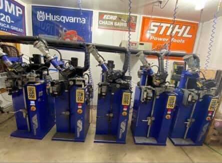

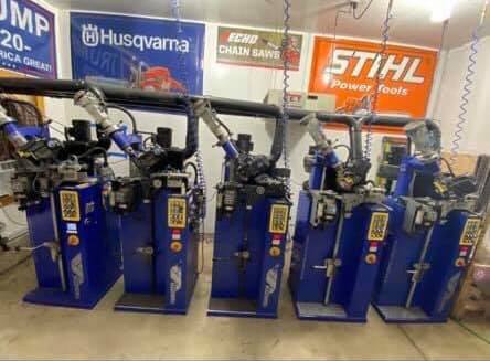

Friends shop north of me. Most shops cant afford 1 of these let alone 5.
I hooked him up with #3 when I found it used north of him few years back. He just bought #5 this year.
This might be the best out there. But not in the reach of homeowner or even most shops.
He does online sharpening mostly and local stuff. HOME | razzorsharp
Pricing shipping etc Pricing and Shipping | razzorsharp
