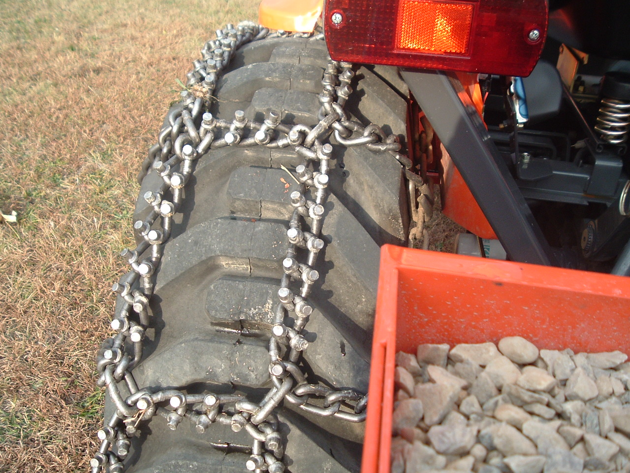

I have Aqualine Talons. No disappointments at all with these chains. Not for asphalt driveways. Not good on a concrete garage floor. I park them on 3/4" thick horse mats on my concrete garage floor. Tellefstall chains are very good also.

What your picture shows is in line with what I want. Got to weigh the cost vs. performance and see if anyone sells as good for less. Where did you get the "Aqualine Talons."
