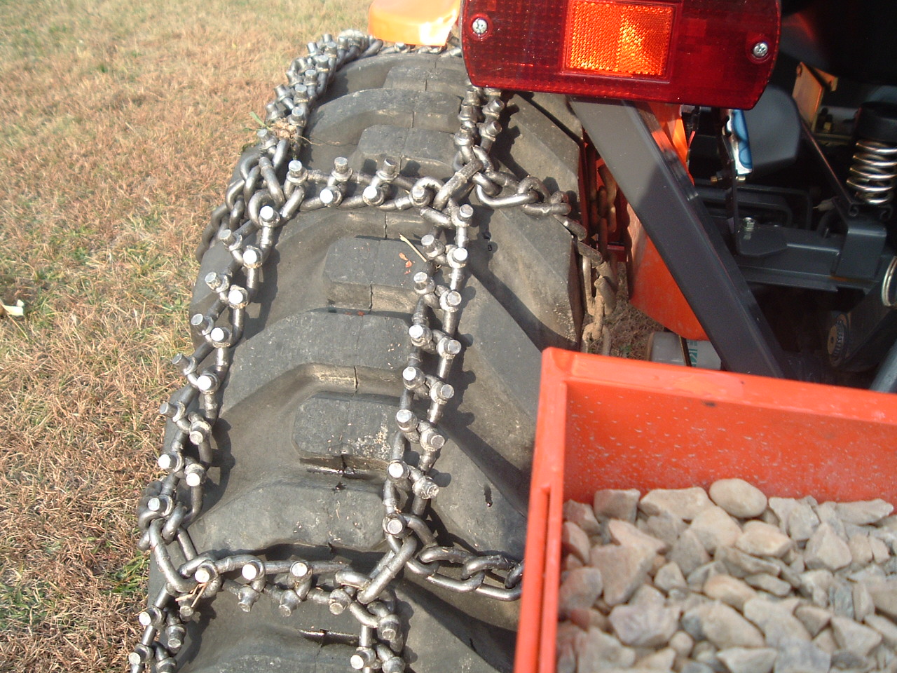

I found a used set of good ice chains on Craigslist and picked them up for about half the cost of new. I need to lengthen them a bit as the tractor they came off of was one tire size smaller but I can get some cut offs from the local chain dealer or make them up myself. They are 3/8 chain in the skidder pattern with the double round studs on each link. I think I'll just combine two sets of pick up chains for the fronts to keep the cost down while still having some side traction while steering into a snow banks. When I get them fitted up and on the tractor I'll post a pic.
/ Best chains for 5045E?
#22
Made up the first chain today and fitted it to the tractor. I used three cross links from my neighbors old chains to make mine long enough. Of course it is never easy. the neighbors chains are wider then those I bought. Doesn't seem to matter so far. I started by cutting one of the old chains in half then linking up the free end of the newer chains as far a possible with some repair links then splicing on the half old chain. Putting it on the tire it was soon apparent that I had gone too far and had to cut off a quarter of the original length of the old chain. Need more repair links to do the other side and I will try to pick them up tomorrow.
