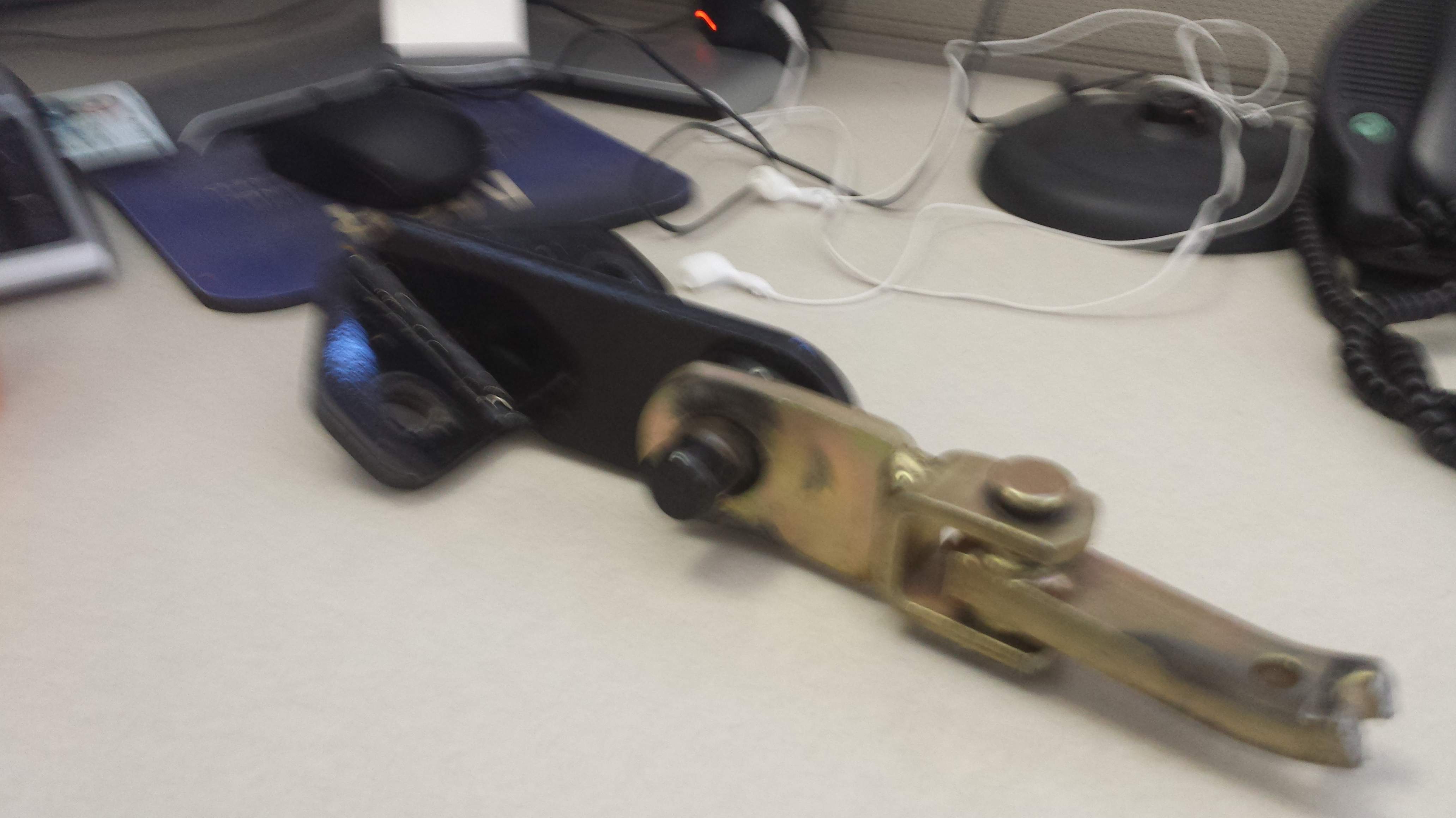

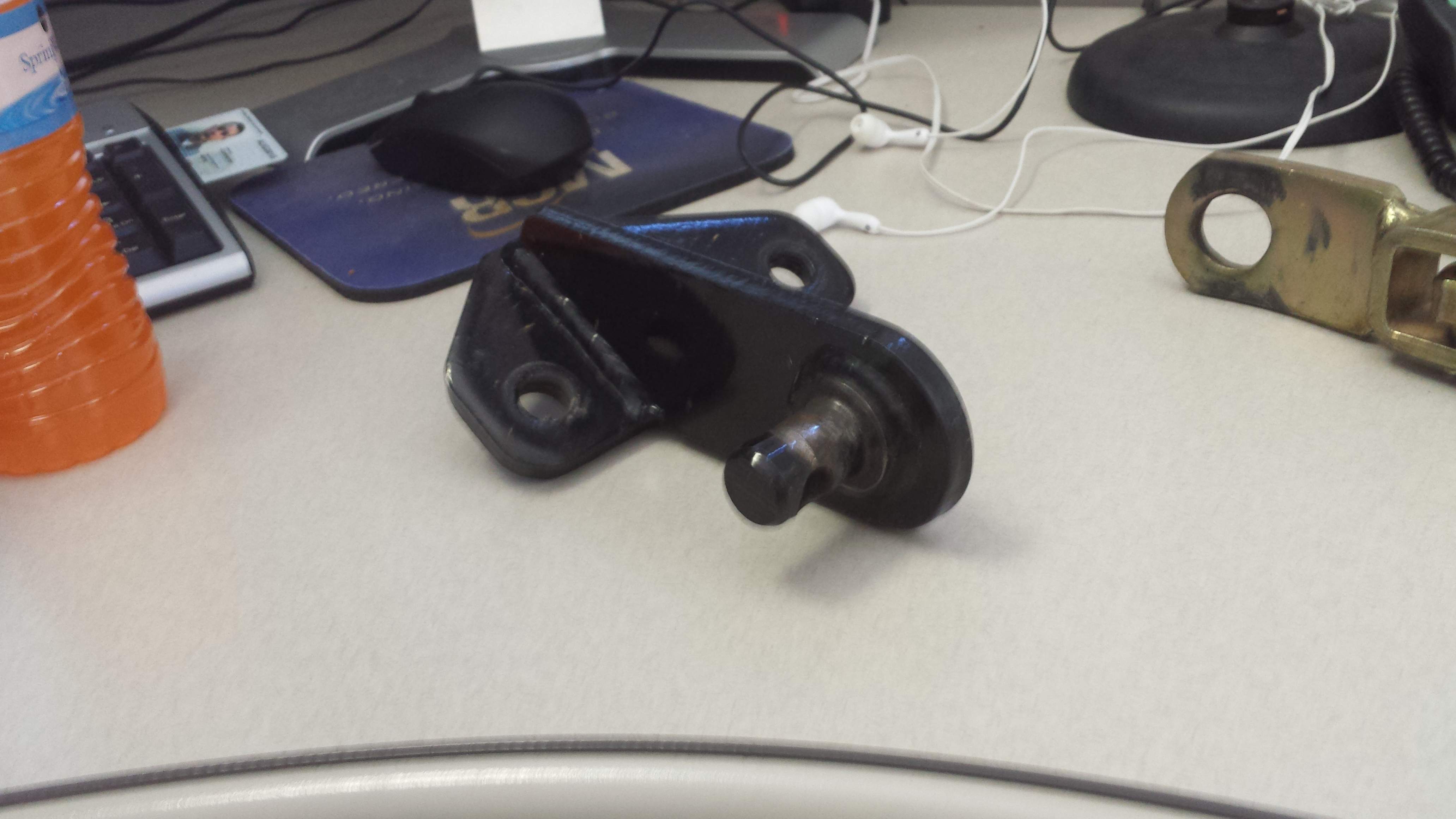

Here's the existing stabilizer bracket.
Here's the existing "pin and plate" setup that I broke.

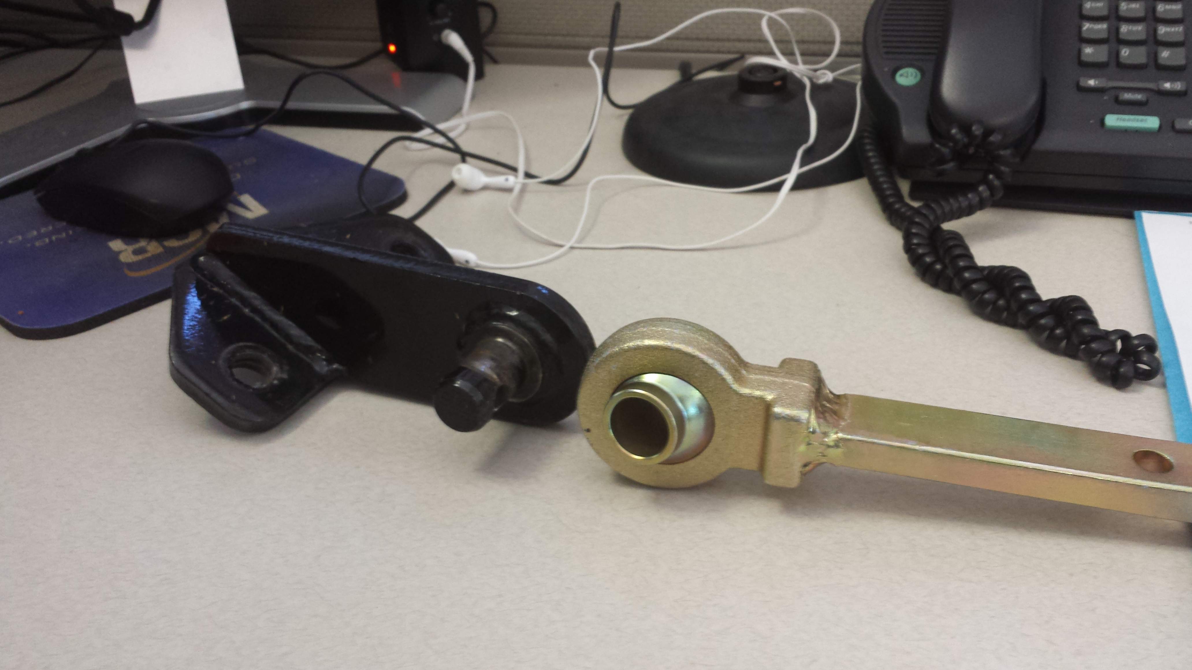

Here's the new stabilizer bar and the old bracket
And the new stabilizer bar with a Cat 1 top link pin
The pin on the existing bracket, has too large an OD and is too short to fit the new stabilizer bar. I was hoping that I could cut off and drill out the existing pin and replace it with a either a Cat 0 or Cat 1 bolt in draw pin, but the ODs are wrong for both.
The working plan at the moment is to cut and drill the existing pin and weld in the Cat 1 top link pin, which has the right OD of 3/4". I thought about just getting a 3/4" bolt but it's a bit kludgy for my taste.

I have used bolts on that type ball end before. I like the fact that it makes it solid, no sliding on the pin, no pressure on the lynch pin.
I agree with your plan to cut and drill the existing pin, but I would bolt it. Just my :2cents:.
It is bound to be better than before! :thumbsup:

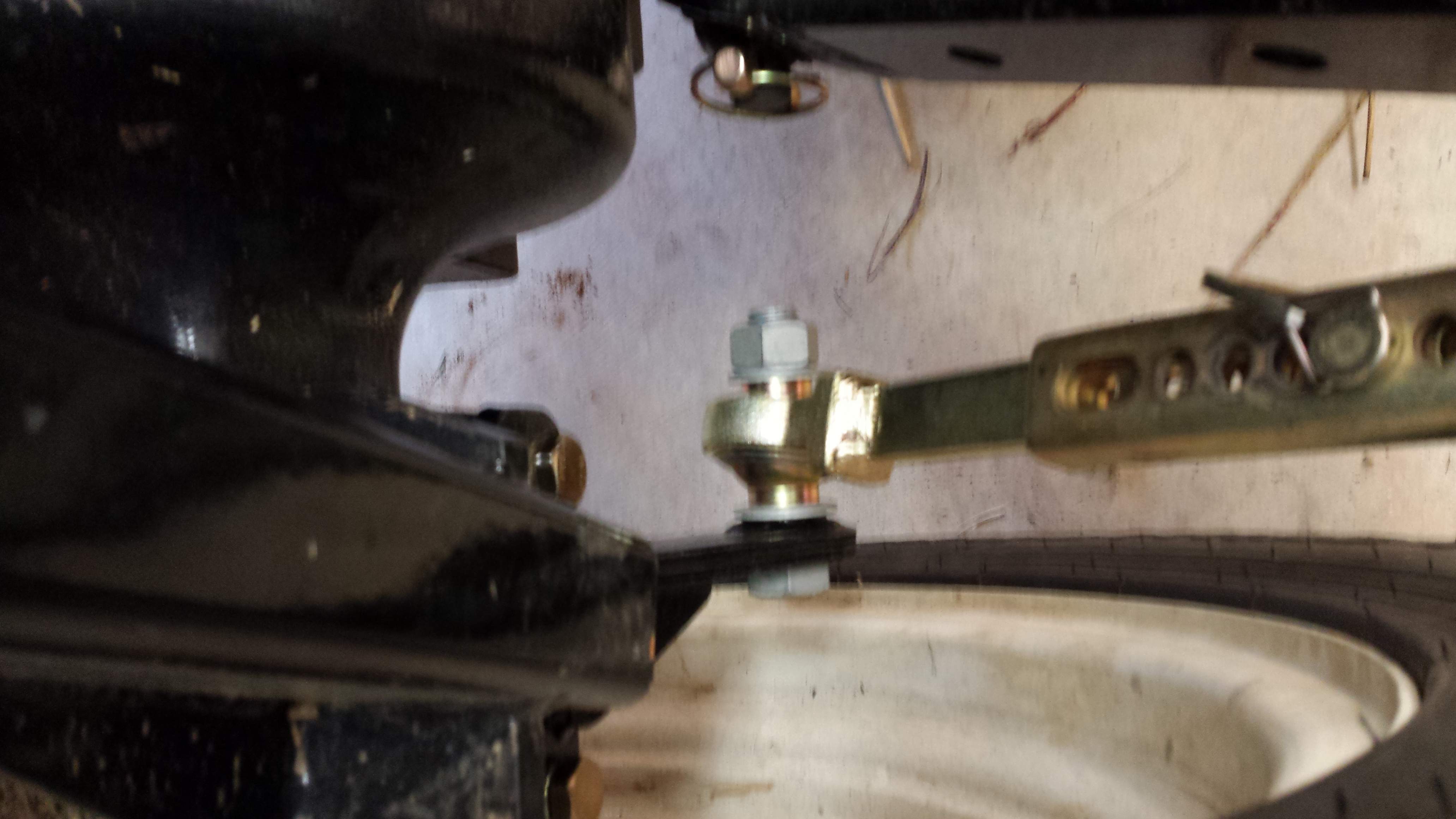

Finally got around to doing the retrofit. About 45 minutes start to finish for the job. Cut off the existing pins with the chop saw, trip through the drill press for both, the assembly. Used grade 8 3/4-10 bolts I got from McMaster with matching nuts and washers with a coating that's rated for salt spray. Torqued down with a little blue thread locker and it should be good to go. Got to take the box blade to the driveway so I should have test results soon.
Ultimately it's probably a more solid connection than the old way with the clevis pins along with being less prone to binding...

:thumbsup: Looks good, a little blurry, but good. :D
In fact I guarantee that it will not bend or break! (until it does) :laughing:

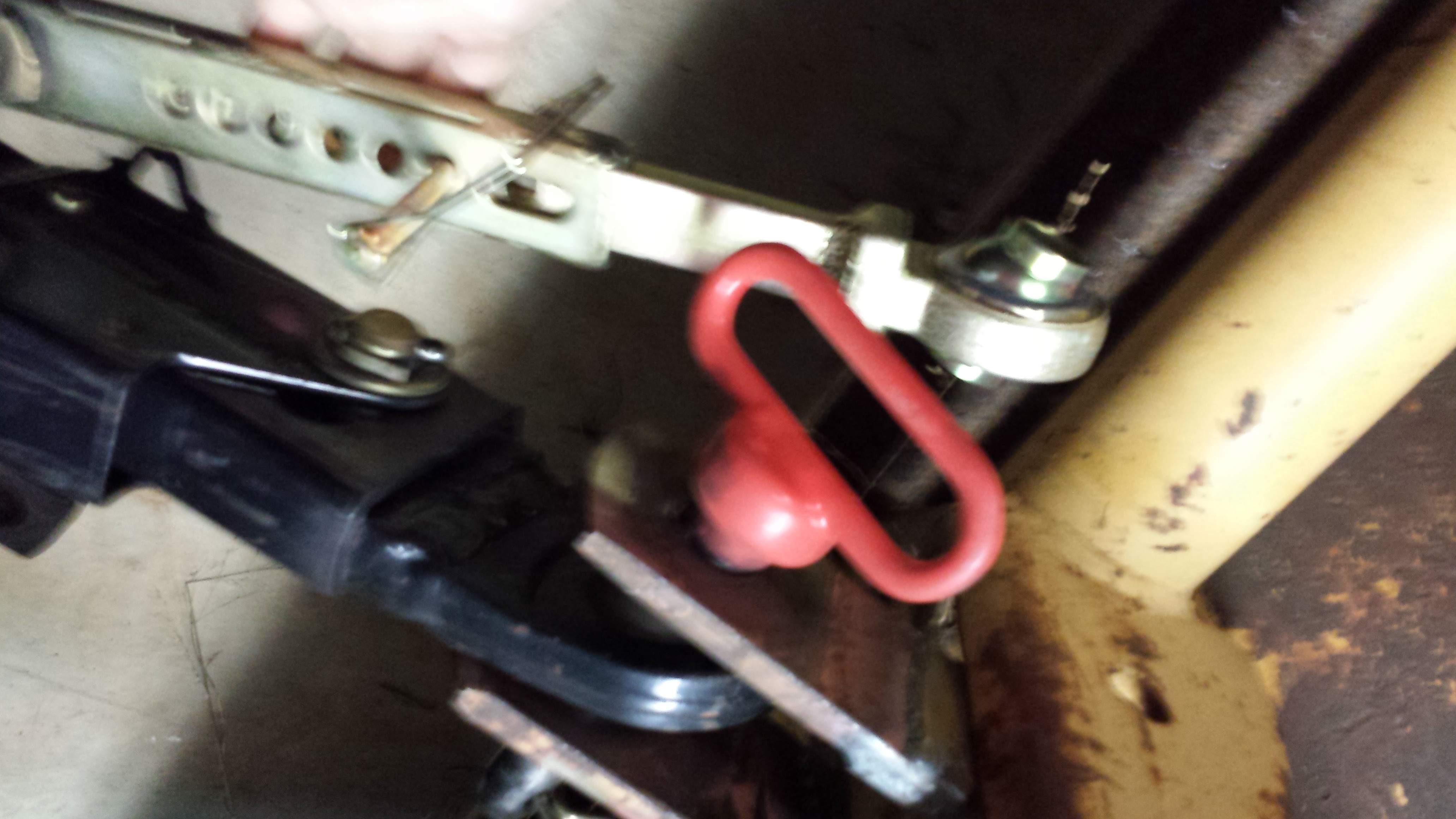

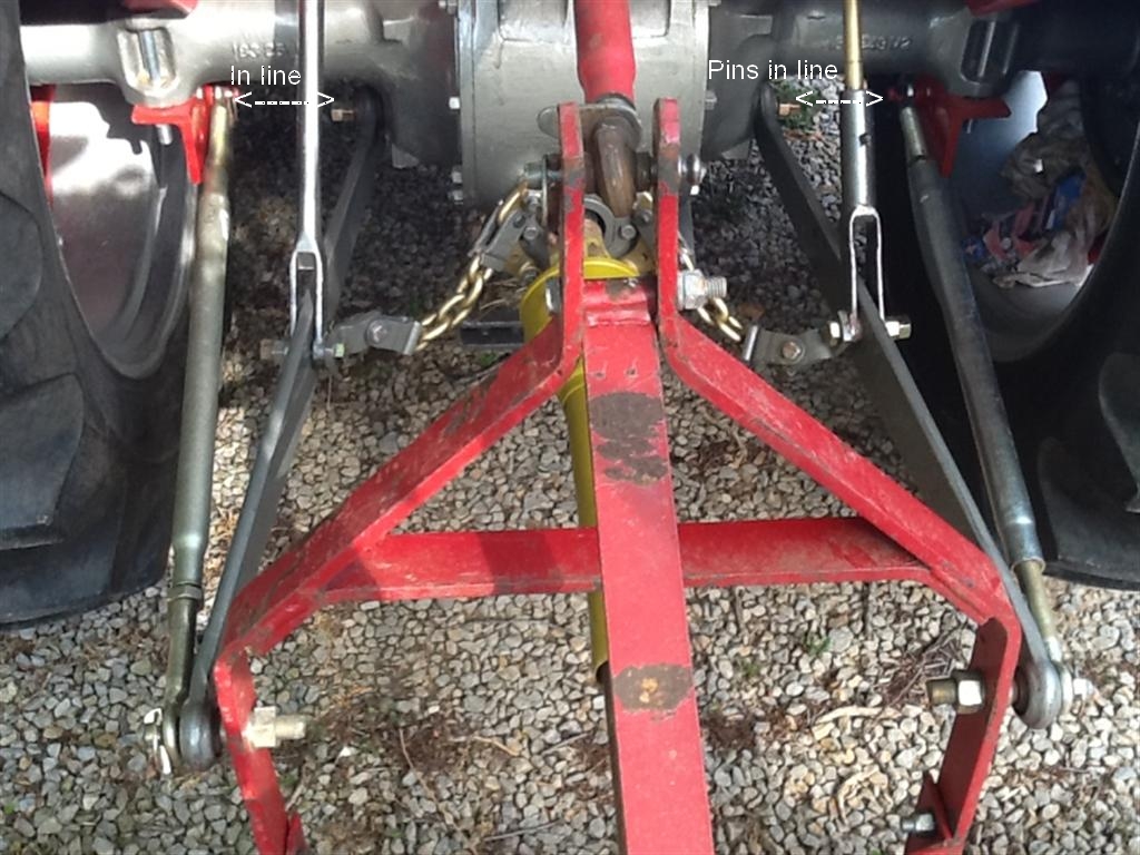

Bent stabilizers are common on compact tractors due to the narrow wheel base. The shallow angle between the lift arms and the stabilizers links reduces the effectiveness of the links making them difficult to properly adjust. Consider that stabilizers were originally short lengths of chain. Chains are made for pulling motion. The stabilizer bars are no different than a chain they are only intended for a pulling motion, compression will bend them every time.
When properly adjusted there should be no side to side motion of the 3-point.
