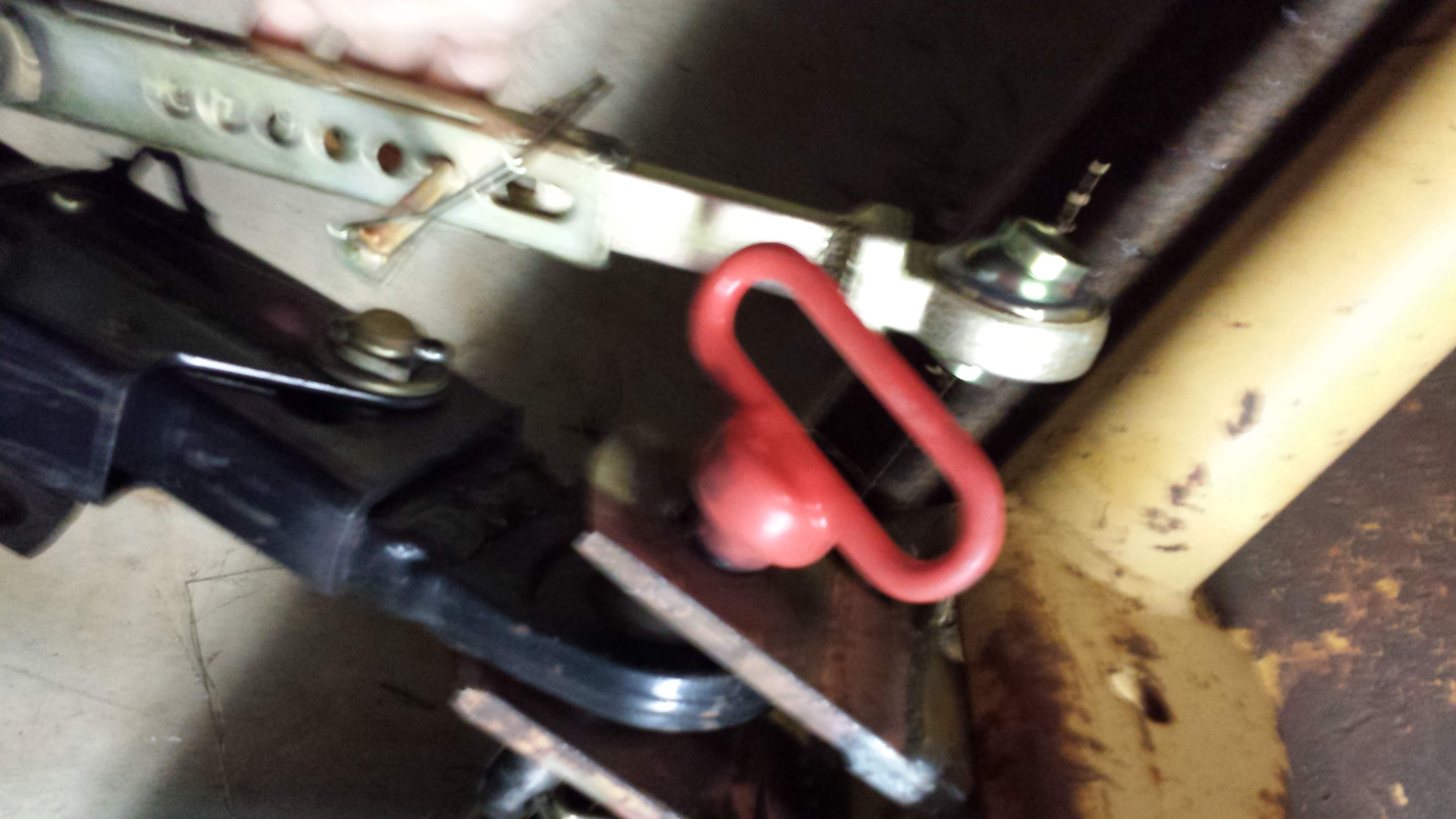

/ Bent stabilizer. Convert to ball bushing stabilizer? #20
Keep in mind if you fab a new plate, the pivot hole has to be directly in line with the pivot point of the lift arm.
If it not the stabilizers will bind when the lift arms go up, preventing them from going all the way up.
Note the white arrows added below.
