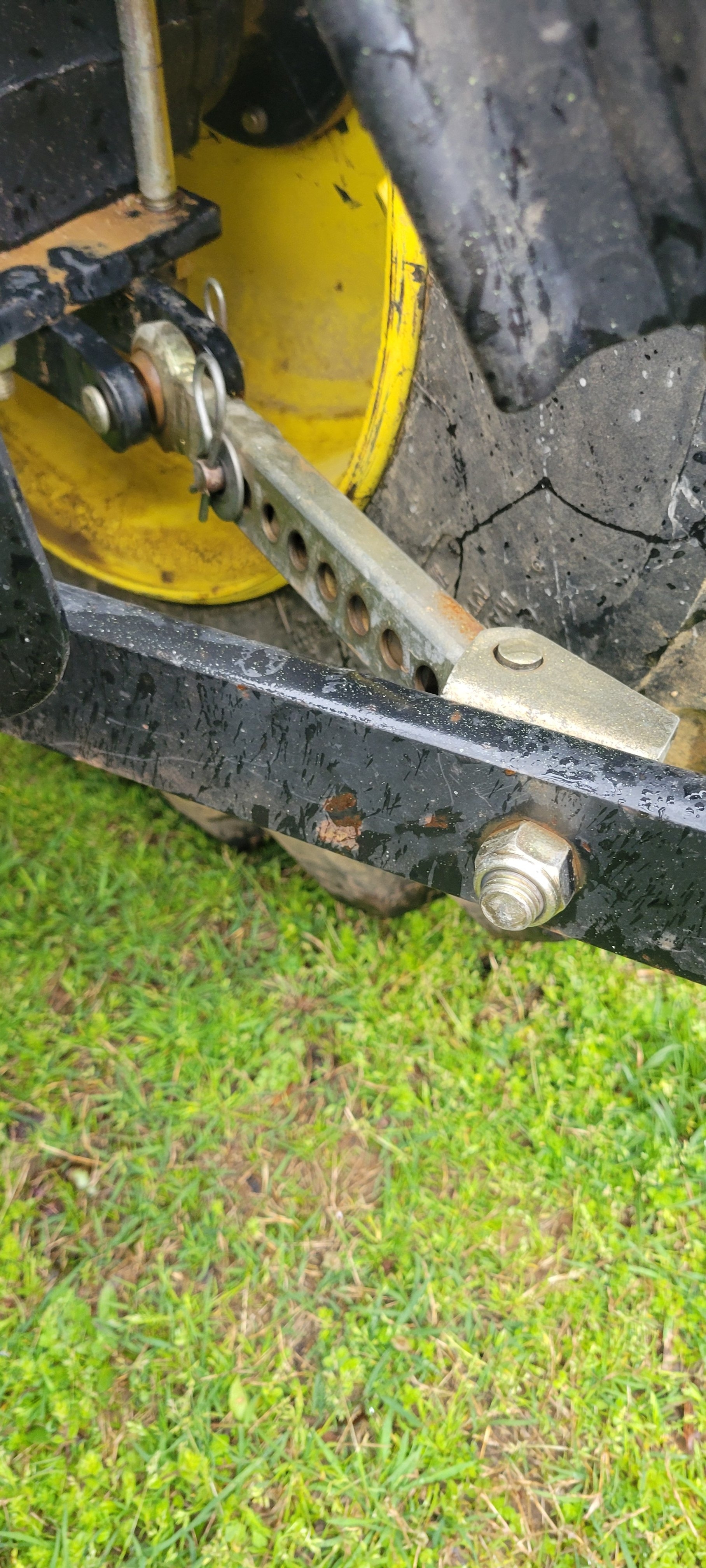

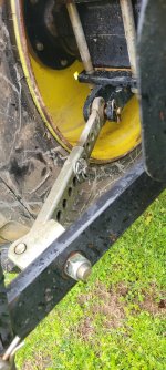

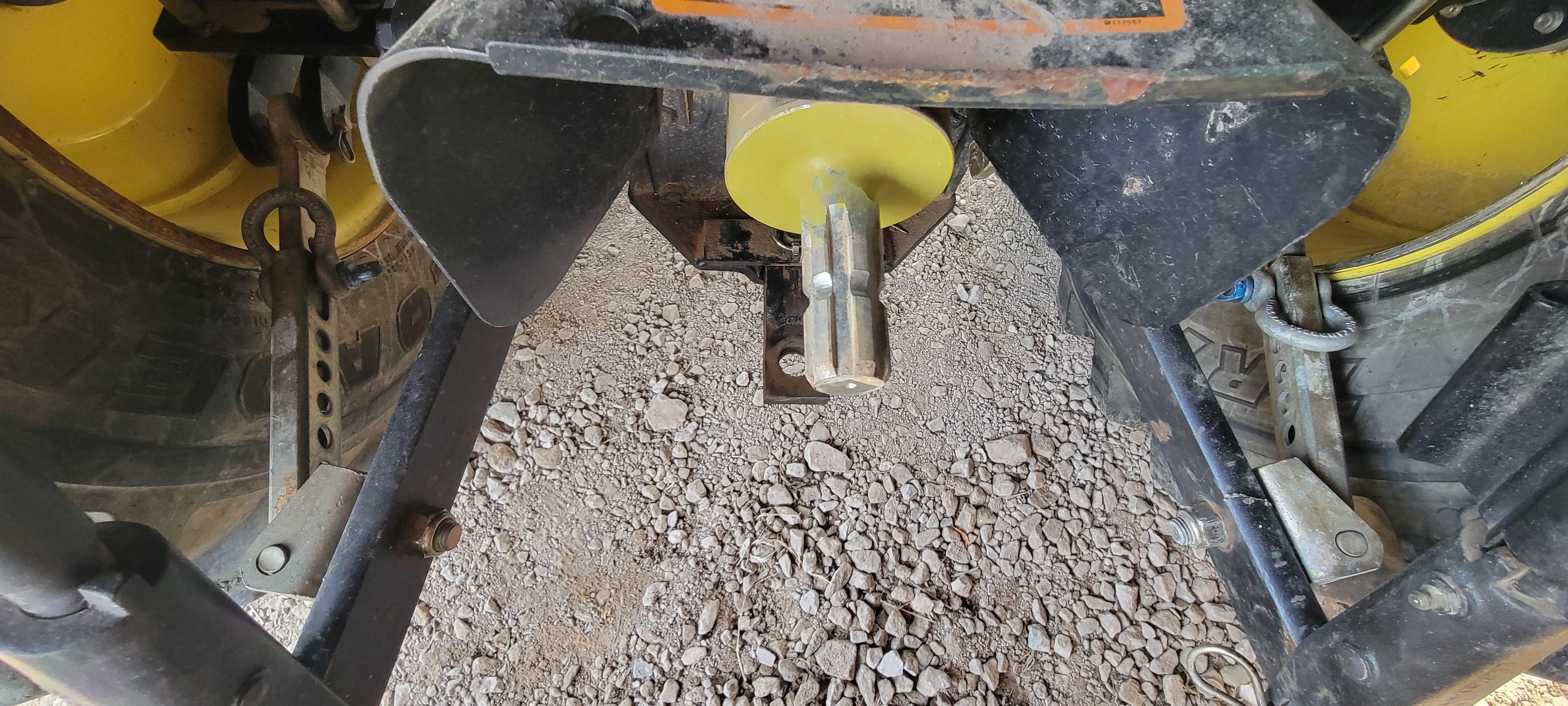

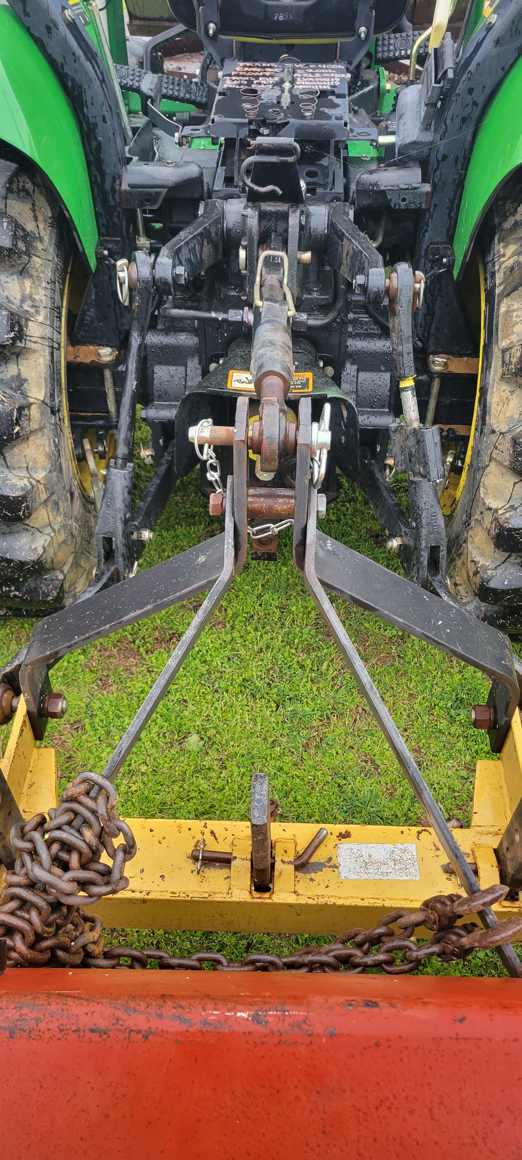

I've come here today to make my first post and ask a question and hoping to settle my mind on something.
I bought a gently used JD 4300 compact tractor about a year ago and have this nagging OCD issue.
To set my 3pt up to have all my implements centered with the tractor, my stabilizers are not equal length. Is this normal, or do I have something bent?
Being unequal has no negative affect on anything, it just digs at my OCD, and boggles my mind as to why.
Nothing appears bent and everything seems to function correctly.
On a side note, is there an easier to use stabilizer out there? I like the Kobota style that allow the pins to drop in from the front. Installing from the sides can be tricky at times being so close to the tires.
Thanks in advance for the help!

If you will attach both LH & RH sway bar brackets to draft link in identical methods then I think your tractors sway bars will be identical length when implements are centered behind your tractor. Note differences of mounting of brackets orientations in each photo below. Loosen nut on RH draft link, pull pin then separate telescoping sway bar components & rotate sway bar bracket 180° correctly reassemble telescoping sway bar then retighten nut. I think after the alterations I suggested your sway bars will be same length.

It looks like you're wheels are set to the narrowest setting. If you swap them side to side (dish out) you'll gain some working space back there making adjustments easier along with added stability.
That JD sway control functions just like Kubotas but the pin drops in vertically on Kubota eliminating it need to use the "hairpin" to secure it. Using the hairpin on a Kubota is more difficult as it's on the bottom and you have to fumble around finding the little hole from above, or lay on the ground to see anything.
After you have made the sway bar brackets symmetrical please take a picture to confirm this was the problem.

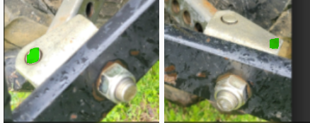

It's not normal for sway bar brackets be attached to draft links 180° opposite. As I previously stated RH sway bar bracket needs to have nut loosened & bracket rotated 180° so both sway bar brackets are attached the same way on each draft arm then nut tightened. Notice green area on mounting brackets in photo. This falls under correct geometry of sway bar attaching parts!!!!!!!!!

It's not normal for sway bar brackets be attached to draft links 180° opposite. As I previously stated RH sway bar bracket needs to have nut loosened & bracket rotated 180° so both sway bar brackets are attached the same way on each draft arm then nut tightened. Notice green area on mounting brackets in photo. This falls under correct geometry of sway bar attaching parts!!!!!!!!! View attachment 3221684
Tx Jim, I didn't see what you meant - the first time you said it - I sure do see what you meant now though! You are correct for sure, that bracket being 180 out will cause exactly the problem the OP is having. Thanks for reshowing these pics, cleared up any confusion I had!
Hey everyone, thanks for the quick replies that I failed to follow up with in the same quick manner. While I did find the solution to my problem after reading TX Jim's reply. Wanna talk about feeling dumb as a bag of hammers. I somehow never noticed the two were different. All is straight now. I also figured out a little better solution to using the factory JD pins.... cheap 7/16" D rings. I had to open them up a tickle, but these work much better than the clevis pins. A 7/16" locking pin would probably work good if I could find a stubby version of one. Anyway, I had the D rings laying around, so the free factor made them perfect.
