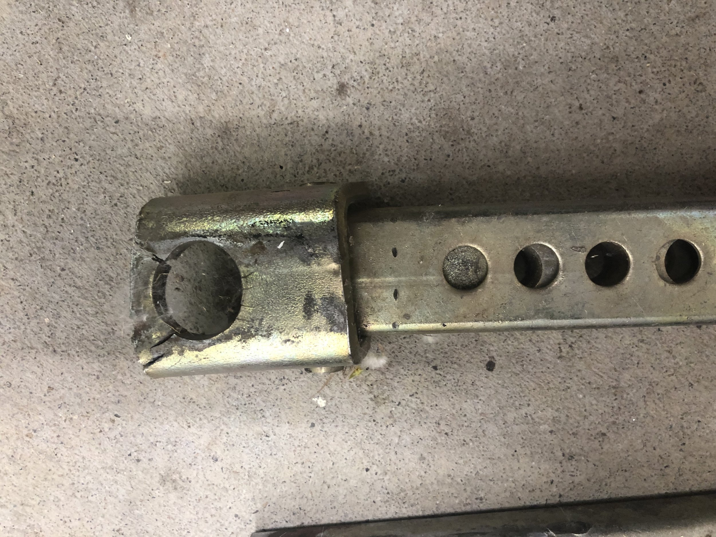

I have a 110 Tractor Loader Backhoe, I believe it is a 2006 if that matters. Has been a great machine and we mostly use as loader / forklift and backhoe. But last year my son used the 110 with implements for our old green tractor that isn't running. He used a tool bar with rips and a tiller. Unfortunately couple things went bad. He shrapped the outer PTO sleeve on the tiller so I will have to replace.

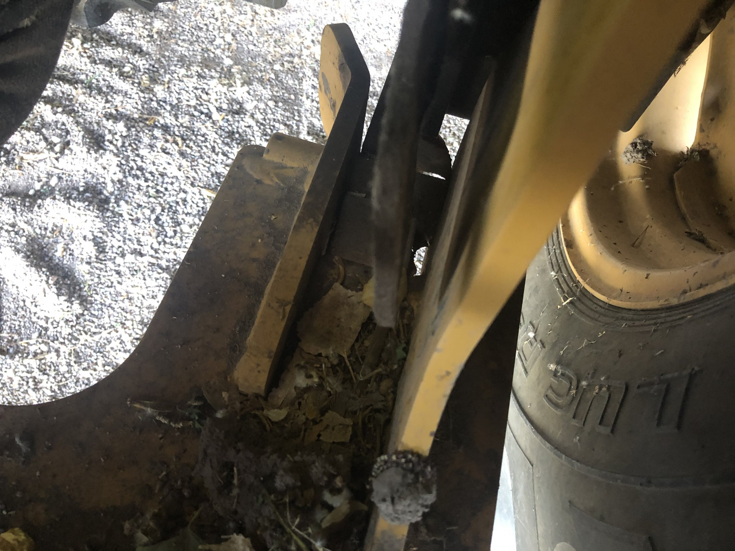

More concerning to me the implements slightly damaged the frame of the 110. Possibly this was because I had previously shrapped the anti sway things that came with the 3P top and tilt kit for the JD 110. Not sure on that, never did figure out how to use those things well and one of them blew apart while I mowed with a JD brush hog. A small auger and the big brush hog are the only 3P things I usually run.

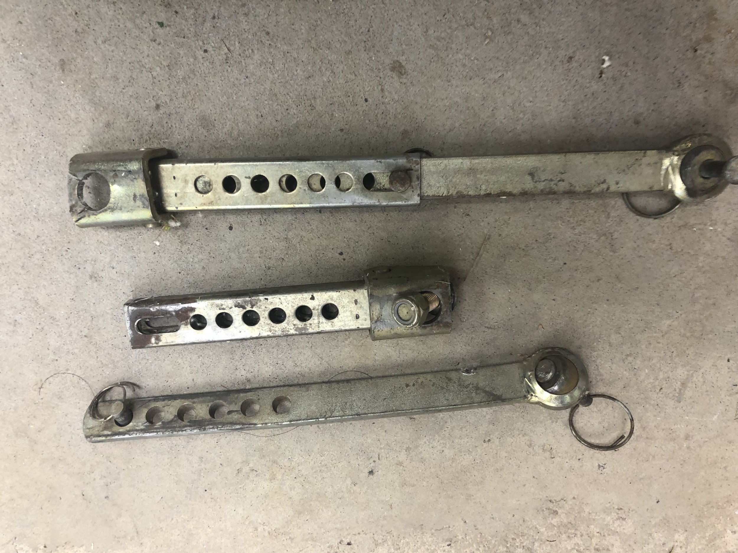

It seems like the implements are banging the lower arms of the 3P into the frame. They bent the rear most plates of the frame which then made it so the backhoe couldn't go back on. You can see in the photo the slot that this plate goes into to help align the backhoe as you back up to it and it got bent outward towards the Rt rear wheel. Left side same thing. We bent them back but I don't want to keep bending the frame. Is this just happening because I broke the anti sway things and I need to buy new parts and learn to use correctly? Or is it some other factor? Maybe there is a better anti sway solution now? 2nd and 3rd pics show the anti sway stuff I have and what I broke. I believe it is part # AM126933 for $118 at Weingartz. I see in their diagrams a couple of other anti sway setups that look different, not sure if those work on my year model or are better or worse etc. Thanks in advance for any help!

It looks like the implement was allowed to move side to side beating up the tractor. Was a pin inserted into the the stabilizer links (anti sway) on each side? (The pin locks the 2 sliding stabilizer parts together so they become essentially rigid.)

Some coincidence- I had a similar issue to yours just a month ago.
I've owned my 110TLB since about 2004. Until March I hadn't had the backhoe off for likely a decade. Took it off without much work, and I couldn't find my stabilizer bars. (just like the ones you have pictured) I bought a replacement set of chain style with turnbuckle and I like them much better.
I put a 84" box blade on the 3 point and went to work. Everything was going good until I tried to back up with the blade down to fill in a hole. The Cat 1 pin on my box blade was bent towards the rear, and as my 3 point lift arm pushed back it slide off the pin, breaking the lynch pin, and jamming the other side up and into the exact same frame component you're showing in the picture. Mine was bent considerably more than your photo shows. I tried bending it back, even tried using heat to help, but no luck. I cut the extension off with a sawzall. Backhoe installation was just as easy as before.
These are the stabilizer chains I used. Much easier to install and remove than the factory bars. Amazon.com: 159-425 New Universal 7/16" Chain Adjustable Stabilizer w/Nut & Lock Washer: Industrial & Scientific

I take the slack out of the stabilizers (by moving the implement side to side)before pinning them. Seem to work well.

Yes, you'll need 2. They are not left-right dependent. They are simple enough to install, but you'll need to cut a few links off each chain. I used a band saw. The opposite end bolts right up to your 3 point arm in the same hole that the factory stabilizers bolt.
There are no instructions with them.
