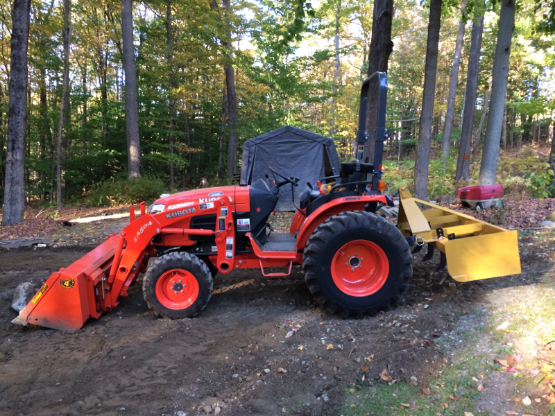

The Box Blade is no longer a virgin! I finally screwed up the courage to remove my backhoe to put on my box blade - it only sat on it's shipping palette for a year & a half!!
I worked on an area that's been eroding at the end of my driveway for a couple of years. I have to say, I'm pretty pleased with my first effort! There's great advice on how to use a Box Blade here on TBN!!!!
