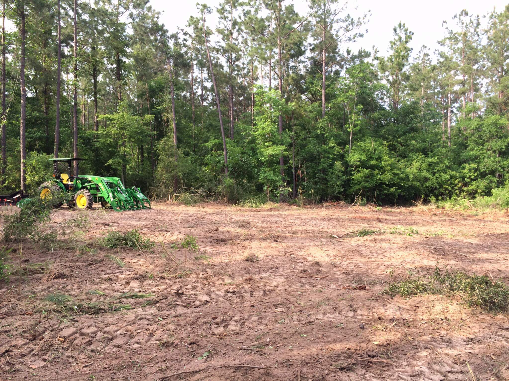

I bought a 5' County Line box blade from TSC this week, to go on my Kioti CK3510HST. I'd read that County Line box blades were usually made by King Kutter, but mine looks more like a Tarter. When I bought it, I was told by both TSC people there to "just set it level, put your 3-pt lever all the way down so it'll float, and drive". I did that on a test run on a fairly inconspicuous area and of course achieved less than stellar results. The info in this thread, along with numerous youtube videos by Everything Attachments & others, should help tremendously.
A specific question regarding leveling - our yard is about 1.5 acres of the 40 we own, has never been landscaped or even farmed; never had an implement on it until the digging that was necessary for our house build. The land has never been worked at all, is on a sloped grade (house with a walkout basement) and has a lot of rolling high & low spots that I'd like to smooth out. "Level" isn't really possible, as everything here is part of a slope that averages around a 3/12 pitch, but I'd like to smooth out the rolls a bunch. If they were more like piles (like dumped from a truck), I'd understand how to level them, but this ground is more slow-rolling (undulating?), like a relatively calm sea I guess is the best visual I can offer. What's the most efficient way for a box-blade noob to approach this kind of smoothing/levelling, when the undulations are so gradual & shallow?

Without knowing more about your land, I would disk or otherwise make it loose-surfaced, then drag a long beam, maybe 6x6x16, all over it in all directions. That would make it smooth without trying to make it level.
Thanks
Both KK & Tarter have been the OEM for County line at various points in time & various parts of the country. It could be either depend on when & where you bought it or how long it was in the yard. They are both lighter but decent box blades.
Getting things smooth (not level) is tricky without experience or a land plane. A box blade is really short. A land plane or the big road graders are really long for a reason. The length makes them move less in the middle when hitting a bump or a dip. If you add long skids or wheels behind your box blade it makes it act more like a grader or land plane.
A toplink is REALLY helpful for grading. I use my toplink more than my 3pt when working my box blade.
The good news is you own a tractor & box blade so you can get plenty of seat time to work on your skills. Take small bites & small adjustments to scrape dirt off high spots & move it to the low spots. In time you'll be able to fix the mistakes of the unskilled guy that started the project

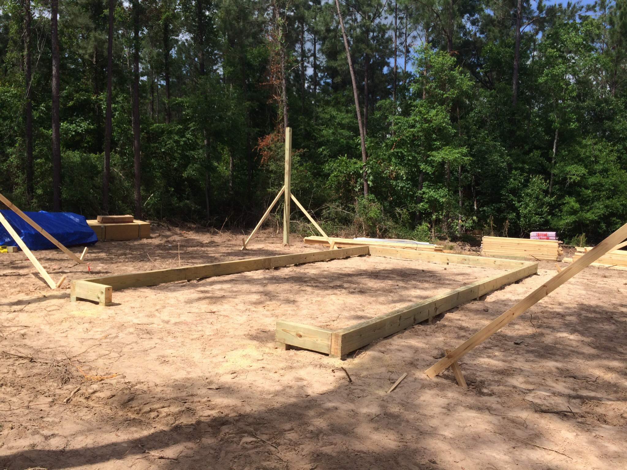

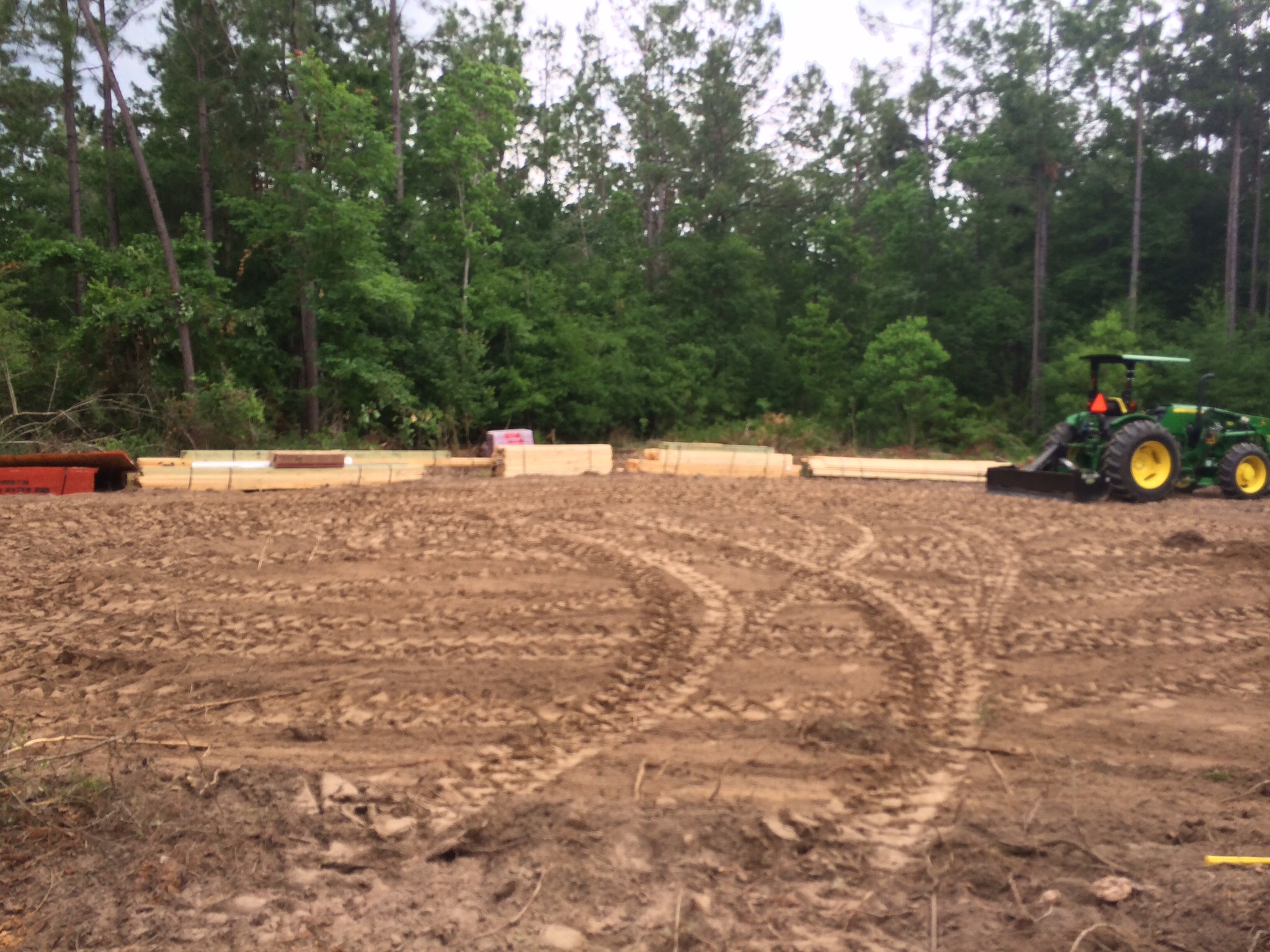

I got a super deal on a General-branded BoxBlade for my MT125. Thanks to learning curve it took a few hours to get the hang of it enough to level the area where I'm putting up a new shop.
