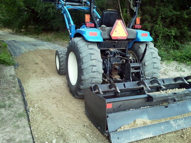

Just found this site and read all pages of this topic. I just moved from the city to this 25 acres in the sticks; I am new to tractors and just bought my first one, a Kubota L3400, which I got mainly for brush/fire controll. I am learning to use the brush-hog and front loader, but have found it difficult to do any decent looking grading/smoothing with the loader bucket. I know that a Gannon would work better for that so I came to this thread to get educated, before I buy the wrong thing. After reading up here, I have a better idea what size I need...looks like a 5 to 6 footer; leaning toward the 5 since my property and roads are very hard and rocky with the sub surface rocks running from fist-size to car or even house-size. The larger ones kind of determine the grade, so I am stuck with surfaces that undulate left/right as well as up/down. Maybe I could build up the bad areas with fill dirt, but that's going to take a LOT of dirt. I am old and my remaining years are no doubt short, so should probably stick to filling in the water erosion channels so that a 2WD vehicle can manage.
My tractor doesn't have a hydraulic top link; just a manual turnbuckle. It doesn't have hydraulics for operating Gannon scarrifier/rippers either; is it worth adding the hydraulics, or is it even feasible?

Steve, measure your rear tires outside to outside and go from there, ideally you would want to cover your tracks.

I am old and my remaining years are no doubt short, so should probably stick to filling in the water erosion channels so that a 2WD vehicle can manage. My tractor doesn't have a hydraulic top link; just a manual turnbuckle. It doesn't have hydraulics for operating Gannon scarrifier/rippers either; is it worth adding the hydraulics, or is it even feasible?
It is no big deal to add rear remotes:
Fit Rite Hydraulics - fitritehydraulics.com
Consider a Rollover Box Blade (ROBB) in lieu of a standard Box Blade.
Brian, who is FIT RITE HYDRAULICS, has several ROBBs.
ROBBs were designed before rear remote hydraulics came on the tractor scene.
At that time, the Gannon "Earthcavator" was the premier ROBB used in construction.
ROBBs are simpler to use than a standard Box Blade and require less adjustment.
ROBBs are heavier than the equivalent width standard Box Blades, therefore, unfortunately, cost more.
Personally, I seek/am attracted to simple solutions. In the case of a ROBB, you pay more for the simpler solution.

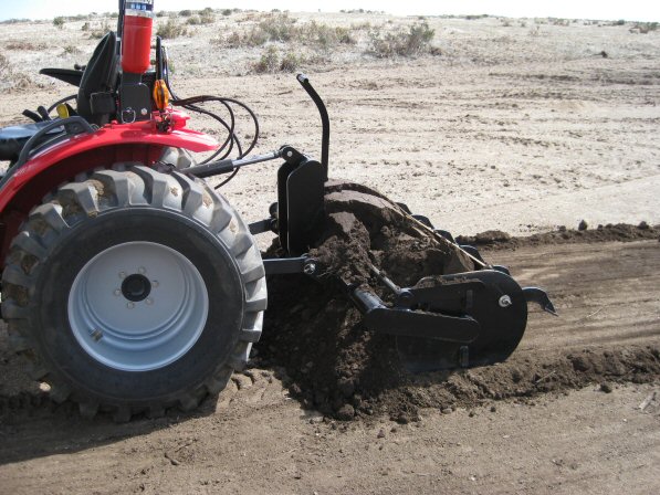

If the ground is REALLY dry, adobe, no Box Blade will cut. The ground has to contain at least a little moisture.

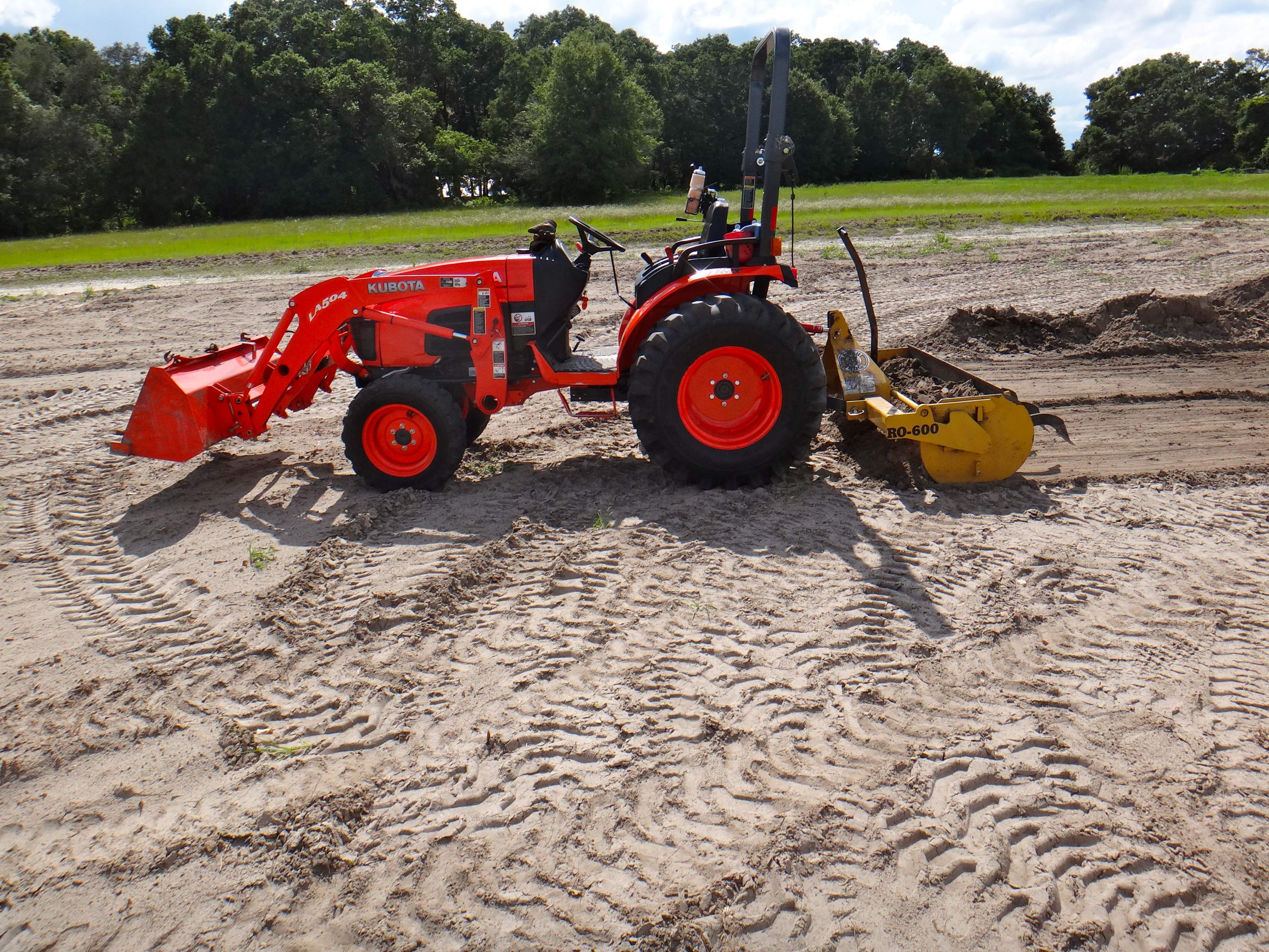

what is the correct width for a box blade? do you want to keep it right at the width of your tractor? I am thinking of getting one for a little BX25D Kubota, which is only about 45"s wide. I found a 42" locally, but don't know much about them, so i'm asking here. I just want something to clean up a long driveway, and spread gravel.
You might want to move this question to the Kubota board where more BX owners will see it and to keep this thread on topic.

I've heard of Skid steer, but not sure what they are; assuming they have tracks instead of wheels so you have to lock up one side to steer it.
Skid steers have the engine in the rear; they are fundamentally designed to PUSH.
Tractors have the engine in front, they are fundamentally designed to PULL.
Skid Steers are less versatile than tractors; you made the right selection in your Kubota.

Hopefully some of the Kubota owners can help with the ergonomic advice on your tractor. I have read where some of them can use their left foot to operate the treadle pedal when turned around in the seat, you might try this out. My brother had his right leg amputated below the knee early last year and physical problems can be a game changer. He hasn't been able to drive yet and I don't think he is ready for that anyway. Growing older isn't fun. Not knowing much about your physical condition I will say that mirrors, back uo cameras and other fixes can help but at any rate you need to be able to see what is happening all around your tractor.
The point about skidsteers is that you face the attachments in operation and can use mirrors to backup.
