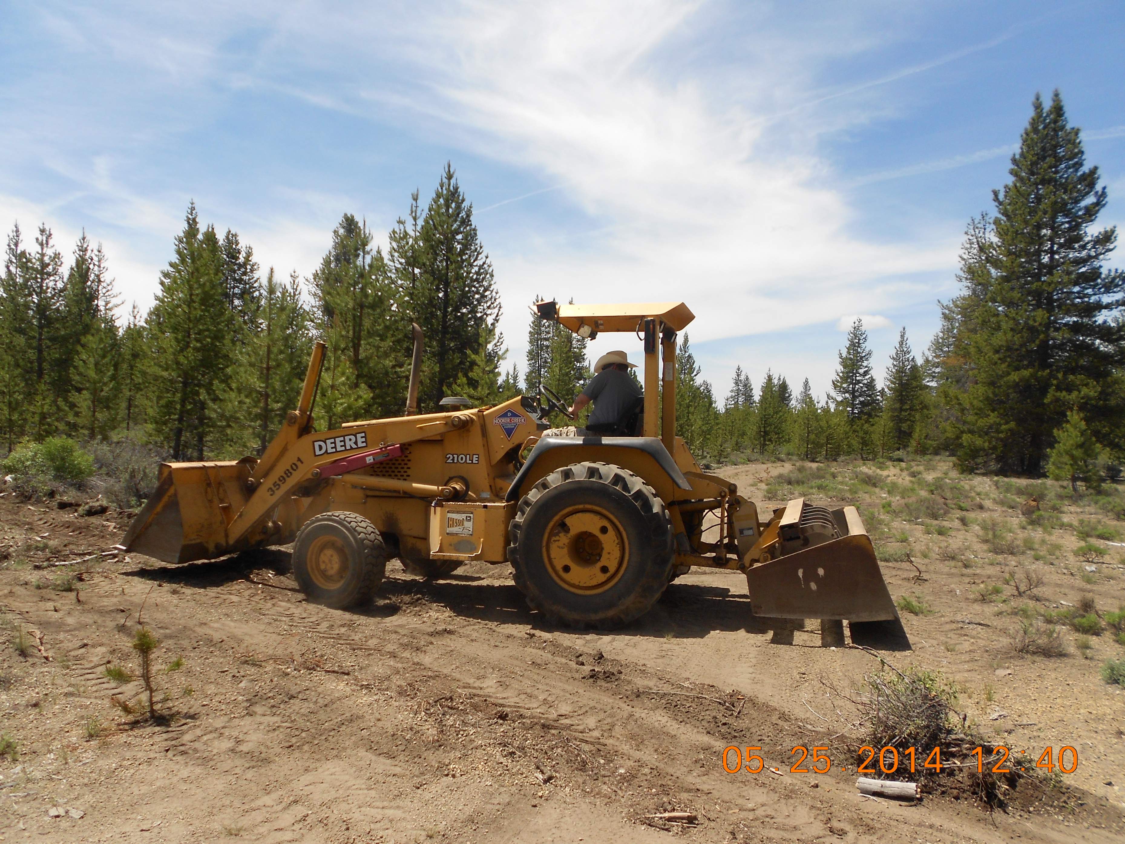

I recently bought my first tractor. It's a JD210LE. L for landscape. This thing will do far more than I know how to do, so far. All hydraulic for an old man. I used it a week ago to clear a small area to drop about 60 cu yds of seasoned manure. Haven't even had a chance to do a little maintenance on my roads that have a middle hump. I have 160 acres and need to cut/clear the fence lines and a few roads. Now I'm a lot more informed. Have plenty of small diameter trees (non-address overgrowth) to clear at the edges of the present roads.
I am lucky to be a bit **** about trying to do research before heading off to do my work. This thread is now 11 pages and I've read every page. Now I have to learn to level the box and make it all work the way it was intended. Getting the equipment level from the seat is a challenge I have to learn. That includes the FEL. So far, it's a challenge to learn how to get the bottom level with the ground. But as is normally the case, we learn. Thinking of adding a piece of 2" receiver at level to help me determine when the bottom of level and I can add features like trailer balls to move various trailers around.

My thought is that a 210 is the best thing to use for box blade work. I would reiterate that moving slow enough to have time to adjust the box position is very important.

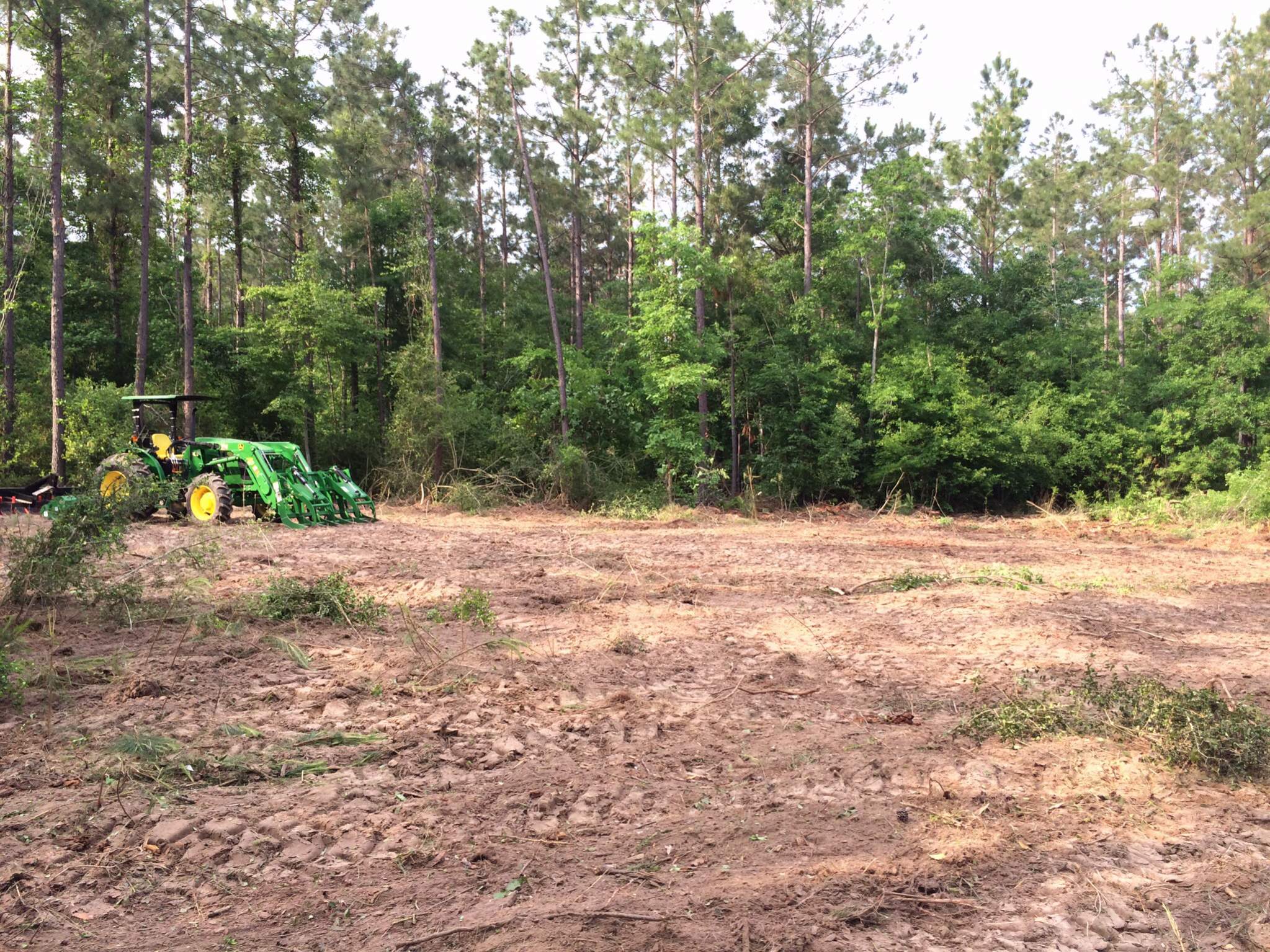

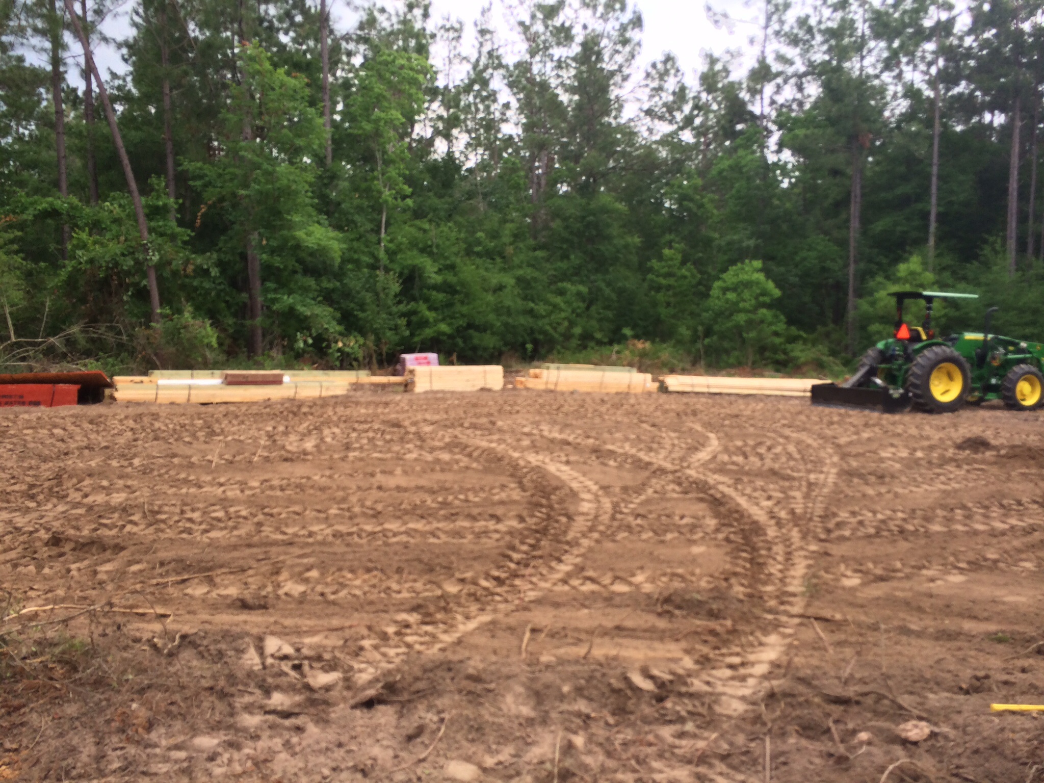

Just a quick thanks for this informative thread! Had my first go at a box blade yesterday

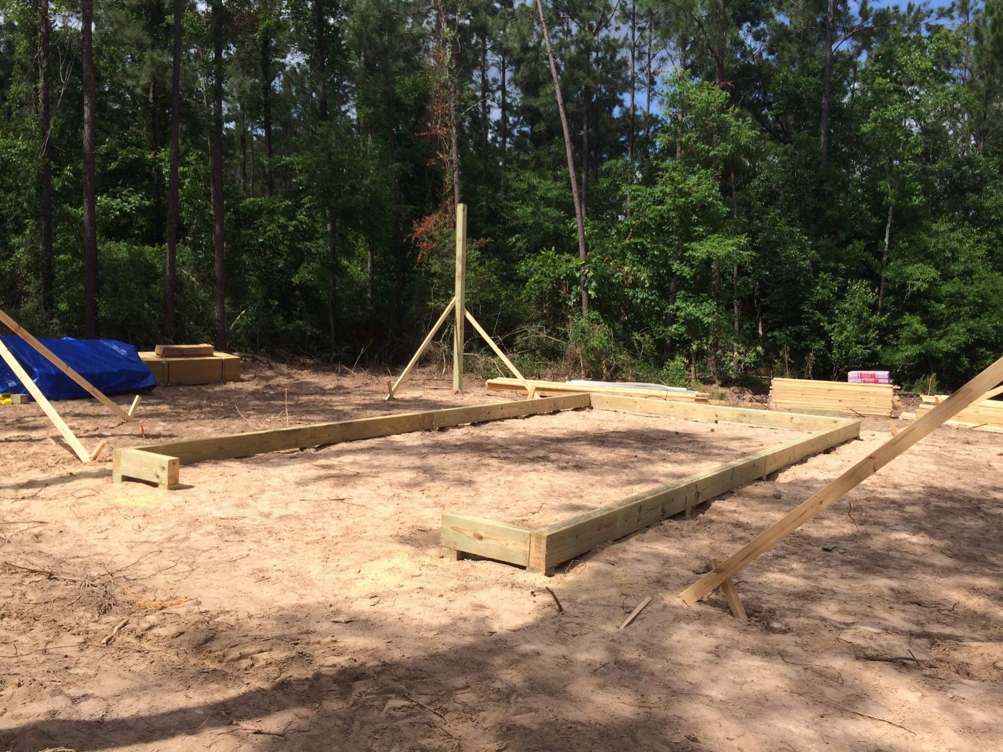

Putting in a barn/shed. Can't see from is picture, but about 8-10in elevations change.
After running box blade. Rippers down top link short, ripper up but top link short, finally lengthen top link to smooth.
When I laid out foundation beams, site was within 1-2 inched from to back.
Did bend three rippers on roots though

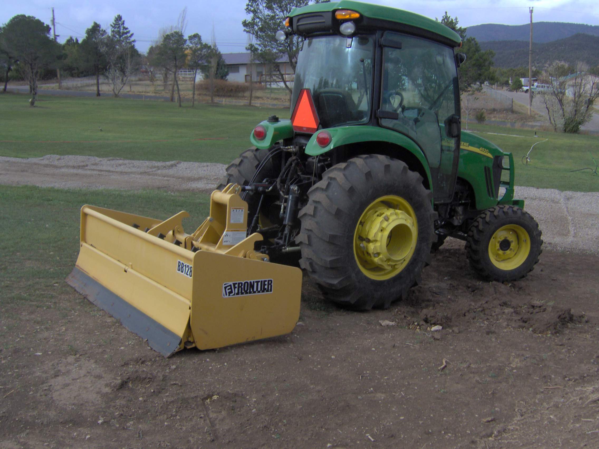

Yesterday was the first time I was able to do a little work improving and widening a couple of roads on my property. Looking forward to starting to clear a place for my house and outbuildings. Thanks to this thread, I feel I'm getting the hang of it.
Thanks to all contributors.
Also bought a monster Ratchet Rake for my front bucket. It'll help tremendously in removing a lot of small trees and brush. Now the real work and real fun starts.
/ Beginners guide to using a box blade #118
That is quite a bit of wear on the sides of your box blade. Might wan't to add some more metal there when you have time. Nice rig though.
That is quite a bit of wear on the sides of your box blade. Might wan't to add some more metal there when you have time. If you have to pitch the blade forward to hold the dirt in the box it makes the blade angle very steep. I think you could add the steel plate to your remaining sides rather easily. Nice rig though.
Notice in the picture below how much longer the front leading edge is on the sides.
