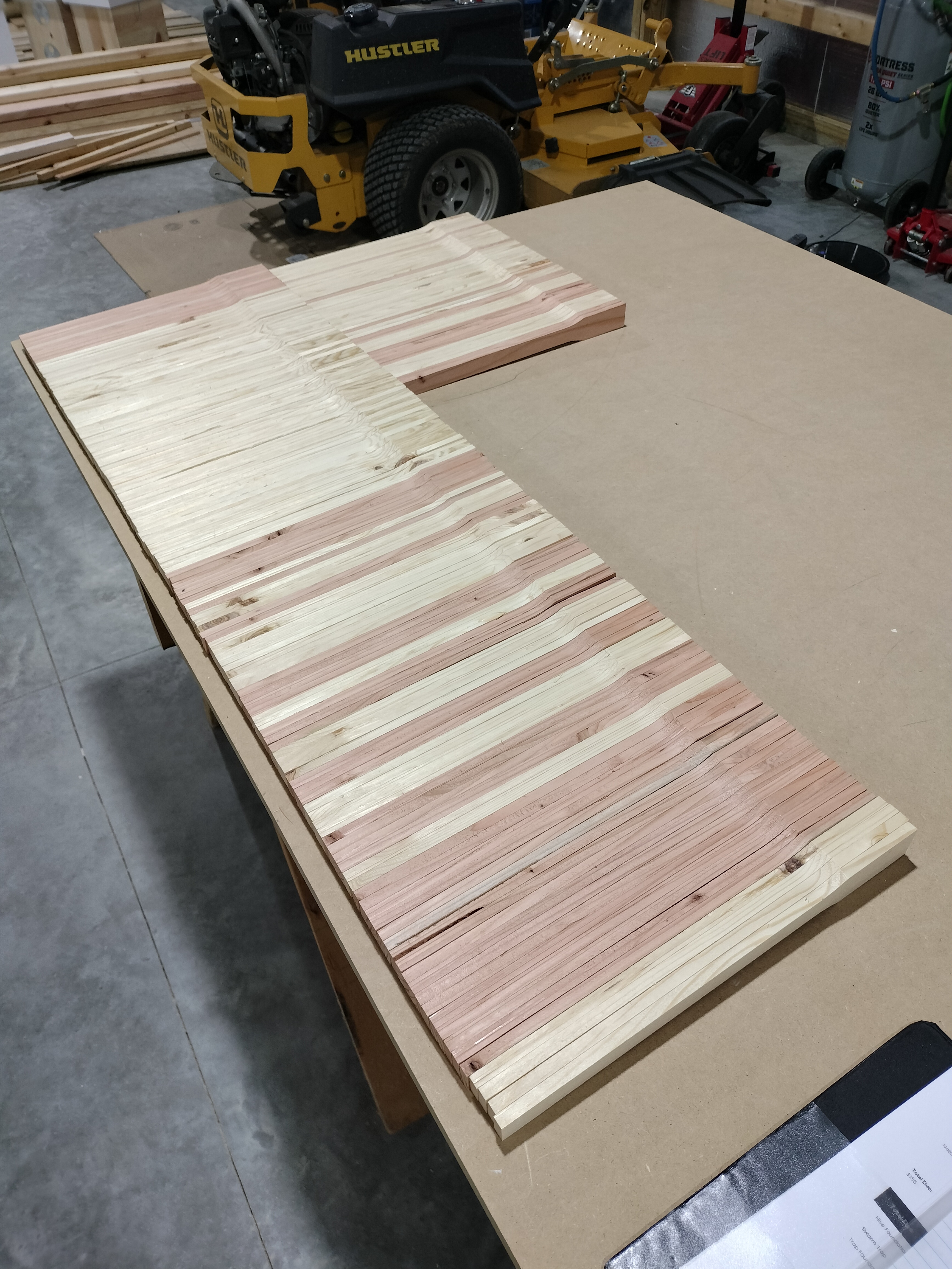

Thanks. That sounds far more efficient!
I leave a couple thin strips on each side, to stabilize the board as I carve out the rest of it. I also run the board through a planer first, to make sure they are completely flat on each side, before I start, and exactly the same thickness
/ Beekeeping #513
2x6, I lay on its side, and taper with a 1” wide dado blade on a table saw. Then rip into 3/8” bars
Do you have a photo? I'm sure this is obvious, but I'm having trouble visualizing it. 2x6x30"?, 6" side flat on saw?
All the best,
Peter
Yessir, they are about 16” in length. So the 6” flat is laid down on the saw. The dado bade .25” depth of cut. I have a mark on my fence so that I know where to stop the taper. I don’t have a photo sadly.
Thanks! I was a bit curious on how you were executing the stop of the taper. I'm impressed at the repeatability, and care of your work. The SOP binder seemed very en pointe for a former pilot somehow, at least to me. (I'm not a pilot, but I am a fan of the training and SOPs in use in aviation, especially the flight deck.)
