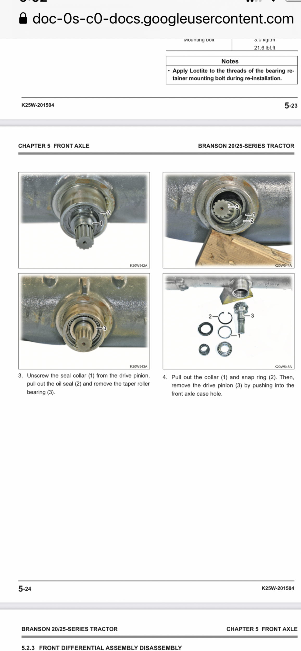

I have 2017 branson 3520cx tractor...the bearing on front axle is shot on piinion shaft i was able to seal out...now bearing stuck on shaft...Any suggestions how to get it out..thank u

I think this is what you are talking about. There is a snap ring behind the bearing. Looks like if you took a block of wood and place it on the shaft and tap it with a hammer the bearing would come off. See screenshot below. Hope this helps.
Think ur saying hit pinion from front...and snap ring might break...i cant get to snap ring from front it blocked by seized bearing
/ Bearing removal #8
Yes I am saying put a piece of wood on the end of the shaft and tap the wood with a hammer. The snap ring should not break. The snap ring would hold the bearing and shaft should go inside the housing. Then you can remove the bearing.

I like the word tap. Lol But tap on the end of the shaft driving it into the housing. See arrow on drawing below.

I believe it should rotate off the ring gear as it goes in. That is why tap is better than pound. Lol

well i tapped for 10 mins shaft never moved to front..pounded few times..how far should it Move...thank u for assistance

Is there a way you can post a picture of the bearing and shaft? I would not think it would need to move much before the bearing gets free.
/ Bearing removal #16
You may have to remove the differential case first. I was hoping it would move in enough to free the bearing.

Think i got bearing out but i dont see no c clip to get shaft out..less still part bearing left in..i had to split bearing to get out..lol i might be over my head

It definitely looks like the outer race is still in there. You may be able to pull it with a slide hammer but catching just the race and not the snap ring will be a challenge.
