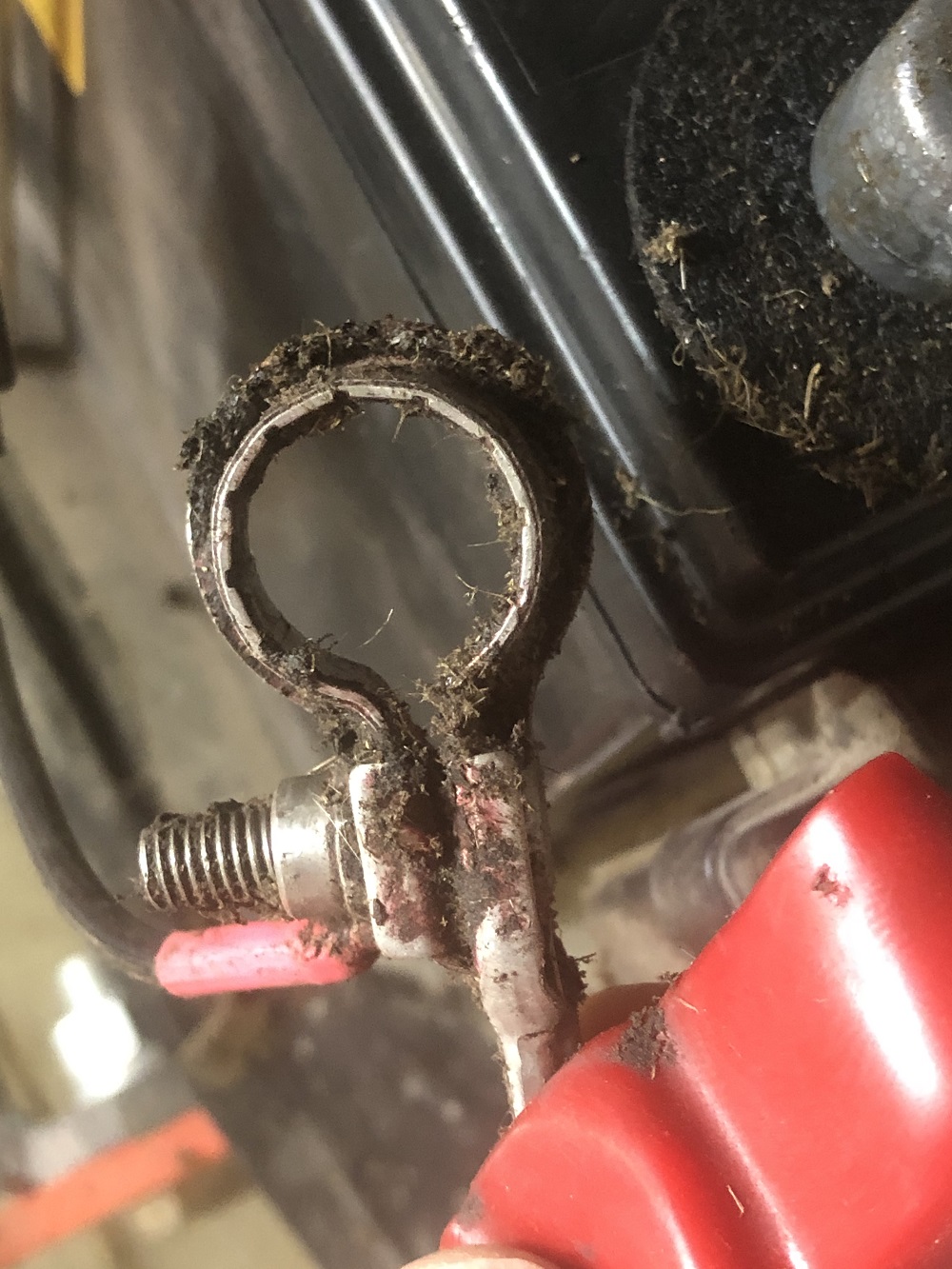

On my B2650 the battery terminals or to loose even with the clamp tighten all the way. How does one fix the issue?

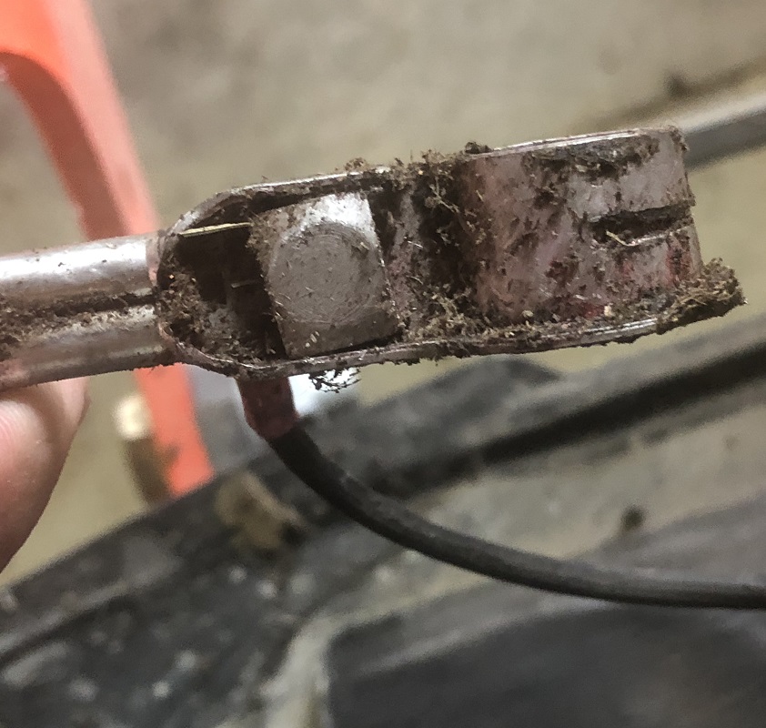

Is this the normal way kubota does this? There is no nut on the end like the - - terminal, i have to bend it to be able to turn it.

Look more closely at your second photo. See how the flats of the nut are almost hidden by the battery terminal? You have the proper nut on the tightening bolt. The problem is that someone in the past has taken that nut off and put it back on the bolt wrong end first. Unscrew it and turn it around. You will then be able to tighten the clamp properly.
You have all the proper parts right there, and the terminals are not showing enough corrosion to need replacing. Just turn the nut around.
How do I know that? Well, I made the same mistake on our Kubota & couldn't figure out why it didn't tighten properly....
rScotty
I did notice that after i took the pic but couldn't get to the nut to unscrew it not sure what the size is looks like a 10mm.
