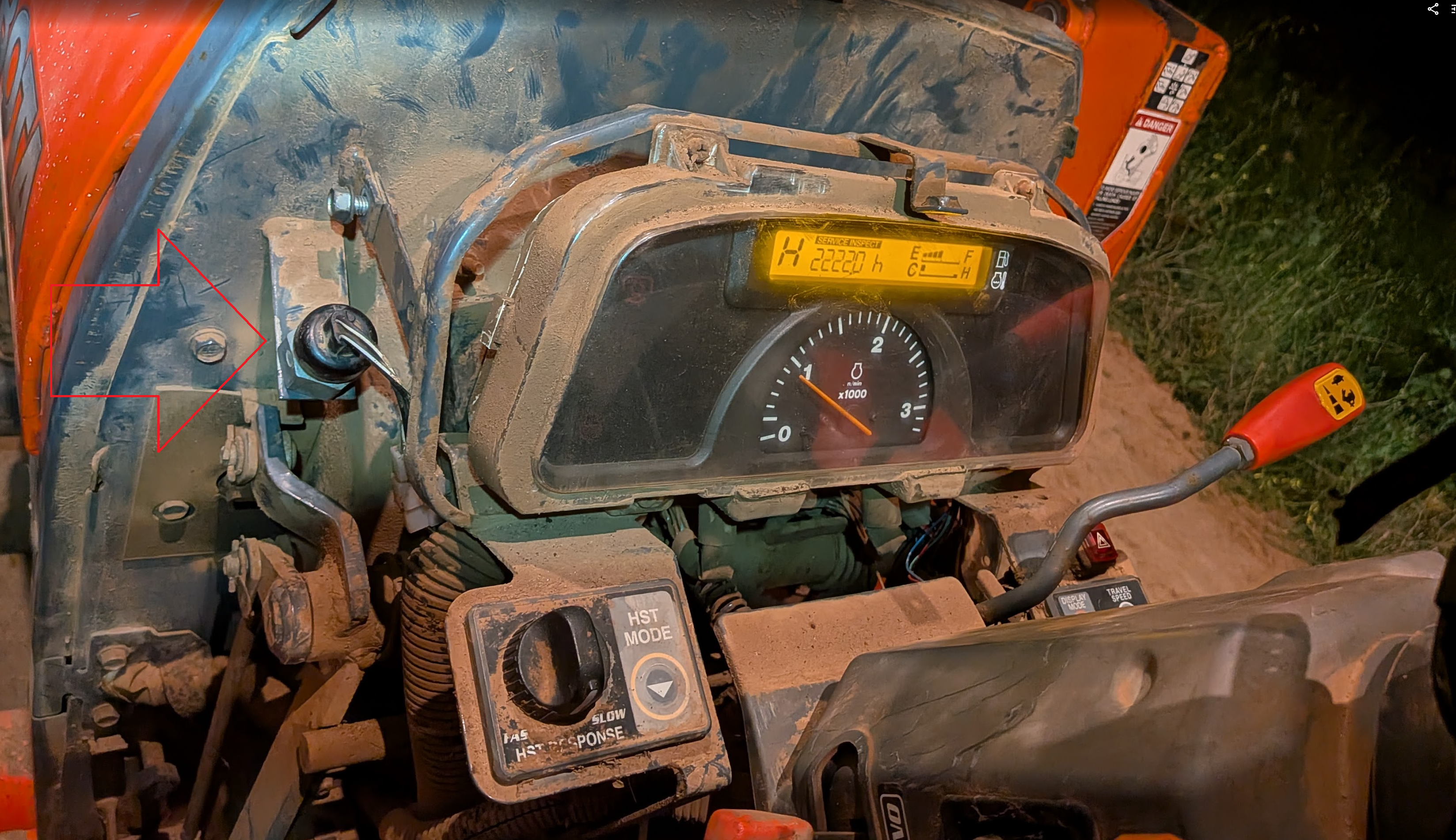

L4740 HST, DK65S
Tractor would not start and display was off when key turned to start
Found red wire to ignition had corroded and detached from plug
Fixed that but still would not start
Replaced ignition switch and now tractor starts but will not drive in forward or reverse
Hydraulics work and revs normally
Display shows L M H when shifting gears but does not show turtle- rabbit fine
Fuses around clutch and on battery all fine
Went into service mode and transmission set correctly to HST
Error code 84 (throttle sensor) was in history. Cleared it and it has not come back on
Any ideas?
/ L4740 HST wont drive
#2

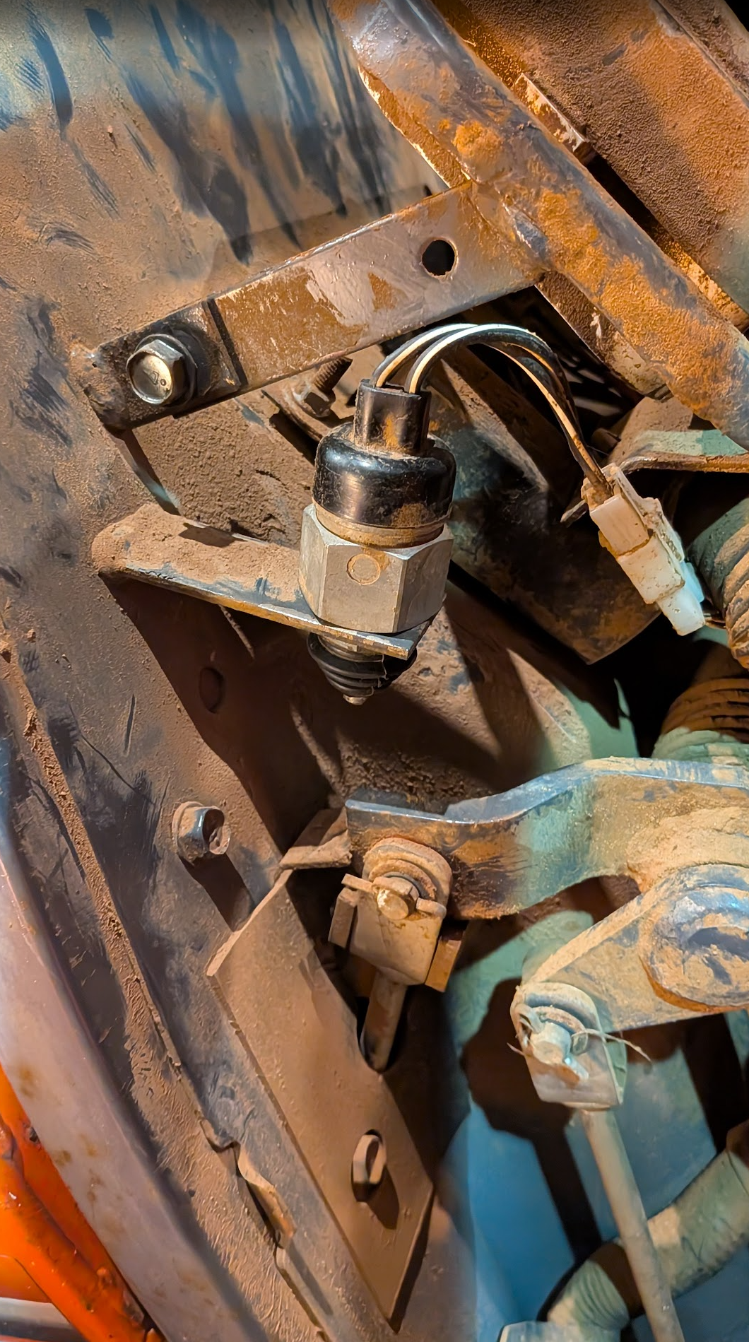

Ok, solved my own problem
Since I had the cowling off, I decided to bypass the stupid clutch safety switch with baling wire
I assumed everything was fine because I could start it without climbing up onto the seat- that was great!
Nevertheless, returning the switch to its normal position solved the travel problem, although I still dont understand how
I'll have to find another way to bypass the switch because the convenience was significant
Has anyone successfully bypassed the clutch safety switch?
Turns out it has to be depressed to start the tractor but released to drive it
