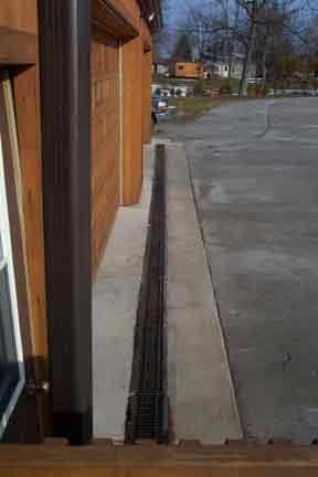

Can anyone give me a model number and supplier name for the drains they used in their barn floor? I am having trouble finding exactly what I am looking for: 9x9 metal grate with a strainer that hooks up to PCV pipe. Bayrat and rbargeron
mentioned something like this. So far, all I have found is 100% plastic or made for highways/airports.
/ Barns and shop layouts #74
Hi Peter - my floor drains came from a concrete supplies place (they cater to masonry contractors) - no name on them.
They are cast iron and pretty thin - I've broken both grates - looking for something a little stronger myself - will probably make them from plate with holes drilled. I find they don't need much inlet (hole) area. Hope this helps.
/ Barns and shop layouts #75
I was at J.C. Cornillie's last night and thinking of your question, asked the lady about that and she replied nothing that she knows of. Her only answer was the same as I was thinking, is a concrete crock buried under your slab with hole cut through side by you and pvc cemented in. Just like AndyR's project
Or how about a long drain using metal grate available at a lot of steel supply places, there you need to form your own catch basin and pipe in place before pouring.
