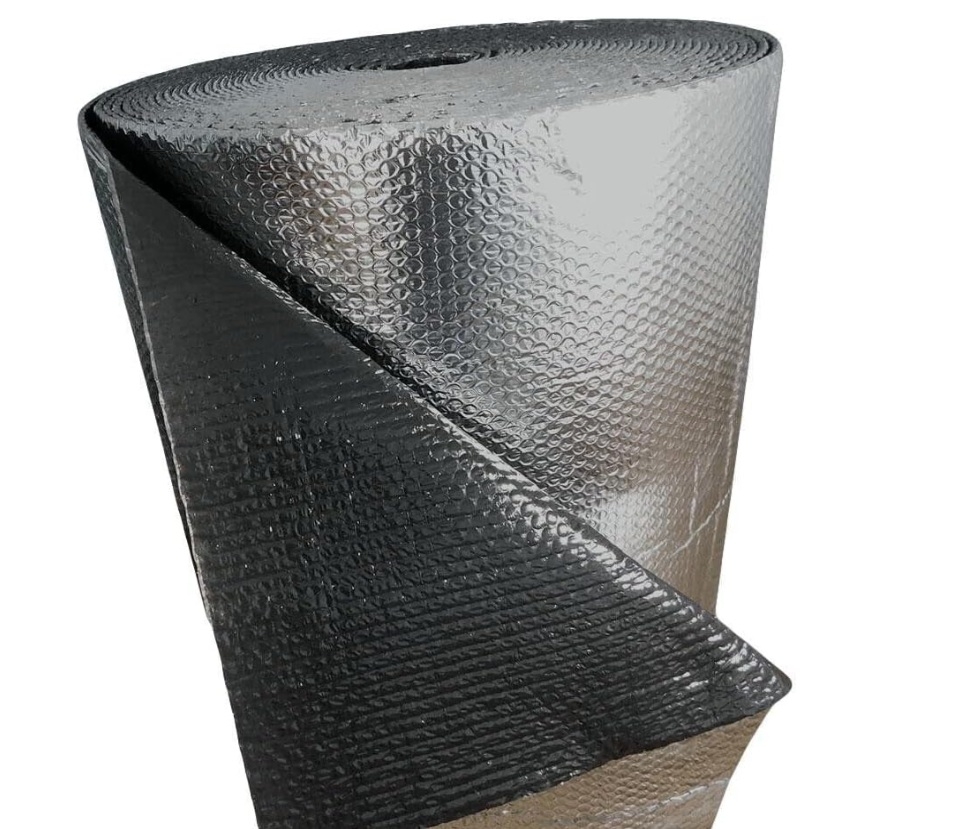

After the tubing and plates are all installed, I will be stapling "foil bubble wrap" to the bottoms of the top chords of the open web trusses, creating a 1.5" air gap. So the subfloor plywood is heated both by conduction and convection. Still not as efficient as tubing embeded in concrete but better than hot forced air into rooms via a furnace, blower & ductwork etc.
   / Barndominium/Shop or "real" House? #747
Does the foil bubble wrap dry out and crack over time? I've seen that in pole barns, but I'm not sure of the brand or if there are better types of it out there.

The water heats the pex tubing -> the pex tubing conducts heat to both the sub-floor and aluminum plates -> the warmed aluminum plates and the plywood sub-floor radiate infrared light downward away from their surfaces -> the foil bubble wrap reflects that infrared light back up towards the sub-floor and plates adding additional energy. The infrared light will bounce back and forth between the plates and the foil, but some of that energy gets absorbed by the plywood subfloor, some of it diassapates into other parts of the structure like the open web trusses and is lost via conduction out to the OSB sheathing and then the steel siding which is exposed to the outer elements.
The foil bubble insulation R value is pitiful, only like R2, but, the foil radiating the infrared light back up is the important part.
Underneath the foil bubble wrap will be fiberglass insulation to keep heat in the shop & garage produced by the pex in the concrete floors. Some of that heat will of course migrate up and heat the rooms above.

Your understanding of how it works is a lot better than mine.
I've read a little on reflecting light for heat, but I honestly don't believe any of it. I'm very basic and simple thinking. Sometimes that works for me, sometimes it ends up costing more, taking longer and nothing is any better.
My brain is telling me that I would want to stop every bit of heat leaving the PEX that's going downwards, away from the floor. To me, it looks more like you have a radiator type design that will cool the PEX with air all around it instead of a heater that will focus the heat where you want it.

This is the same stuff I have in my metal shop building. It does a really good job keeping the heat out in the summer time. I could see how this would be good for reflecting the heat back up to the floor. But you are correct about the R-Value. It's not really any insulation at all.

Well, heat is light, it's just light you can't see. The foil still reflects it etc.
If you fill that cavity with foam insulation, you're conducting more heat to the truss lumber then to the outer walls of the building.
Having that air gap and the foil reflectance parallel to the sub-floor above it puts more of the heat into the plywood.
Also, having bubble insulation that is black on the bottom side and silver on the top will absorb any heat from the garage/workshop below that makes in through the fiberglass insulation then radiate that heat towards the plywood upper living space subfloor.

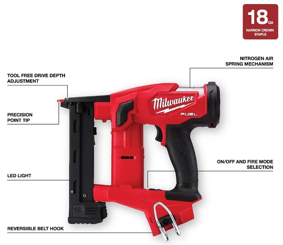

#755
I'm not finding any T50 staple guns that have depth adjustment other than how hard the hammer hits.
I'd have to step up to a 18 guage stapler such as the Metabo: Amazon.com : narrow crown stapler for mechanical depth adjustment.
I'll have to think about that. So far any instructional videos I see on these transfer plates are guys using a T50 cordless stapler. Mine does have an adjuster for how hard the staple is whacked, but it seems like the issues are the varying density of the OSB and the lack of a chisel point on staples with legs greater than 3/8".
Also, those 18 GA staple guns either pneumatic or cordless are way bigger than the T50 gun I have now, I won't be able to fit it next to the open web trusses to get a straight shot through the plates.
Interestingly, the website I bought the plates from state to use T50 3/8" leg staples with an electric stapler or T50 1/2" leg staples with a pnuematic stapler.
Just seems like with an electric staple gun the 3/8" chisel points are a must, any longer there is no chisel point and they just don't drive into the OSB reliably.

T50's don't have depth stops, as far as I know. I'm speaking of pneumatic 18 gauge staplers (or passload equivalents).
There's no problem fitting them between joists, mine is only 3" wide. I have staped many things just as you show here, you just hold it in-line with the joists when firing your staples.
It's an option, since you were describing problems with driving the T50's, and the 18 gauge staples will hold better into OSB. But if the T50's are working for you and you already have the tool, then carry on!

Yeah, maybe the pneumatic ones are smaller. I'd probably be looking at a cordless.
Which is too large for the area I have to work in.

I think you'd be fine. I get mine into spaces much tighter than that.
Like I said, it's an option if your T50's aren't working out. But if you're happy with the T50's and aren't looking for an excuse to buy another tool, then stick with what you've got!
One big advantage of the pneumatics is hand fatigue. I've squeezed off a lot of T50 staples, and I usually start to get blisters in the webbing between thumb and index finger, after awhile. The pneumatic stapler is a light single-trigger pull.
