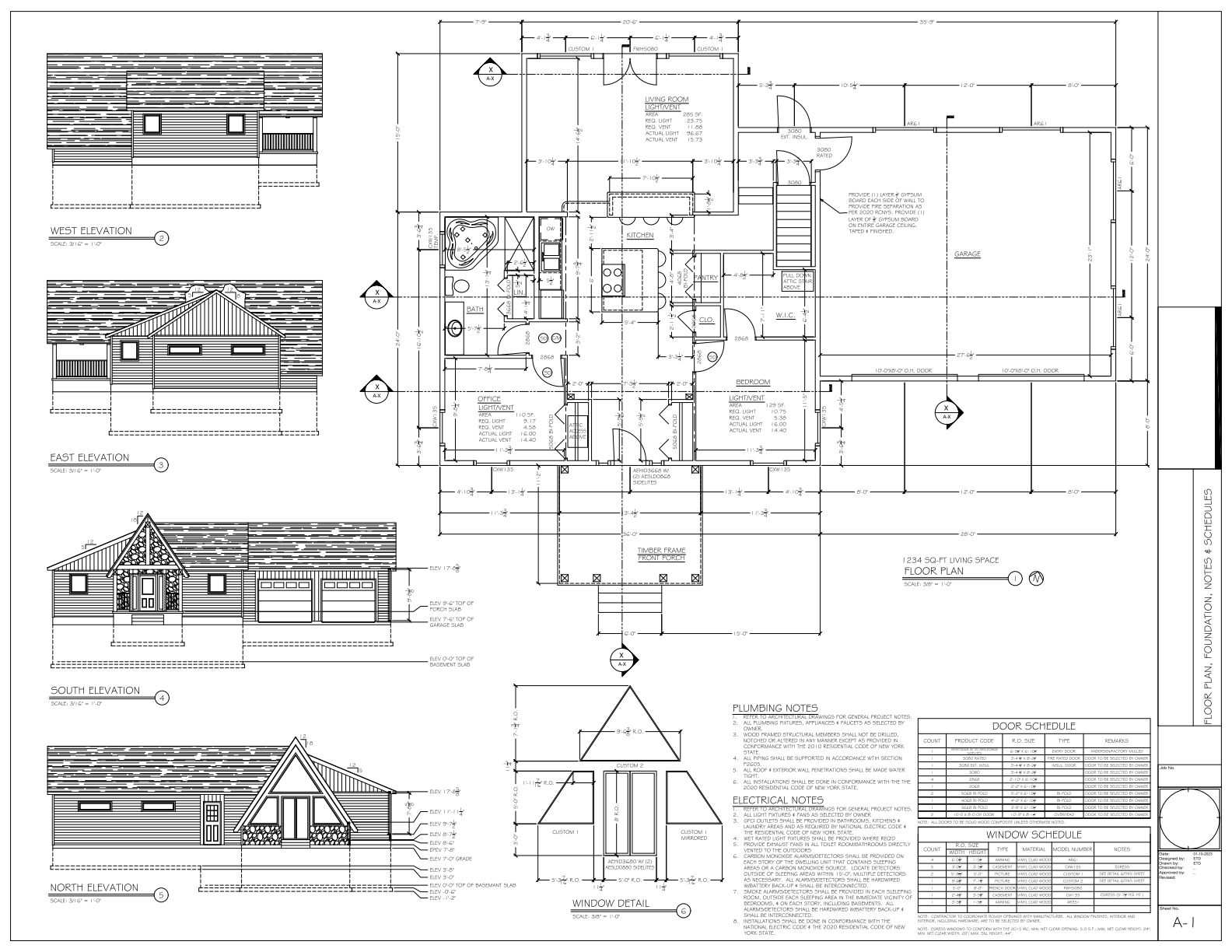

What is the advantage to 8 foot tall garage doors? Seems like a huge expense making the entire building taller, and paying more for 8 foot tall doors over the standard 7 foot tall doors.
My ten foot wide, 7 foot tall, insulated doors are almost $1,700 each for just the basic doors. I haven't decided on the openers yet.
/ Barndominium/Shop or "real" House? #182

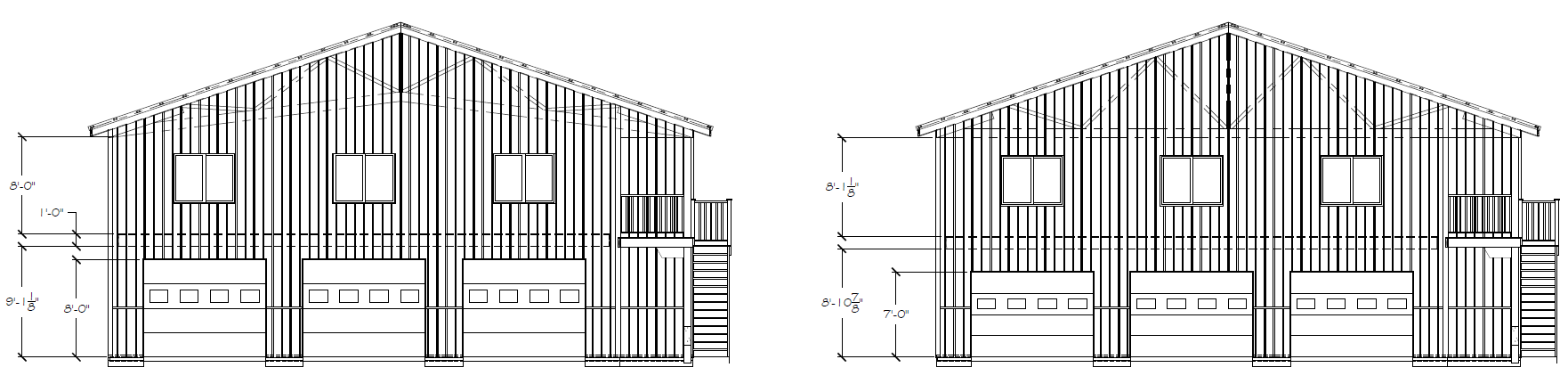

Not that much change required for 8ft doors. Seems like a no-brainer:
I wasn't paying attention to the inches in the two drawings. It looks like the overall height of the building is increasing just a couple of inches to get the 8 foot tall doors. Not as big of an expense as I first thought.
But I still don't see the advantage to spending the extra money on 8 foot tall garage doors

Again, in the OP's case all he did was redraw the door openings. This is based on his comment and his drawings. So in his case, why would he put in smaller doors?
The overall building height didn't change. I moved up the floor for the living space which made those celings less than 8 ft, so I put in scissor trusses to gain taller ceilings in the living area.

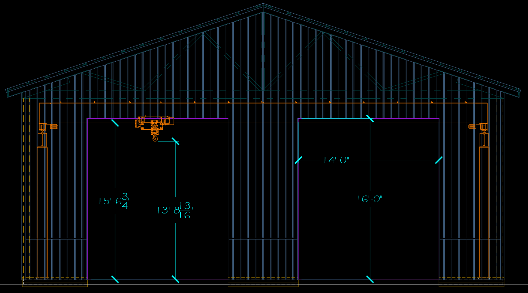

Laying in a 5 Ton Bridge Crane:
Normally the crane columns are tied into the wall columns of the building for anti-racking support. Not sure this can be done with a wood post & beam frame building? Normally these are installed in steel buildings.

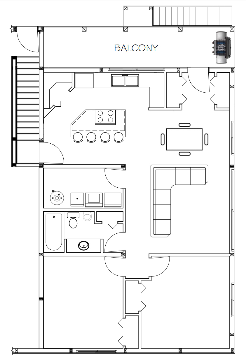

When I saw you fantastic crane I got this crazy idea while thinking of the difficulty of moving your furniture upstairs ...

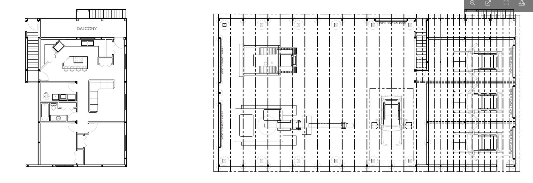

That closet arrangement does look better. I was not a fan of the way I had the door to the balcony all the way in the corner.
For the stairs I didn't have a door like you show because I wanted to pull the wall back toward the north and have a removable railing for furniture moving. However a door for the stairwell might be a good idea to further isolate the shop from the living space.
/ Barndominium/Shop or "real" House? #197
I figured if I took the stairs out of the well and put them on the east wall of the shop you'd have more room to sort things out 🙂

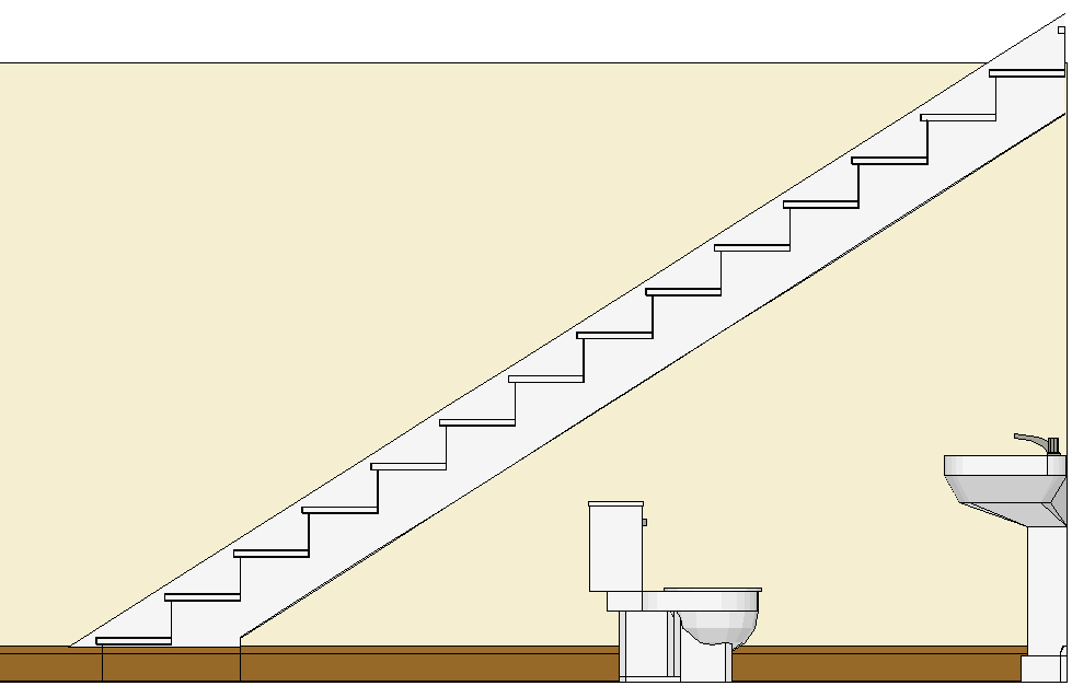

/ Barndominium/Shop or "real" House? #198
Still need to put in the shop bathroom.
A toilet and sink would fit nicely under a relocated stair case on the east* wall of the shop and tie in easily with your existing plumbing.
*I said north wall but I think it's east.
#199
I figured if I took the stairs out of the well and put them on the east wall of the shop you'd have more room to sort things out.
Yeah, my design started out that way but I moved them in to reduce the square footage. Taxe$$$$...
