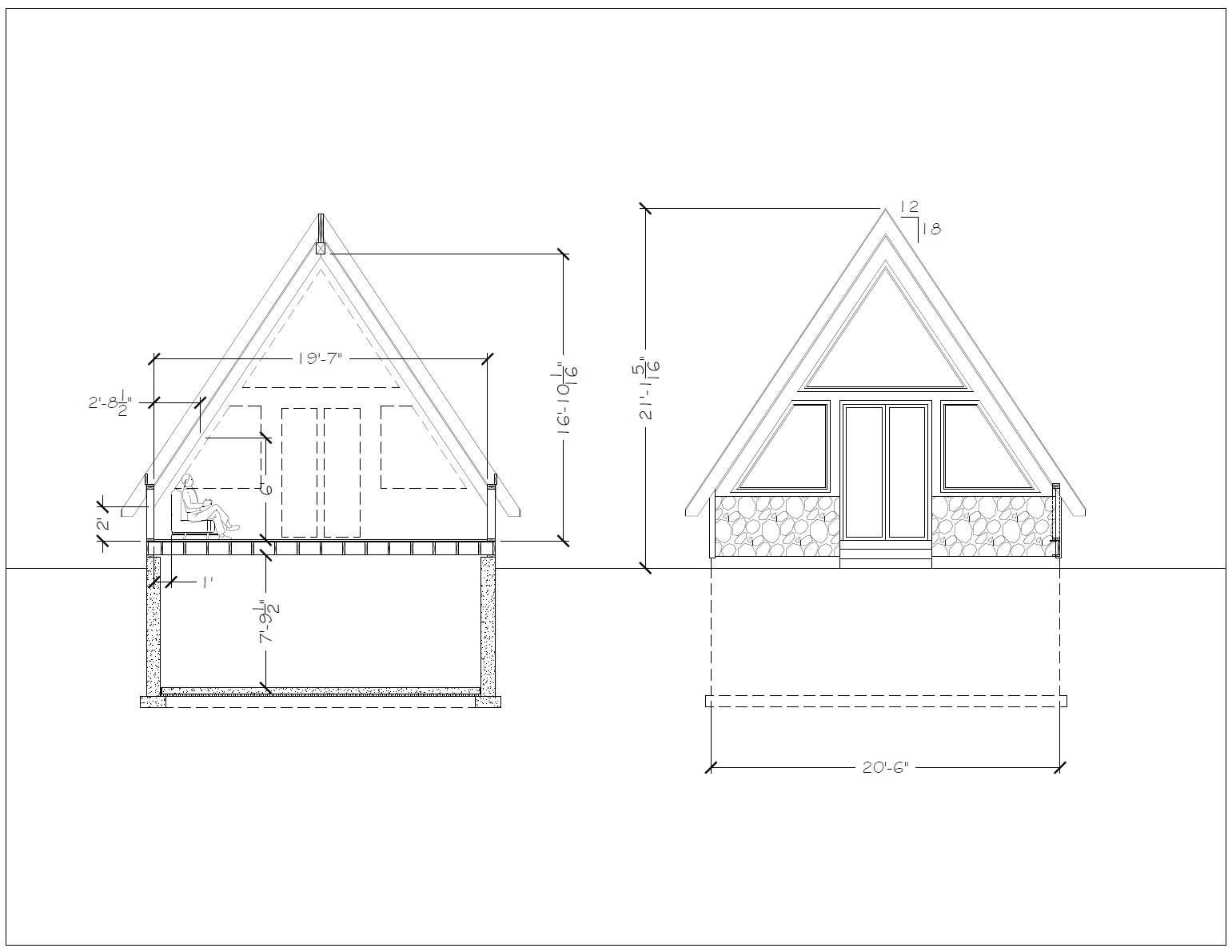

Working on section views, and am on to the A-Frame living room. I don't want to do knee walls because I think the windows look better on the outside non-truncated. I laid out a dude sitting in a chair 1ft from the wall. I'm 6ft tall and I guess the 8X6 decorative beams could be an issue? Maybe not so much for walking but getting in and out of a chair.
Anyone have experience with an A-Frame house or cabin?
In your picture/drawing on the left: My brother has an A-frame house. His couches sit a bit away from the wall in comparison to my couch in standard house build. His recliner sits out like mine. I am about 5'8" and don't have a problem sitting down into couch. Also I don't think people sit down with a straight vertical back, I know my back is usually curved forward to balance myself as I sit down. Along the bottom portion of the roof line behind the chair back area are cabinets. Never looked how deep they are. And his roof line guessing goes down to within 2' of grade level. Where yours show 2' to the floor level. Not sure of his roof pitch. Jon

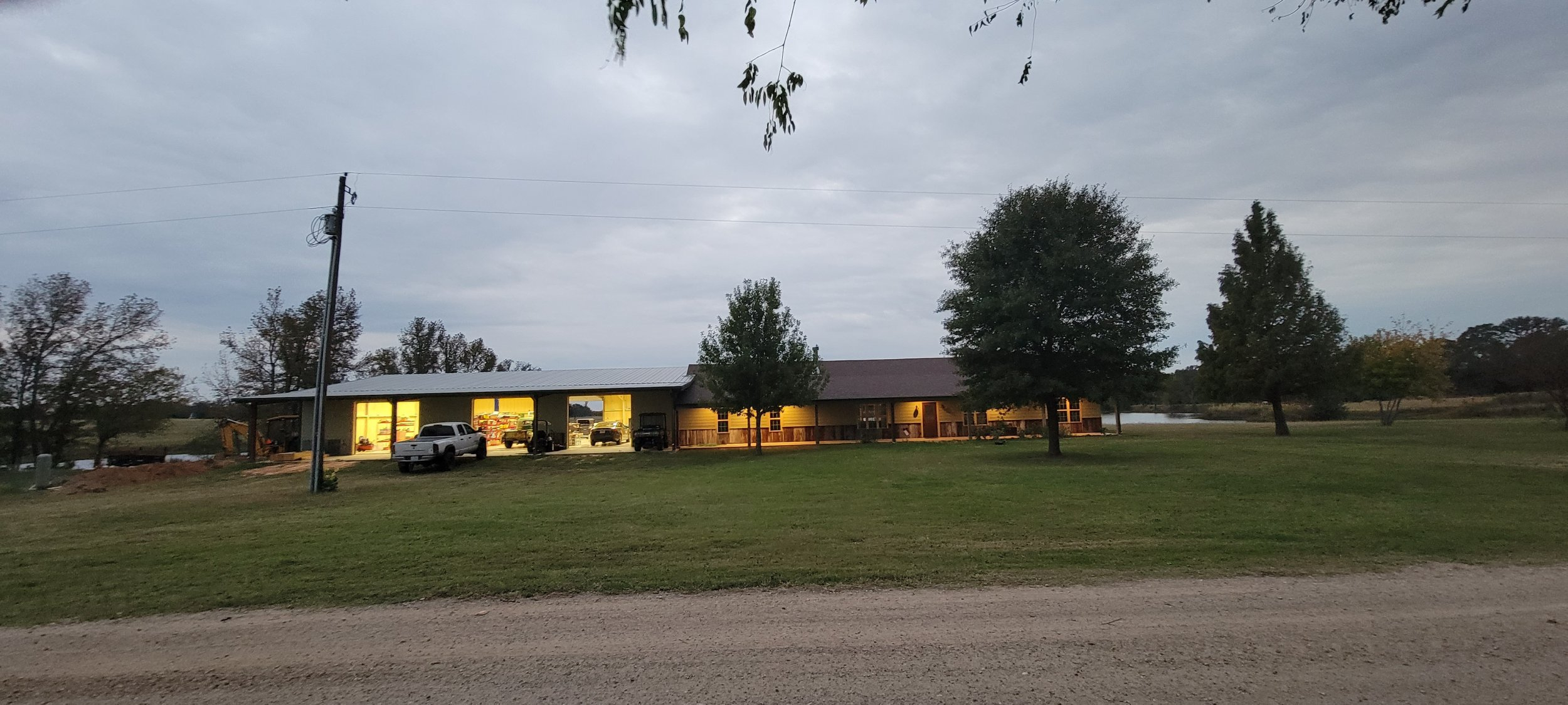

We are at about 7500 a year but next year I'll be 65 and the taxes will no longer go up. I have a 4300sf attached metal building shop and about 3000sf home... standard 2x6 construction.

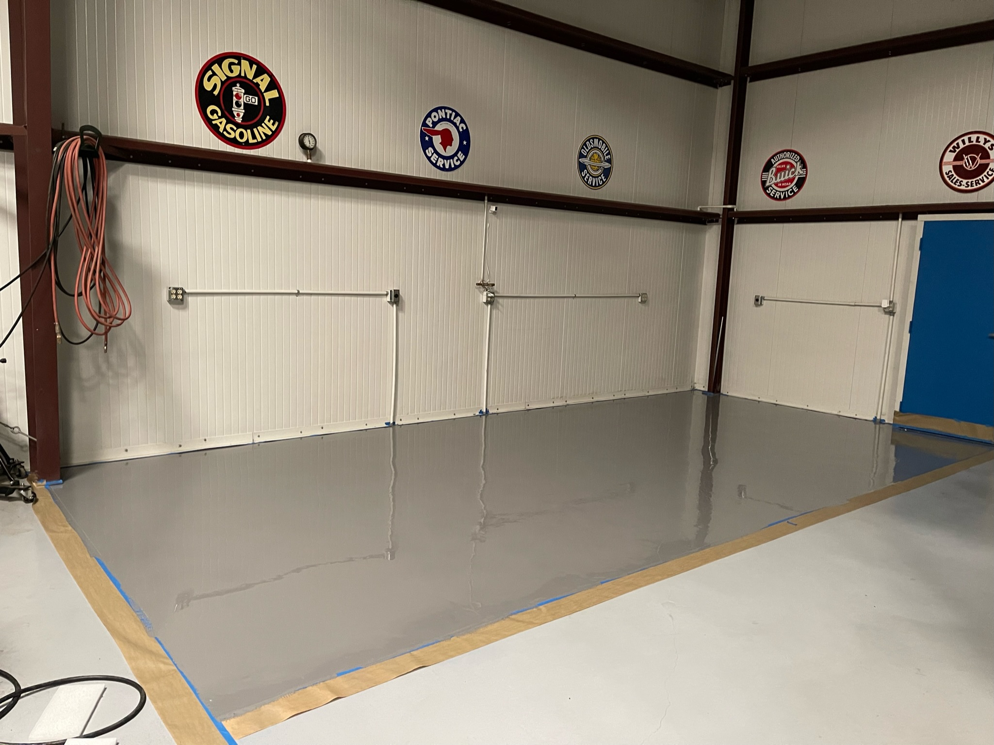

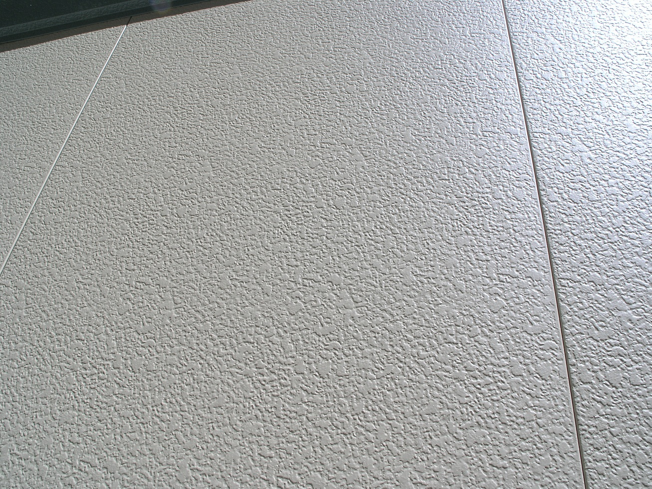

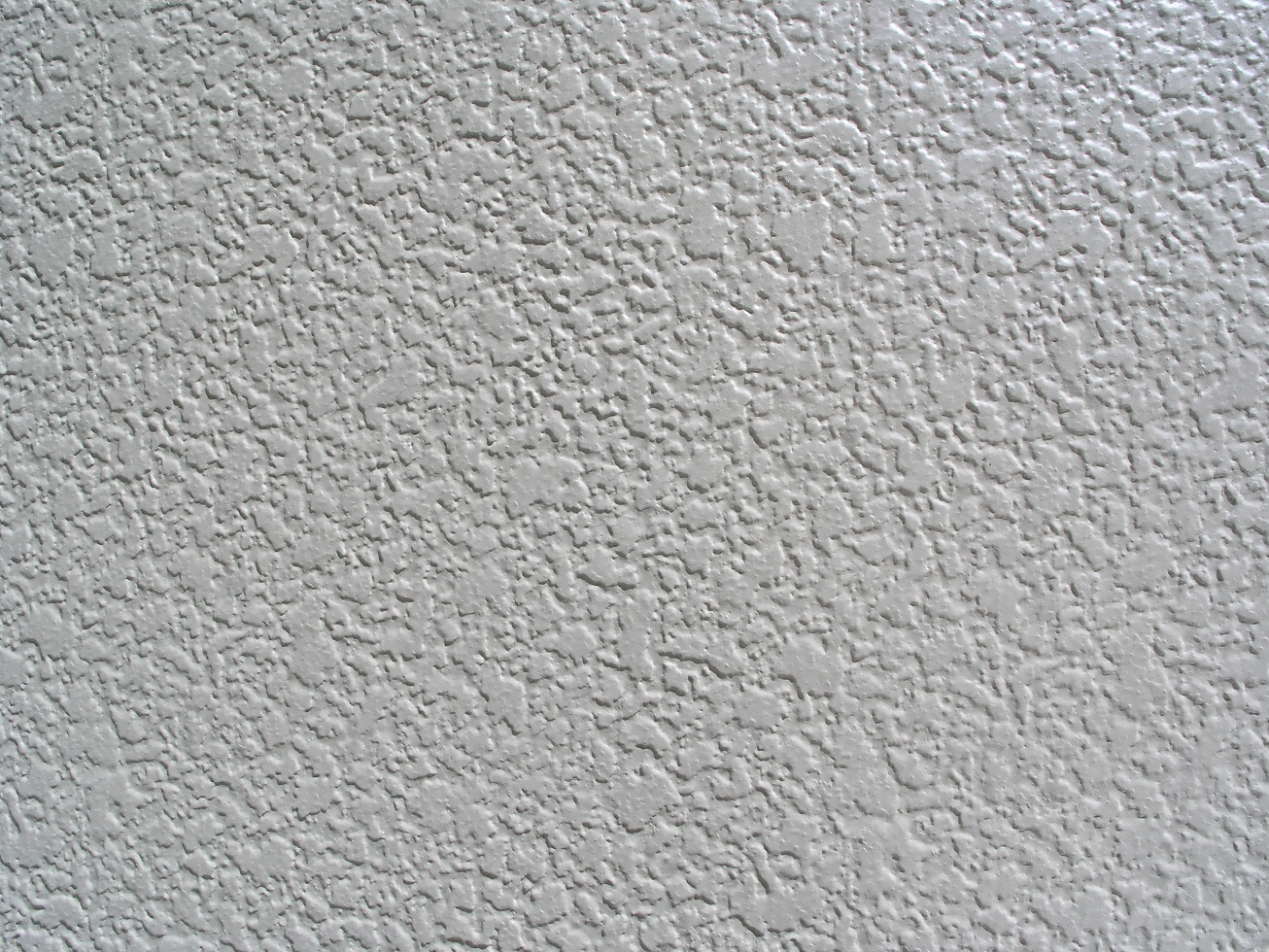

I would agree to keep them separate forall reasons mentioned by others. My first house I attached the work shop but the the floor level was two steps lower. That was my learner house and I did some of the work. Shop had a pit for under vehicl access. I learned that it was 65% labor costs and 35% materials. So I took the money from that sale after 6 years of living there and built them myself without subs. Multi year projects. The last one I started in my early 60s and did the entire project including grading and underground utilities. I subbed out the colored stucco portion because it was 45’ high and took 31 tons of mud, the sheet rock was also too much for me with some 18’+ ceilings. I did the remainder in stone. I had heard about downsizing but didn’t know why or how. One thing may interest the OP is the steel walls in the shop that he could use for residential, they go up easy and provide R-21 insulation, available in higher and lower insulation values by thickness. They are sandwiched with metal on both sides and foam filled. Different textures are available. I see some contributors on here that have seen this project before so I wont bore you with all the details and photos except for the walls. By the way my taxes are $3500 annual. Building this way confuses the assessor.
