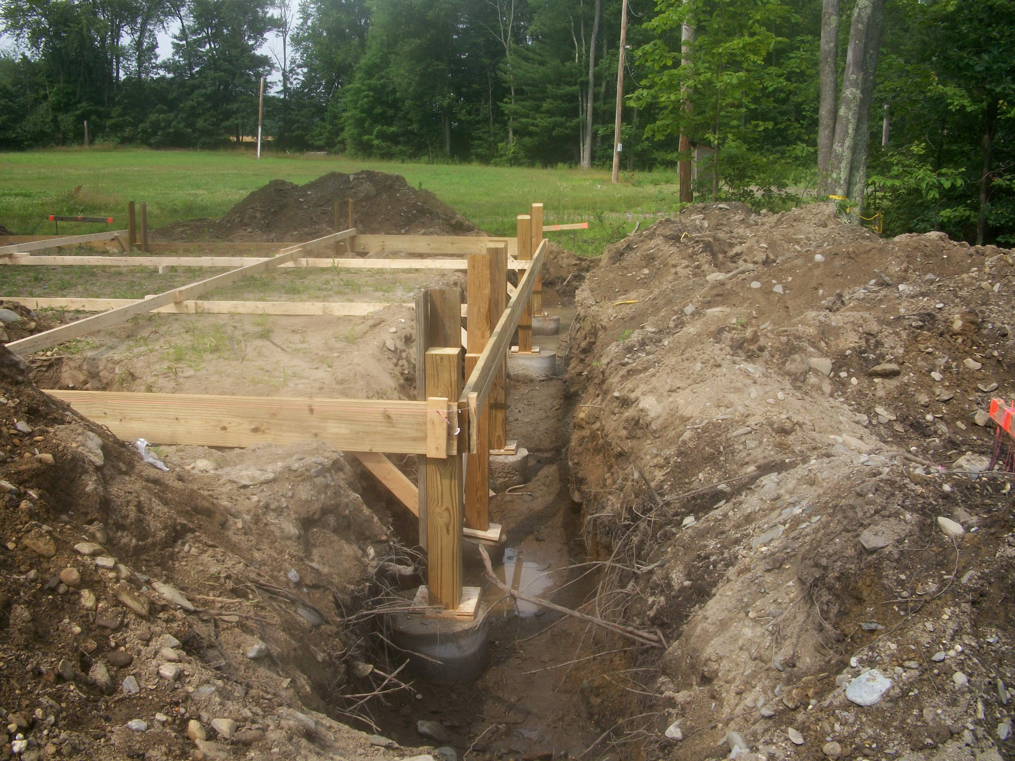

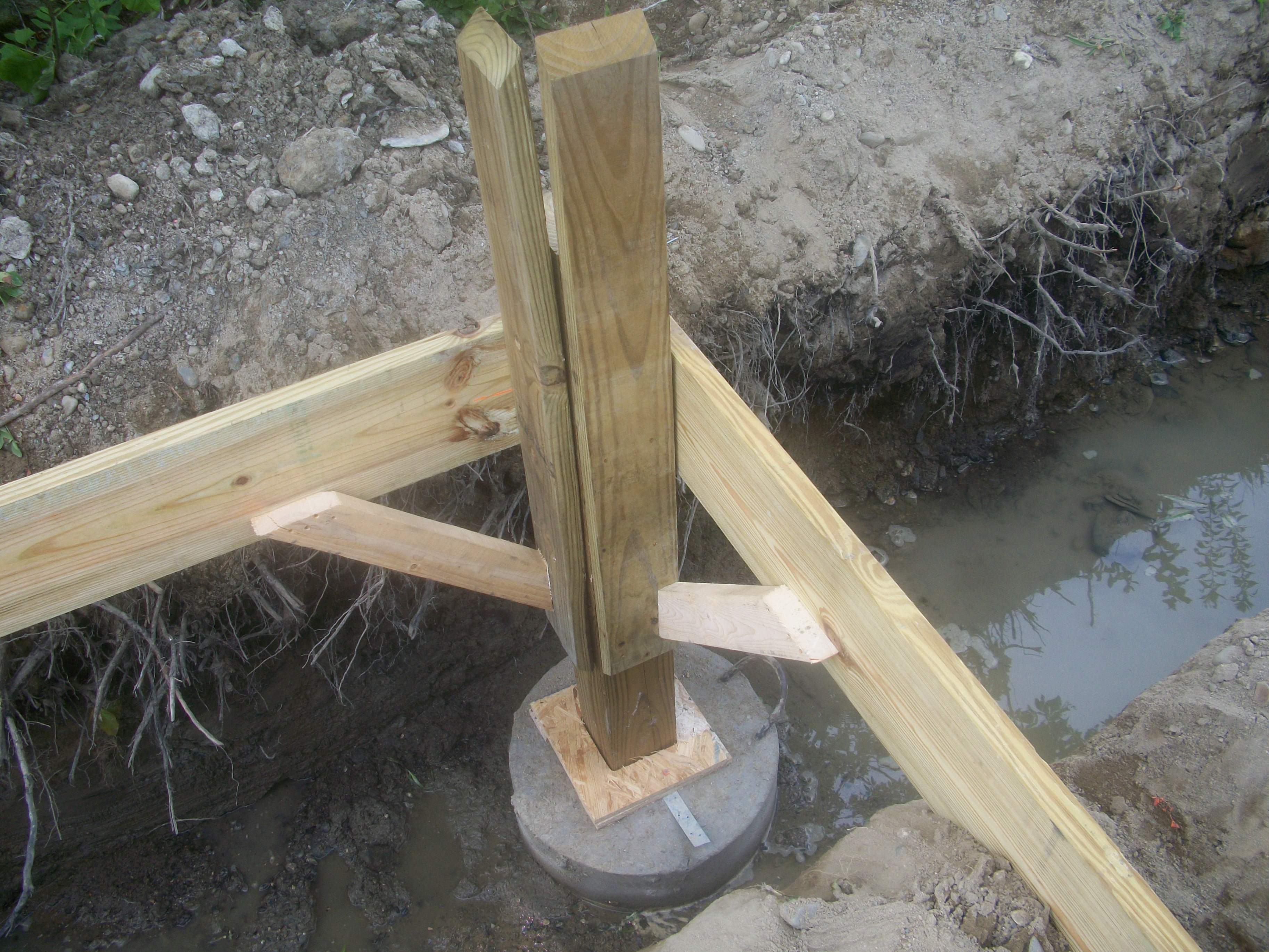

This is a variation on your method. Precast concrete footings formed using cut plastic 55's as forms. When these are poured, galvanized straps are cast in. The square OSB board that sits on the concrete is a sacrificial piece that has a hole cut in it that matches the post dimension. Then when these short posts are "squared" off, the galvanized straps are then nailed to the OSB blocks These blocks keep the posts from kicking out during backfill. These short PT posts extend a reasonable amount above grade then the non-pt posts are added supported by the "sistered" 2 x ? pieces.

I don't understand this at all. What is the beifit of pouring concrete below grade and then having a post come up the rest of the distance, but ending above grade?
The concrete is not poured. these are precast. benefit is you get approximately 700 sq. inches of bearing surface vs say 36 if you use a 6 x 6 post.

this is a cost effective alternative vs. using pine posts or PT posts that are full length.
This is a barn that was built at our fairgrounds by one of the larger barn builders in this part of New England. And this thing is SQUARE!

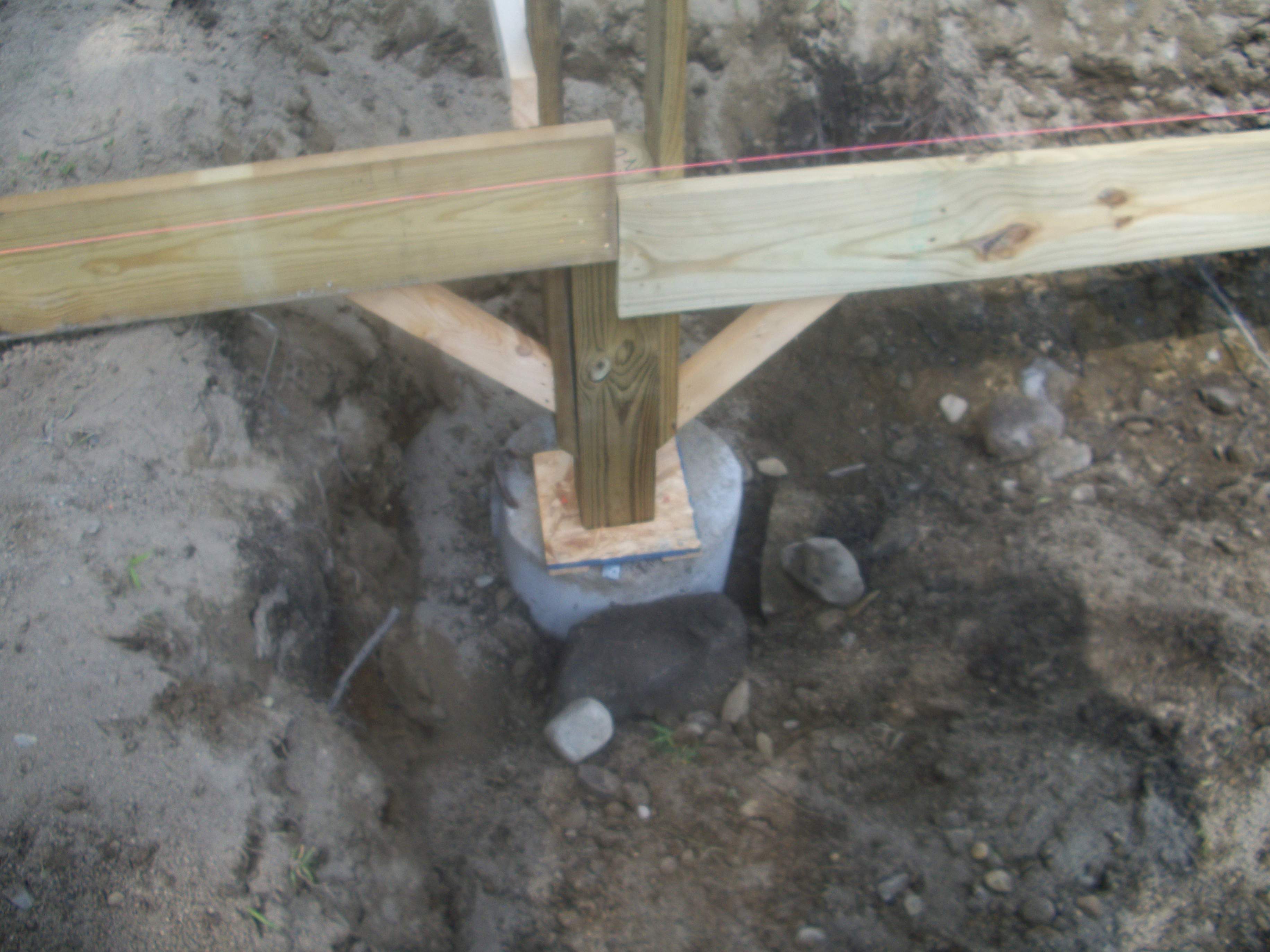

Just finished 13 piers using batter boards/string. Set string for the outside edge of my
piers. Marked and cut cardboard pier forms to length, cut forms about 1/4 inch short. Placed form on concrete footing. Filled form with about a foot of concrete. Leveled and adjusted position, filled to about half. Loosely backfilled to stabilze, topped off and screeded. Leaving the forms slightly short allowed just enough adjustment to plumb into alignment. I had similar idea and will be using a 6X6's for a base as I might need to move building in future. The piers are to provide better support by getting below my loose fill and frost line.
t. Placed PPlaced form
