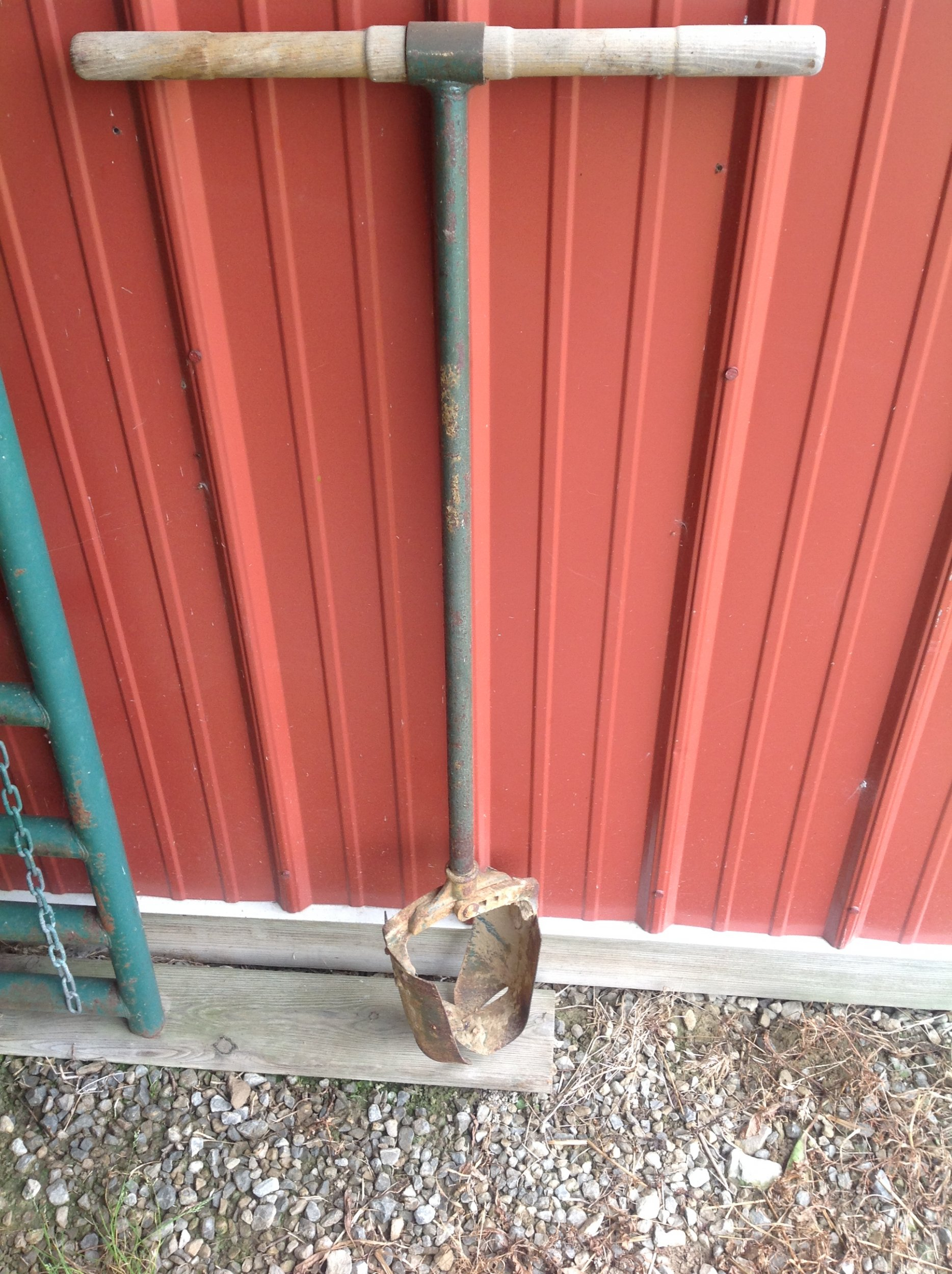

Yep i agree - should wait or dig down to undisturbed dirt. And here is the god part - you can easily dig down 7' with one of these
The handle is common pipe thread. I got a section of pipe and a coupler and made my handle about 10' long. I used it to dig down 10' for a sump pump in the barn.
Slow going, but it beats waiting 3 years! Sometimes old fashioned hand tools rule.

Only 6" diameter, so not a large enough footprint for post support.
a
I have one of those and have gone as deep as 10'. It does get to be a chore when you have to lift out 10' of iron pipe plus a load of dirt for each load. But it's doable.
