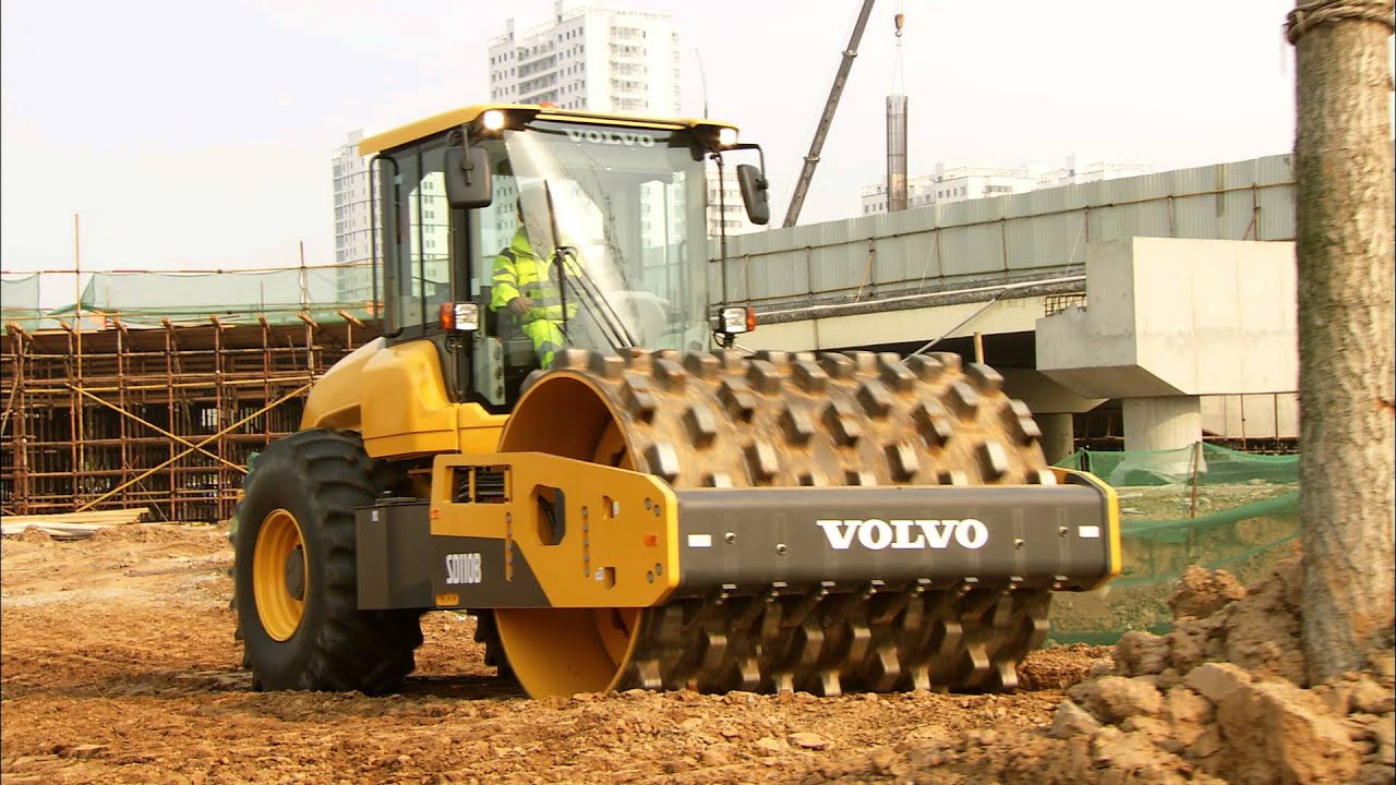

If you want to say that dirt was spread with a dozer and then people drove over that dirt, or built on it more then properly compacted soil, then I'll give you that. If you are trying to argue that a machine with it's weight spread out over a pair of tracks is capable of compacting the soil so it doesn't settle afterwards, then you are wrong.
To get maximum compaction, you have to use a vibratory roller. Sheepsfoot rollers work the best for soil, but smooth drum are used all the time for road too. You also have to have the proper amount of moisture in the soil so it will bond with itself. This is done every time you need proper compaction in order to build anything on top of it.
A dozer is a very good tool at spreading soil, and moving it short distances. It's a horrible took at compacting soil. In our lifetime, the machine that has done most of the spreading of soil is probably a dozer, but a Grader might actually have done more miles of smoothing soil if the math was ever done. I honestly don't know which has smoothed more dirt. I do know that a vibratory roller has compacted more dirt then both of those combined since neither a dozer or a grader is capable of compacting soil.

Yeah, Eddie is correct. If you have driven by or been around a construction site it might look like bulldozers are spreading soil and compacting but they are not doing the compacting part. I spent 37 years as a land surveyor on all sorts of construction sites, I also did nuclear machine density testing. The pic Eddie posted of a vibratory sheep’s foot roller is the most common tool.

Regarding compaction - compacting just with a dozer is a dream. Several posters have accurately noted the low ground pressure from a dozer, and ground pressure with or without vibration (along with proper moisture content) is what it takes to get compaction. You'll see dozers spreading material in lifts on lots of job sites but if they're building anything of consequence that dozer is going to be towing a sheepsfoot roller or being followed by a self propelled roller.
